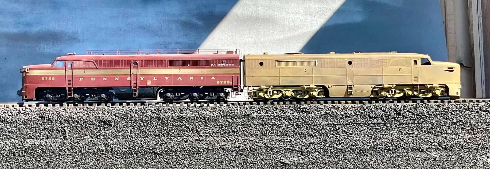

Here is the first PA - all I did was solder in a pair of .032 brass angles, pre-drilled for truck bolsters. Dennis did all of the hard work. The PRR unit is Overland, but with Lionel dummy trucks converted to 2-rail.

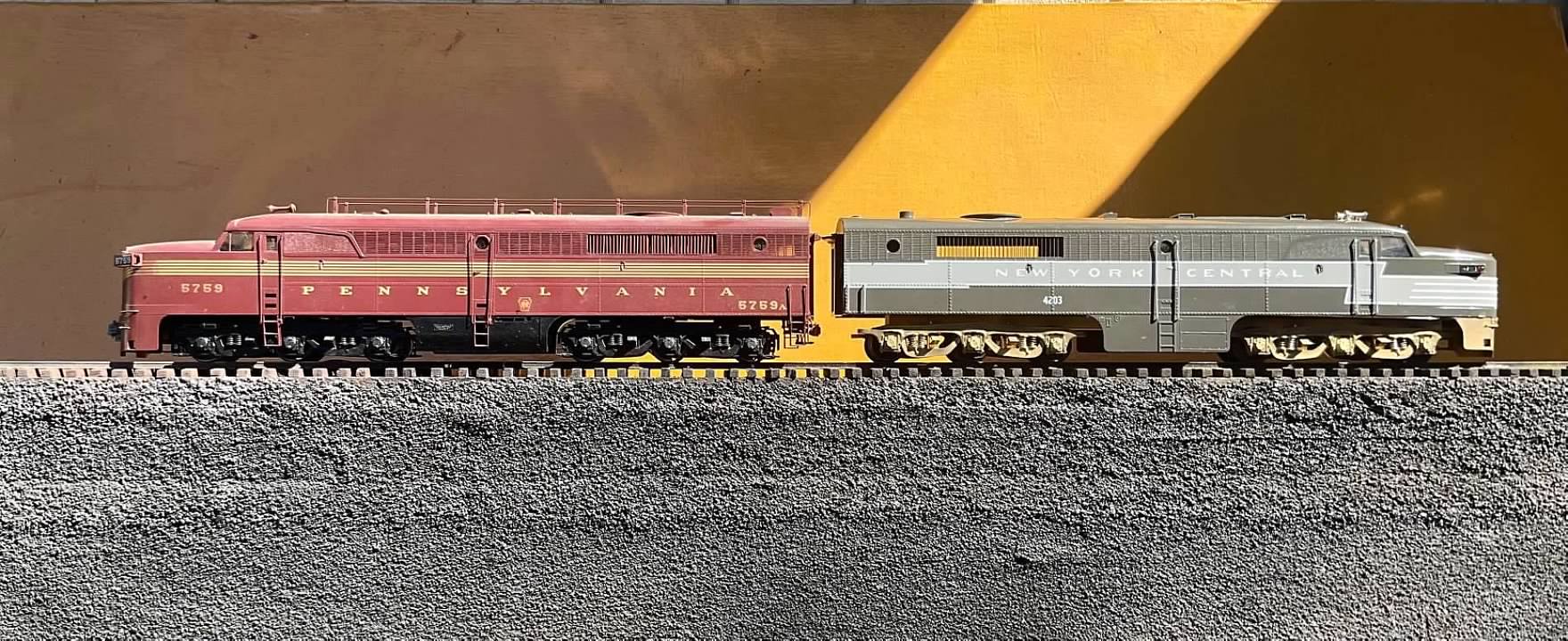

The next shot is the stock ROW model, with Dennis' superb pilot casting fastened with JB Weld. Fuel tanks need to be replaced or curved, and trucks obviously need brake parts. Other than that, and a missing windshield, this is simply not a bad model at all. I wonder if their ATSF version was plated?
Note the difference in the grillework above the rear car body - the bare model has the CLW grille; the NYC unit is as delivered. It doesn't look all that bad unless the background is all lit up like this. The big stripe on the background is why photography in the Winter is difficult for me. Too many cat enclosure structures at that Sun angle.

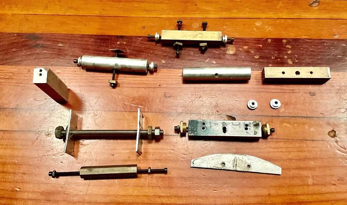

So the PA that is coming is already assembled, and it appears to be straight. If it isn't I will heat it up, and use my kit on it for soldering. But just in case it is a very long time before another casting set needs soldering, I spread my kit out for a photo. Herewith:
I was going to number a few of the parts, but they are really straightforward. The large threaded rod goes through the cab side windows. The collection of spreader bars are self-explanatory - but note the flanged washers that fit in the PA portholes. They also fit in FT or F# portholes.
All spreaders mostly have holes for long screws that go in the roof - Roofs are thick, so you needn't drill holes all the way through - just deep enough for a bottoming tap and enough threads to hold.
There is a drill template that serves to align holes in the roof with tapped holes in the nose castings.
Not shown are a collection of giant C clamps - these get used wherever necessary. I can put a flat plate on the bottom of the sides and clamp the roof. I can clamp the end, rather than screwing it in place. Lots of tricks, but as always the key is clean brass, good flux, gloves, a pencil torch on a MAPP cylinder, and maybe a few fire bricks.

Thank you for showing those bits! The set up and then holding everything just so is important to getting stuff assembled.
Re: Alco PA and FA 2023
Yeah, from a rookie solder guy, set-up and other preparation makes all the difference between a bad, good and excellent soldering job. Sometimes I ask myself, "what did I do different this time that made the job nice"......so far I chalk it up to luck, but, practice makes perfect.
