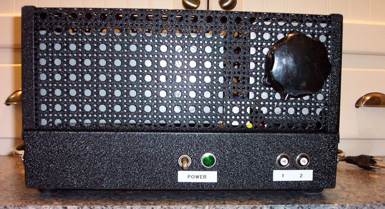

I built this years ago for our club. I used a an Acme commercial transformer and a variac for voltage control. This will provide 25 amps at 20 volts but I used a pair of TMCC lock ons which limits max current to ten amps. Acme makes many sizes of their transformers, these were salvaged from a dumpster.
This just for reference. Ignore the price, they can be found at a quarter of that plus Acme makes smaller ones.
https://www.ebay.com/itm/204389883058?_ ... BM9LiKksVk
https://www.ebay.com/itm/264357176766?_ ... R9DouZLFZA
Pete

Thank you for the hint, Pete. That is a nice looking power supply.

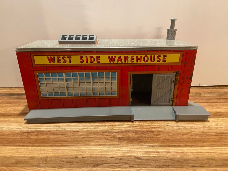

Okay, in between clean-up stints in the basement, I took occasional breaks to make a paper version of Marx's West Side Warehouse:
Butchered up the base a bit, but it seems serviceable. Made the original's plastic bits using scraps of paper, cardboard, and basswood found around the workbench. I'll likely use this halfway back on the layout, a place where the defects aren't quite so obvious.
I used the shots Ed Berg posted on his blog https://toyconnect.blogspot.com/2011/10/marx-westside-warehouse.html edited a bit using MS Paint. Not too complicated.
Back to the basement...

Postby HONDO74 » Sat Sep 28, 2024 6:45 pm
Looks like the one Marx made.

Postby healey36 » Sun Sep 29, 2024 8:32 am
Great pic, Hondo; looks like it's in really nice shape (unlike most I've ever seen). I think it was originally in Marx's The Untouchables playset...would be neat to know what else was in there. Thanks for posting that pic.

Postby HONDO74 » Sun Sep 29, 2024 12:18 pm
The other building in the play set is just a street scene tinplate front not a full building like the warehouse.
Here is a link to the play set
http://www.marxplaysets.com/Playsets/TV ... 08656.html
