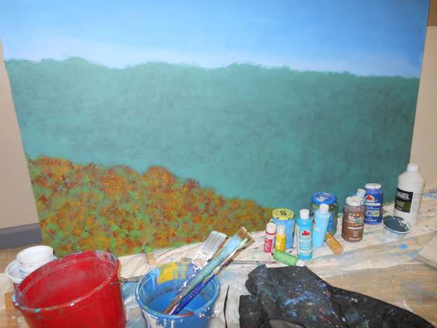

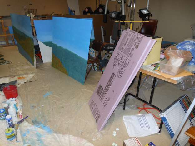

Updated 6/2/2016:
OK, enough about future plans. Here's the finished Backdrop #4. Along with Backdrops 2 and 3, it will be installed soon.
Postby rogruth » Thu Jun 02, 2016 11:08 pm
George,
Seems to me that those backdrops could be used on any layout. They look great and should be adaptable.
I feel sure you will be able to use them on your next layout.

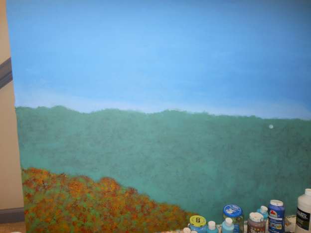

Postby G3750 » Sun Jun 05, 2016 5:18 pm

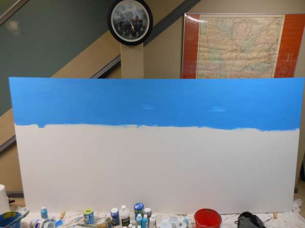

Updated 6/5/2016:
The artist visited again yesterday and painted the remaining backdrop which is designed to go on top of Backdrop #3. It's just sky. It will get another coat of paint and some darkening to match the others.
I got to Home Depot and picked up some more pink foam (1" thick) that will be used to create more support blocks for the backdrops.
We are moving along. In the next session, I hope to hang Backdrops 2 & 3.

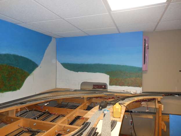

Updated 6/10/2016:
Just finished hanging Backdrop #2 and prepping for Backdrop #3.

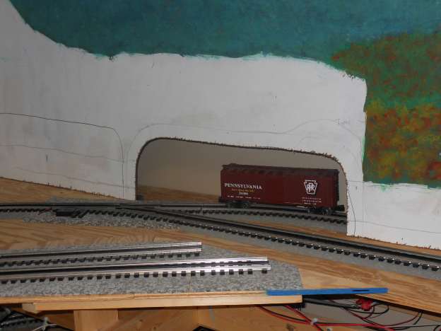

Here is Backdrop #2 installed. Note the hole for the passing siding.
All "white space", i.e. not painted, will be hidden by a styrofoam mountain.
Here's a close up of the hole in Backdrop #2 for the Hidden Passing Siding.

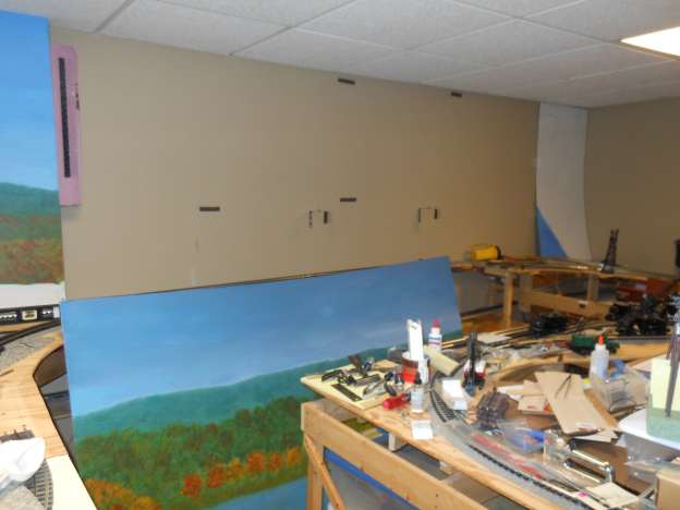

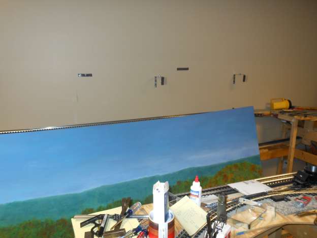

Here's a shot of Backdrop #3 on floor near its final position. Note the styrofoam backing for the backdrop.
This photo shows the brackets that will hold the backdrop 5" off the back wall.
We would have hung Backdrop #3 but we ran out of velcro.

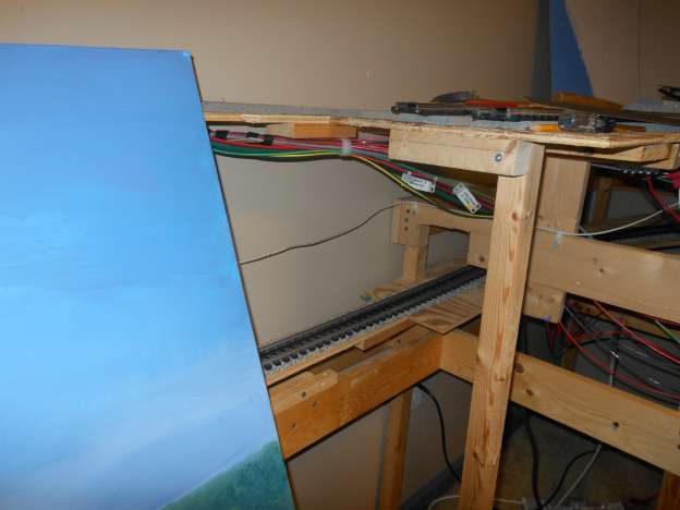

Updated 6/11/2016:
There were a number of things (activities, decisions) that I forgot to mention last night.
First, earlier in the week I did some test-fitting of Backdrop #4. I removed a part of a support for a track in the hopes that the stand-in for the backdrop would fit into the available height between the support and the ceiling. As you can see in the photo, it does not. It will need to be trimmed. I will re-install the support and then measure and cut the backdrop at the bottom.

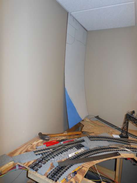

Second, because of fit and placement issues with Backdrop #3, I've decided to modify the Hidden Passing Siding, closing off the eastern entrance, and transforming it into a trailing point spur behind the backdrop. This was done because it would have been difficult to provide enough clearance for locomotives entering the siding. It is also the expedient thing to do; in a year, retirement is going to change everything. The larger goal is to get the backdrops installed, the bridge placed, and run some trains.
Clearance behind Backdrop #3 was checked for both the lead to the Hidden Staging Yard and Hidden Passing Siding (which was identified above as a problem). This photo shows the mounting cleat (just to the right of the backdrop where the ground meets the sky) installed last night. This cleat, along with another piece in front of it, will form an anchor point for the rightmost lower corner of the backdrop.
