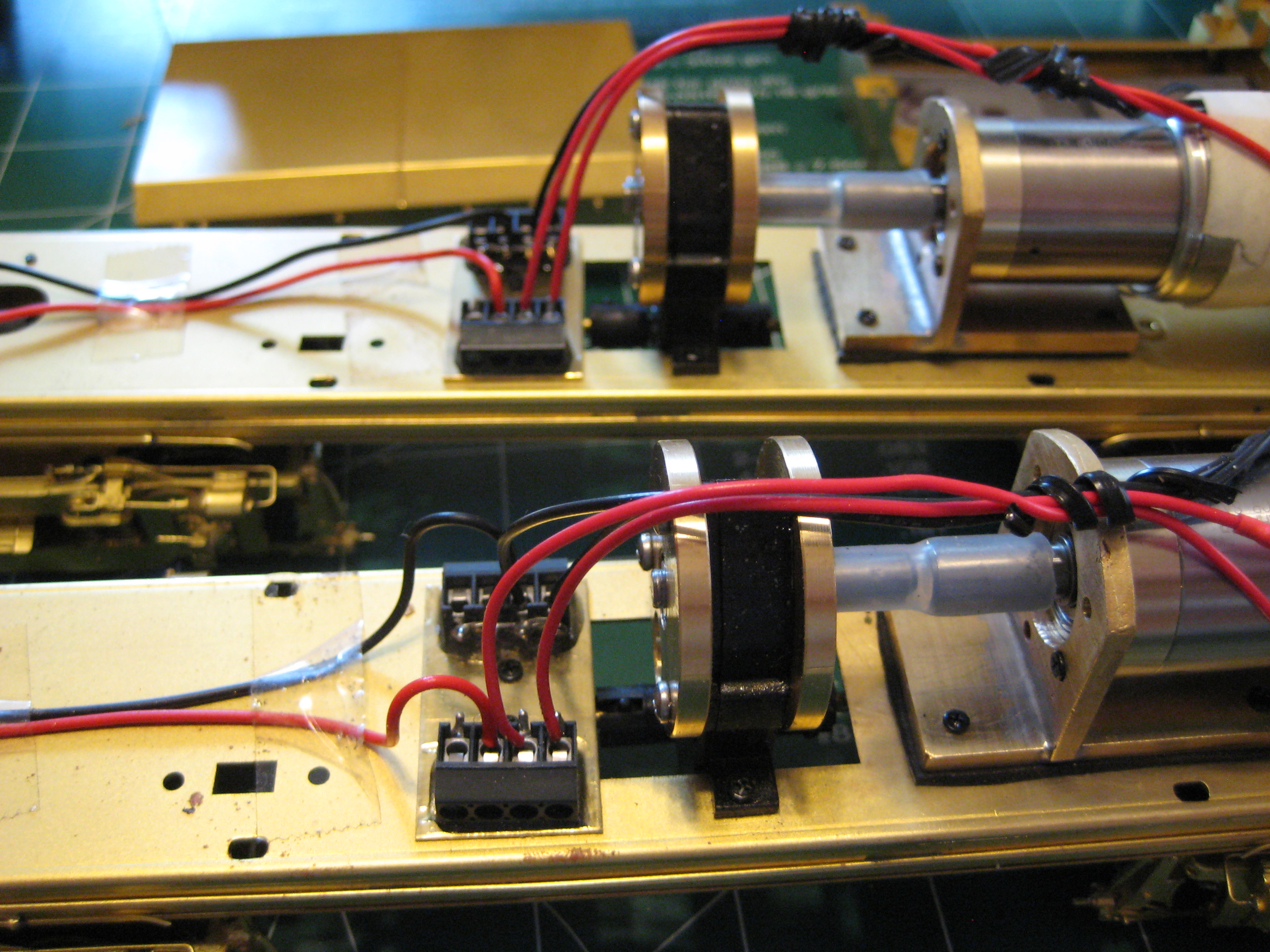

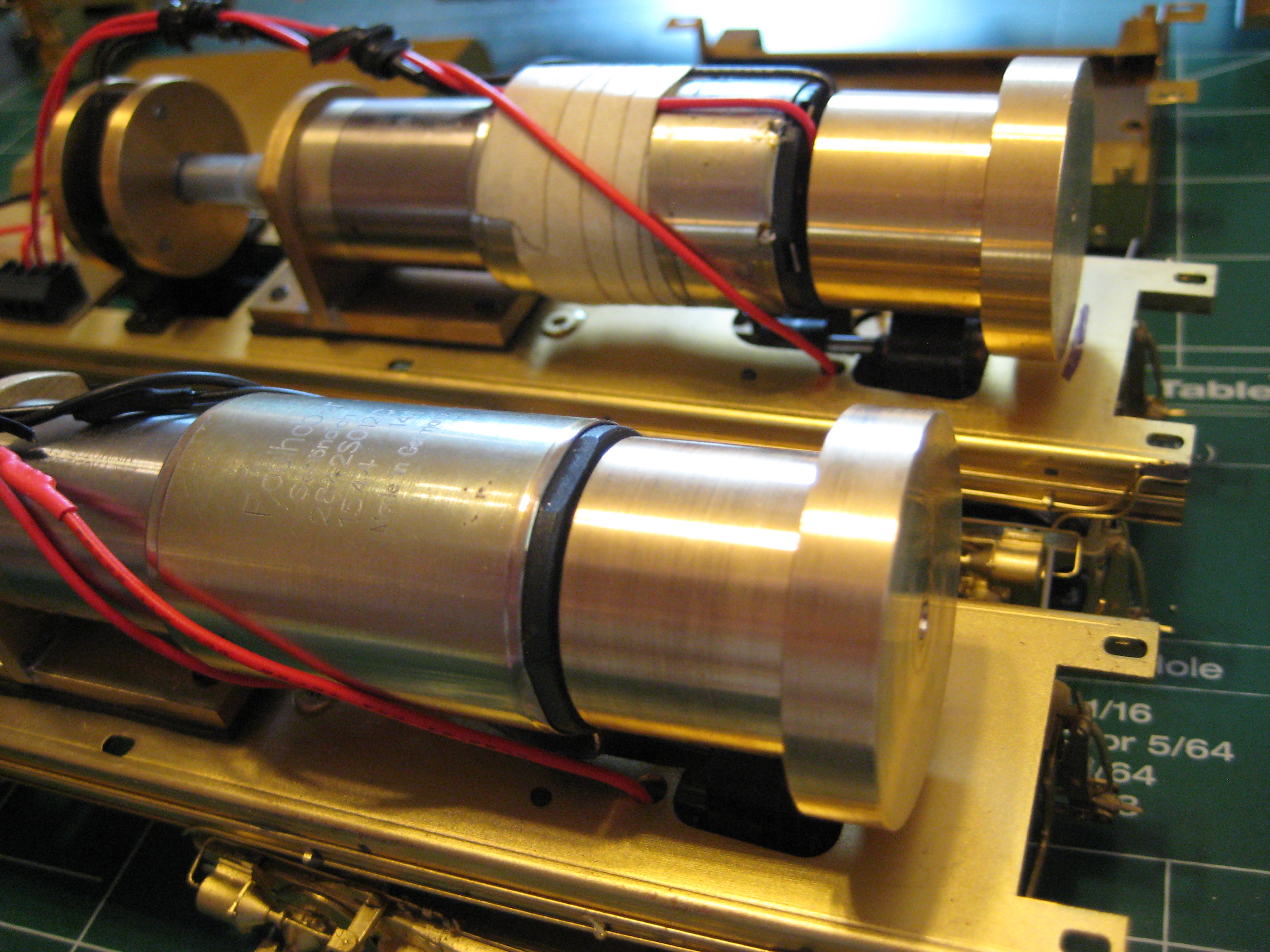

My biggest issue with Henry's diesels is the drive itself. As with all things C&LS, very well built but, the o/a ratio matches nothing else and is way too high, slow speed and starting are not good, wheel spin with the slightest load or grade. Matt spent a lot of time tweaking decoders to get decent operation. He is very good at it. He is a resource I use when dealing with decoders and he's bailed me out numerous times.
To drop the ratio and, improve the running on some RS32s (I think that's what they were), I removed the 24 volt Pittmans and replaced them with Faulhaber gear head motors. Because the customer runs straight DC and wanted a little more weight I added the biggest flywheels I could fit in the space provided. I like flywheels. Also had to create bearing carriers for the ball bearings used in the input of the tower. Because the o/a ratio is dropped the top speed is dropped but slow speed, starting, and pulling is vastly improved.
I was lucky enough to obtain about 3 dozen of the original tower castings and my plan is to come up with a simpler solution. Primary reason being the expense of the Faulhaber gear head motors. A work in semi-progress.

Re: C&LS Train Master Fan Question
Jay Criswell wrote:
I'm having problems understanding what I'm seeing, here. Is this a belt drive to an under floor shaft?
- Posts: 2003
Roy,
No, no belts. It's a stock C&LS drive except for the new gear head motor and adapters used to support the input gear used in the center tower. Originally, the gear was pressed onto the end of a Pittman motor. Yes, there are driveshafts below the frame/floor but they are high enough in the frame so you can't see them. Kinda of a tank drive that isn't.
I'm not familiar with the C&LS drive. What is the cylindrical part over the middle of the engine frame, over the hole in the floor? A central shaft appears to be connected to the gearhead shaft, by way of clear tubing.
The geared motor and drive above the frame in Jay's photos is new.
Here's a stock C&LS Pittman motor drive from an RS-11. There is a second motor shaft sticking out just under the speaker mount. FYI the speaker is a Tang Band T1-1925S that fires sound up and out the radiator exhaust grill.
