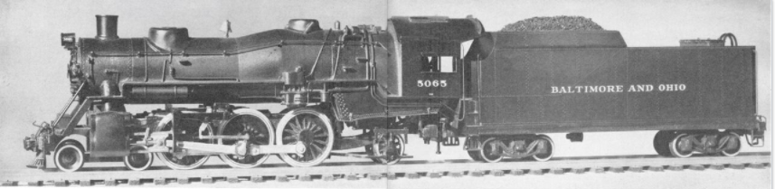

The original pre-war Lobaugh B&O Pacific had different trucks, if the catalog photo is to be believed:
Lobaugh B&O Pacific.PNG (195.32 KiB) Viewed 6097 times

I have the diagram that Joe is referring to as well:
As I understand it, the B&O released a set of drawings for many of their models as a promotion to model railroading, probably associated with the B&O portable layout in some way (if nothing more than originating in the same marketing department). The drawings can be found in a book, Scale Modeling and the B&O Railroad, published by the B&O Museum. Here is a photo of the prototype, also found in the book on the same page:
I think Joe is correct -- the boiler taper on the Lobaugh model is a bit excessive.

Postby sarge » Sun Mar 04, 2018 1:21 pm
If I was to hazard a guess, the excessive taper is to accomidate an oversized firebox to clear the motors of the day. A check of the height of the top of the box would tell if it was raised a bit for the motor (not uncommon; much like Lionel did with the cab of the scale Hudson making it look rather hideously out of proportion, for example). Then, the extra taper brings the boiler down to proper height and diameter at the courses forward.
A few minutes with a rule and a look inside would confirm that guess.

Jim - can you move those two photos together? I cannot grab them or I would do it. That way we can see how badly Lobaugh missed, and whether a better sand dome would help.
Posts: 3136
Re: Is this ugly or What?
Postby R.K. Maroon » Sun Mar 04, 2018 1:59 pm
Gladly:
P-1d Comparison.png (409.08 KiB) Viewed 5968 times
Note the consecutive numbers.

To my eye it looks more like the Lobaugh is foreshortened, I'd measure the length against the prototype, that might be the answer.

Postby rrjjf » Sun Mar 04, 2018 2:39 pm
It looks to my eyes that Lobaugh's transition in the boiler is almost twice as sharp as it should be. I like the look of the real P-1d but not the Lobaugh boiler.
