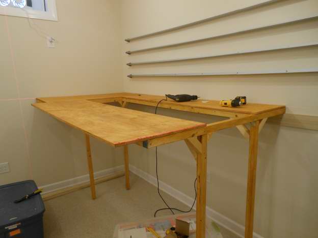

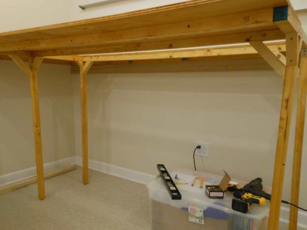

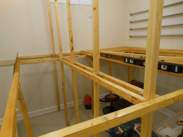

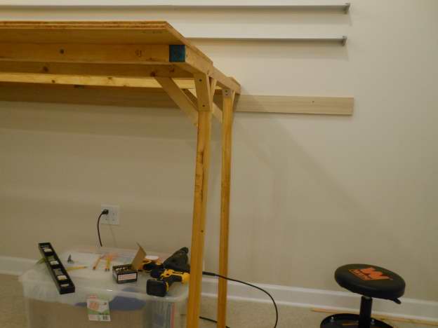

Work continued today on the first table. In these first two photos, I attached a straight 10' poplar board to the wall on the studs. It is level and up against the bottom of the table.
I then screwed the table top to the poplar board with 3" drywall screws. Checking the table against the laser shows that we have a pretty level platform.
So far,so good.

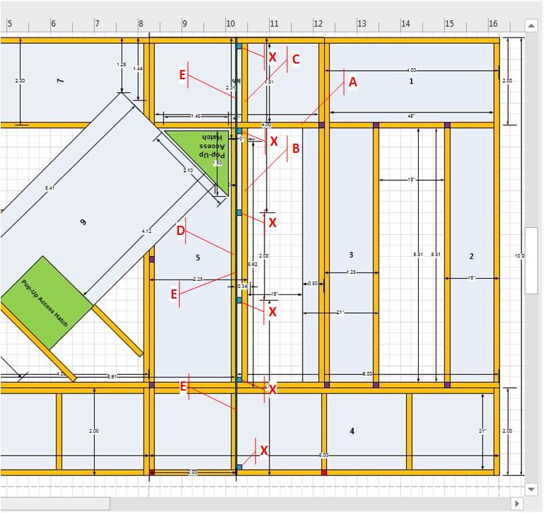

The second table is a bit tricky. That’s not because of its construction (it is very similar to the first), but because of the sequence that must be followed. If you look at the plan below, you’ll see the steps involved:
Tables 1 & 2.jpg (88.5 KiB) Viewed 2330 times
Step 1: Construct the outer 4’ x 8’ frame.
Step 2: Add the cross-member (“A”) and the south-easternmost internal rib (Identified as “B”).
Step 3: Add the northernmost internal rib (“C”). Because of B’s placement, we have to attach this one to the frame with a corner brace.
Step 4: Flip the table onto its back and attach the legs.
Step 5: Flip the table onto its legs and check the hole alignment with the previous table. These holes are for the carriage bolts that will be used to attach this table to the first one. The remaining holes are for electrical track power buses and switch power / switch buses. I'm going to have to do some aligning.

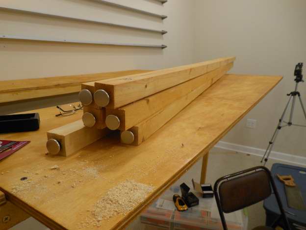

Step 6: Here' s the tricky part. We need to get 4 tall (102”) 2x2’s upright and mounted against rib B (installed in Step 2). These will support the ¼” Masonite boards that carry the steel mill backdrop. Another tall 2x2 will be mounted close to the back wall; the sixth tall 2x2 will be installed in the table closest to the aisle. These are all marked as “X” on the plan. They are lying on another table in the photo below.
More a bit later.

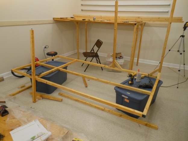

Posts: 4344
Postby G3750 » Fri Jun 01, 2018 6:45 pm
Updated 6/1/2018:

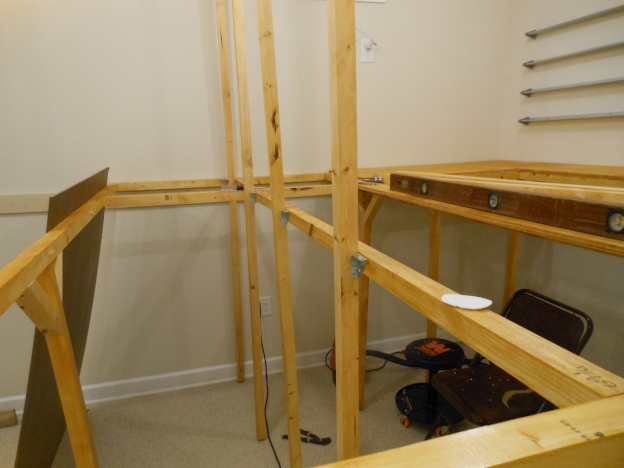

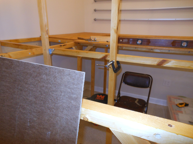

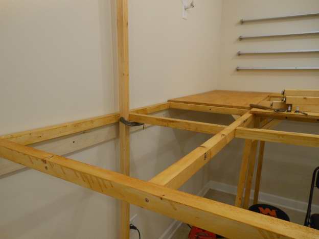

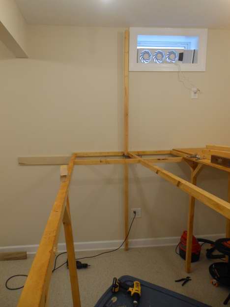

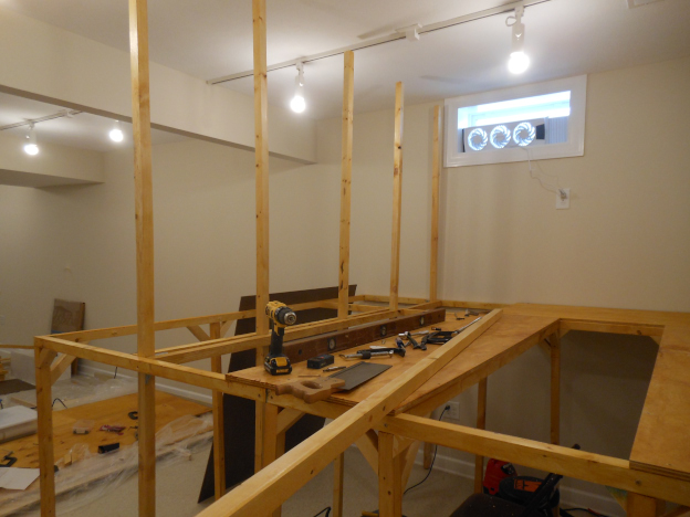

We're still at Step 6 (the tricky part). Here is the first upright for the divider. It's clamped in place.
Here's a slightly closer look at the first upright. It was more important that it be vertically straight for the backdrop than anything else.
Here's the second upright.

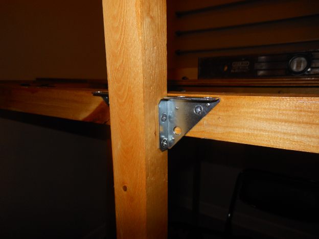

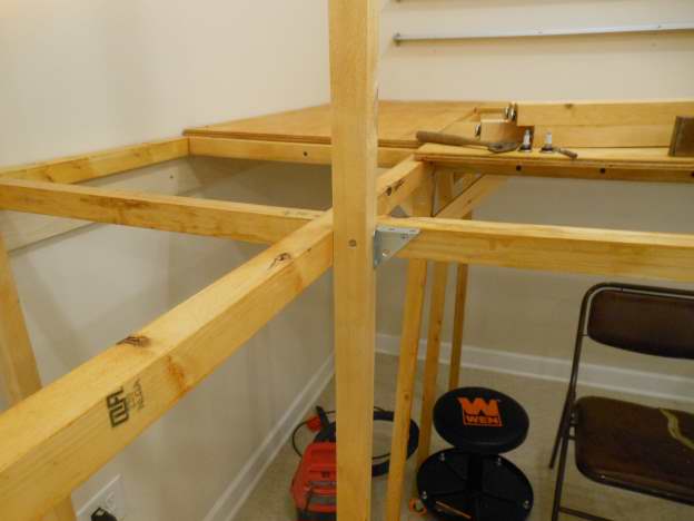

I used a long screw and a corner reinforcement to make sure the second upright stayed in place.
I also remembered that I have to bolt the two tables together and create holes for wiring runs.
Q: How do you know you’re making progress converting a pile of lumber into a layout?
A: You start hitting your head on the bench work above. :lol:

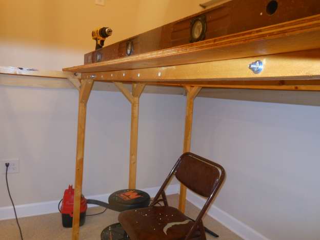

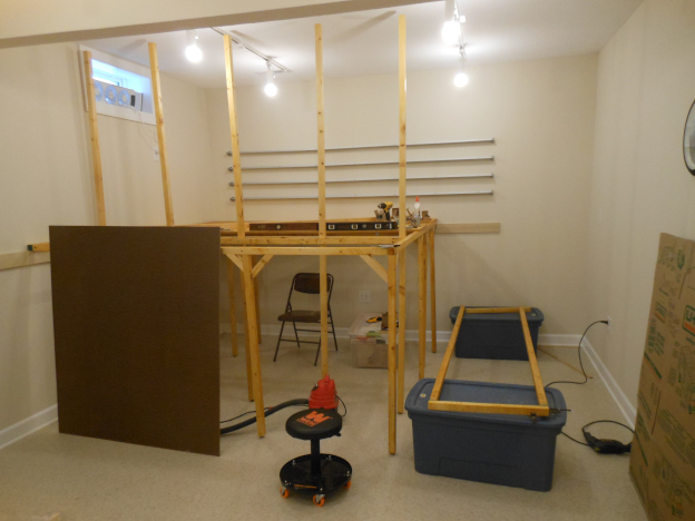

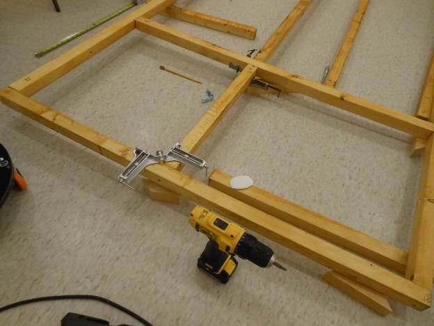

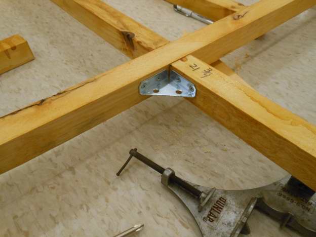

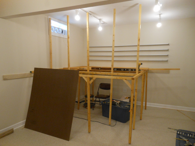

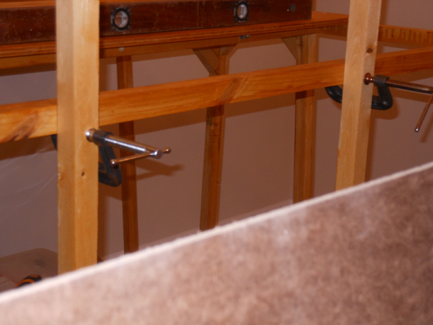

The progress on the backdrop divider continues! The next few photos show the installation of 5 of the 6 vertical supports. That's a piece of masonite backdrop support in the left foreground.
To get the 3 pieces of masonite to fit, I had to be very careful with the placement of the vertical supports. Masonite widths (from wall to aisle) are 4', 2', and 4' for a total length of 10'. The vertical 2x2's must support the points where the masonite pieces abut.
In this tight space, corner braces were the right choice.
Here we've got 5 vertical supports in place.

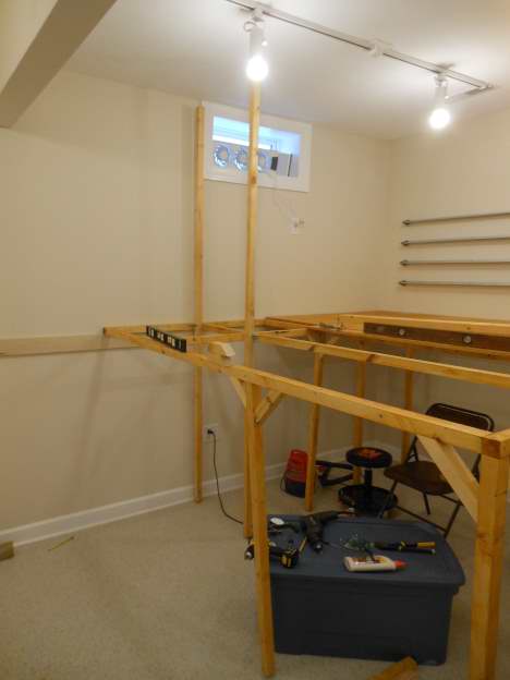

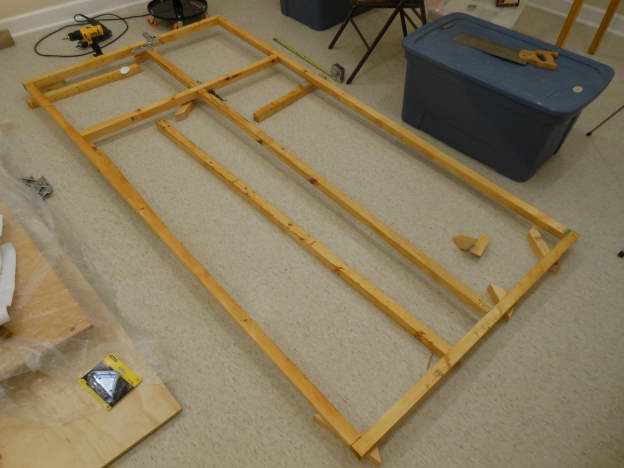

Here's a photo from behind the backdrop. I wedged myself into the corner (behind me) to get it.
The framework for the next table is propped up on the blue bins awaiting assembly.

Is that your radon-evacuator on the window above?
No, that is a window fan I bought and installed for venting the basement. In my last house, the basement would get very close with 10-20 people in it. My thought is to have a way to exhaust any accumulated train smoke and maybe get colder outside air into the basement. Don't know if it will have the desired effect.
