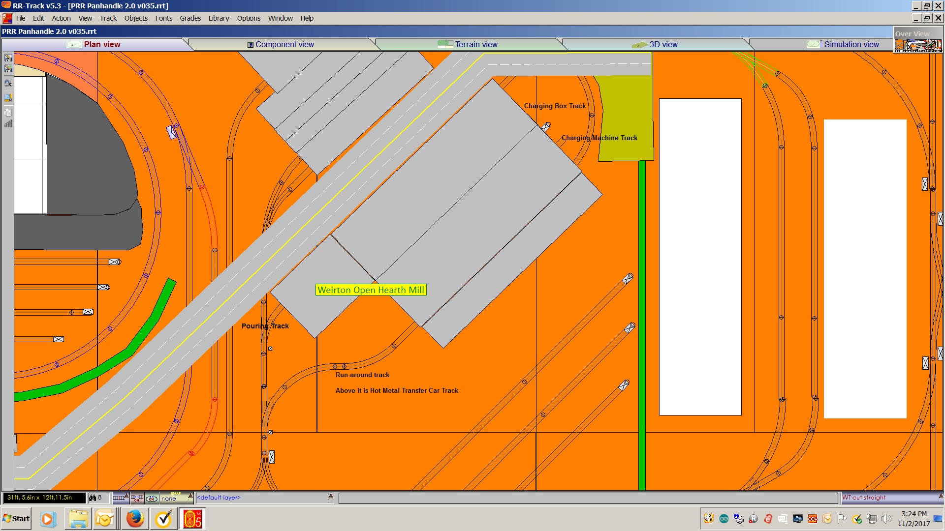

Postby G3750 » Thu Nov 02, 2017 3:31 pm
Latest Open Hearth track geometry.
Open Hearth Track Layout.jpg (460.98 KiB) Viewed 3344 times
From the front of the mill (left to right):
  • Pouring track
  • Charging box track (at rear of mill)
  • Charging machine (wide) track (also at rear of mill)
  • Run-around track (at ground level)
  • Hot metal transfer track (directly above it and charging floor). I don't have enough real estate to up to this level and keep the run-around.
The three spurs to the right are for the blast furnace.

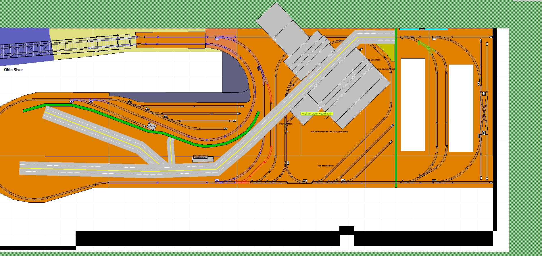

  • Over the past 6 days, in between Thanksgiving and kid visits, I determined the correct dimensions of ladles and bridge cranes for the Open Hearth. That led to yet another recalculation of building height and proportion values. The Charging side of the Open Hearth is elevated; fitting the crane's height and the ladle size into the smaller bay didn't work as planned. As a result, the height of building needed to be increased. Even with more height, it turned out that the plan to put the Run-Around Track through the Open Hearth was unworkable. I have re-routed the Run-Around Track to outside the building (part of the Blast Furnace complex).
  • Here's the original plan.
    Open Hearth Track Layout.jpg (460.98 KiB) Viewed 3237 times
  • Here's the new plan, which eliminates 1 switch.
    PRR Panhandle 2.0 v036-Right.jpg (553.52 KiB) Viewed 3237 times
