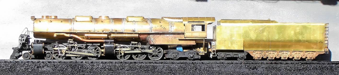

Just putting the finishing touches on a rear engine for a new Jabelmann Challenger. Looking for a front frame casting and cylinder block. Not a big deal; I can make both. Just thinking about authenticity. I got a bunch of spare parts from Bob Stevenson, and they really look good - crossheads, guides, rods, eccentrics - I may have more Challengers than any kid on the block.

Nobody? I used the last of the black Scale Coat that Jay C sent me a couple years ago. The old airbrush is spitting and snorting - time for a new one! But then I would need readily available paint, and so far all I know of is the True Color stuff at eight bucks an ounce plus ten bucks shipping. I guess that is a bargain in 2025, but I am living in 1974.
Tonight I am assembling the boiler on to the mechanism - trying not to uncouple the front engine, yet get everything set up without too much scratched paint. I am after Gersh for UP decals and a chosen road number. Photos next week.

Agree. From page 1 of this thread:
Note that those are your decals. Mostly Lobaugh, but wood block tender, and dual motor independent drive to the engines.
