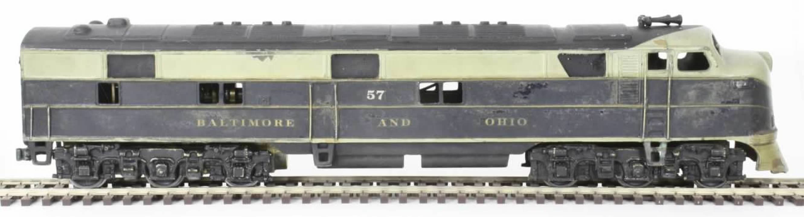

Well, let's do the EMD E7s again. All the photos I posted years ago except the GM&O are gone. Here is one of Maroon's E7s:
Check out the windshield post just ahead of the wing window.

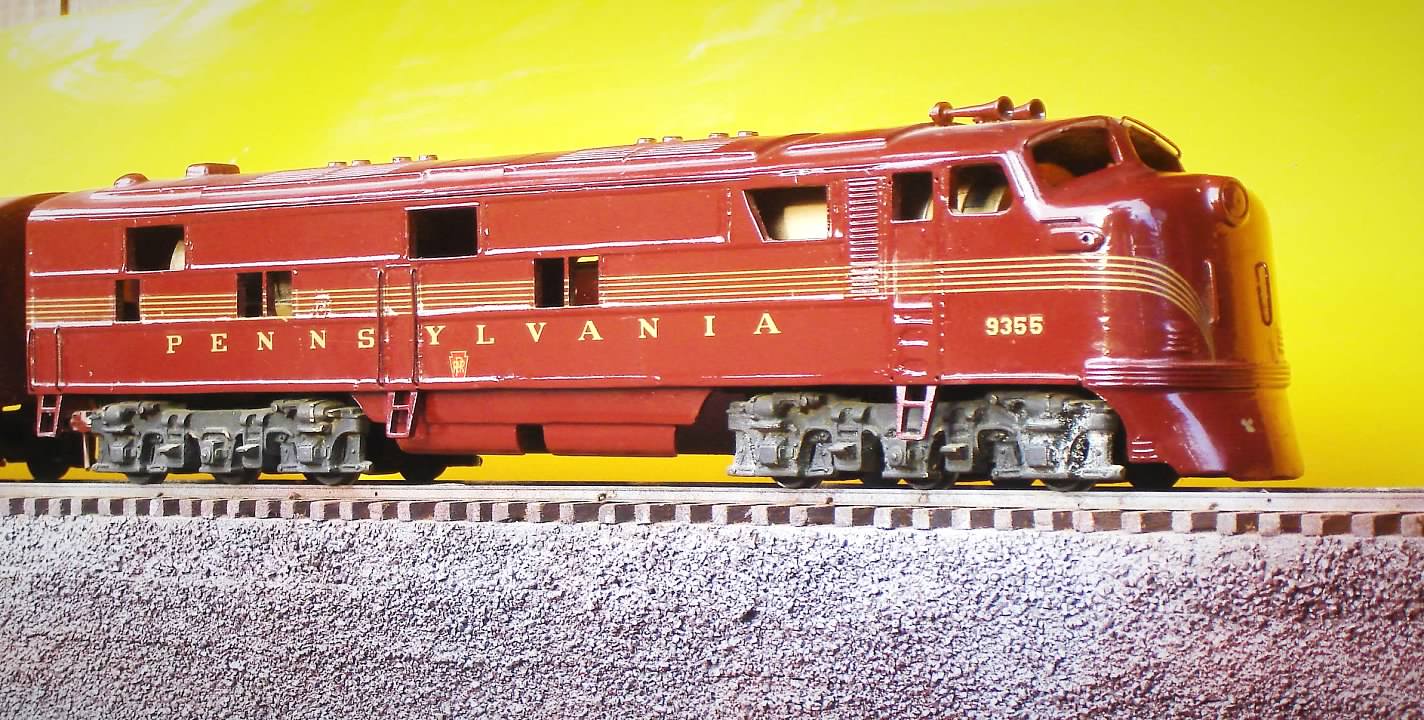

We think this one is Exacta - bronze, with a matching aluminum B. Note the bats - they are close to the "Train of Tomorrow" display model.

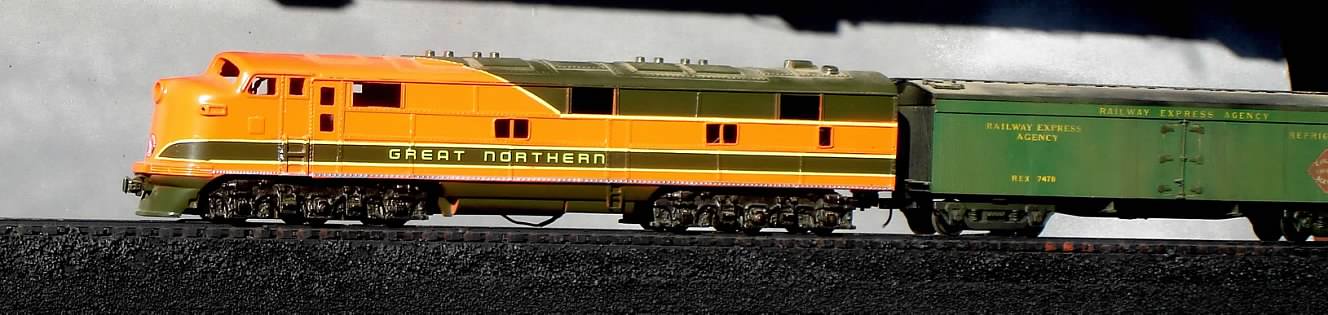

- Posts: 13637
Re: Adams EMC E unit castings
This one is a combination of an F nose and an E roof, with homemade sides. Near as we can figure, most of the Adams casting sets did not have cast sides, just slabs of brass with punched out vents and windows.
