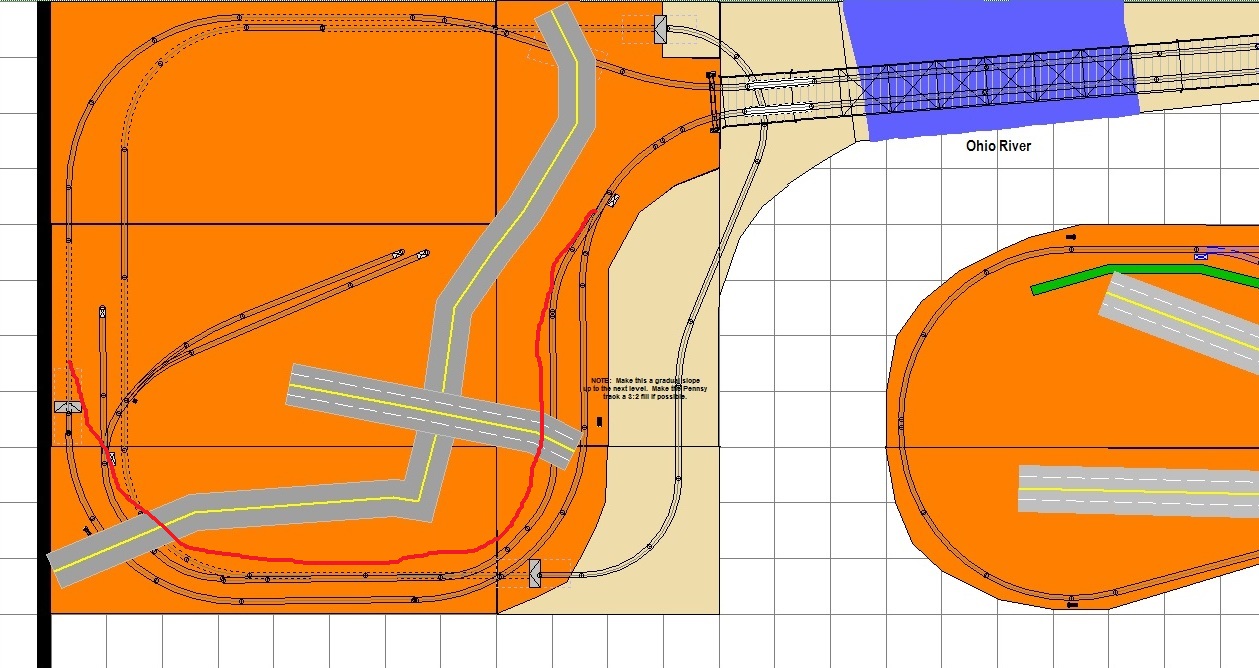

However, after taking those photos of Steubenville from atop McKims Ridge, I am thinking about changing it up. See figure below.
Steubenville Urban Planning3.jpg (224.07 KiB) Viewed 4505 times
I will keep the mountain in the left rear corner of the layout, but I'm thinking about changing:
  • The sidings. There was a large paper box(?) factory along the river. I am going to flip the siding with the mainline and place the mainline inland. The new mainline is shown in RED.

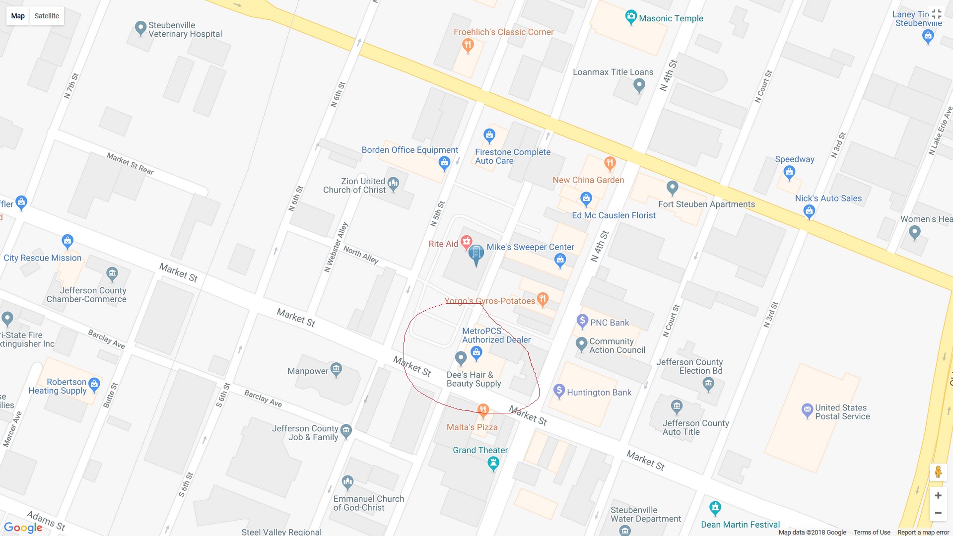

  • The coal mine. I'm thinking of eliminating the mine and its spurs and going for a more urban look. Steubenville has a lot of interesting architectural features. I'm thinking about including The Hub department store on 4th and Commercial streets. This photo appears to have been taken near the intersection of Market & 7th Street. You can see the railroad crossing, as well as the Grand Theatre and The Hub on the left side of Market.

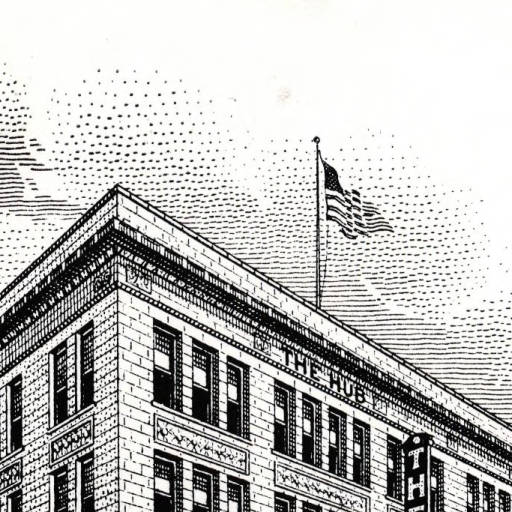

    The Hub Department Store - drawing.jpg (76.02 KiB) Viewed 4505 times

  • With the mainline changed, I can create a seedier part of town in the southwest corner of the layout.
So while I work on benchwork today, I am giving some thought (and research effort) towards the appearance of Steubenville.

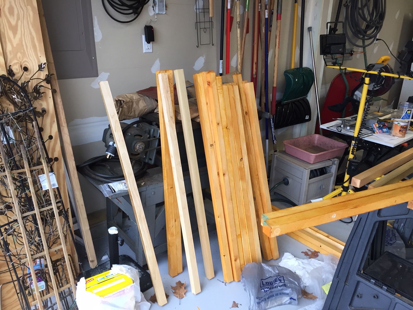

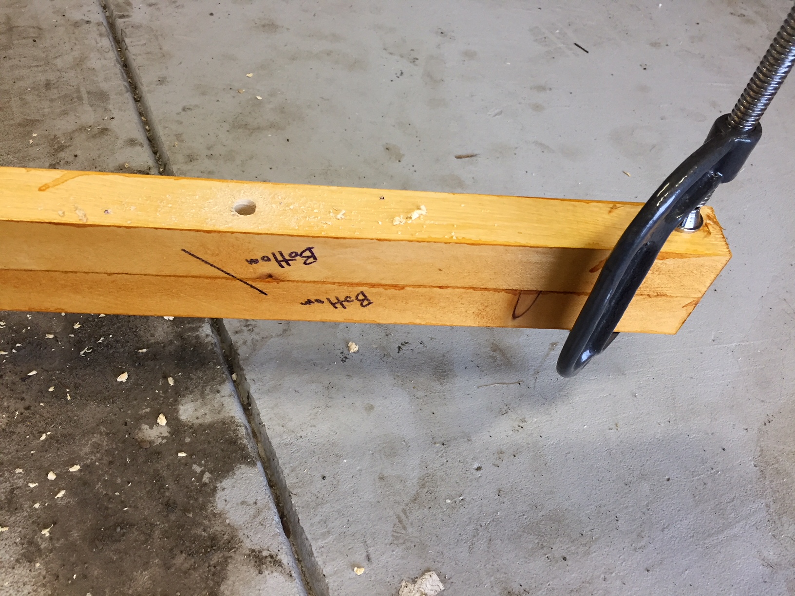

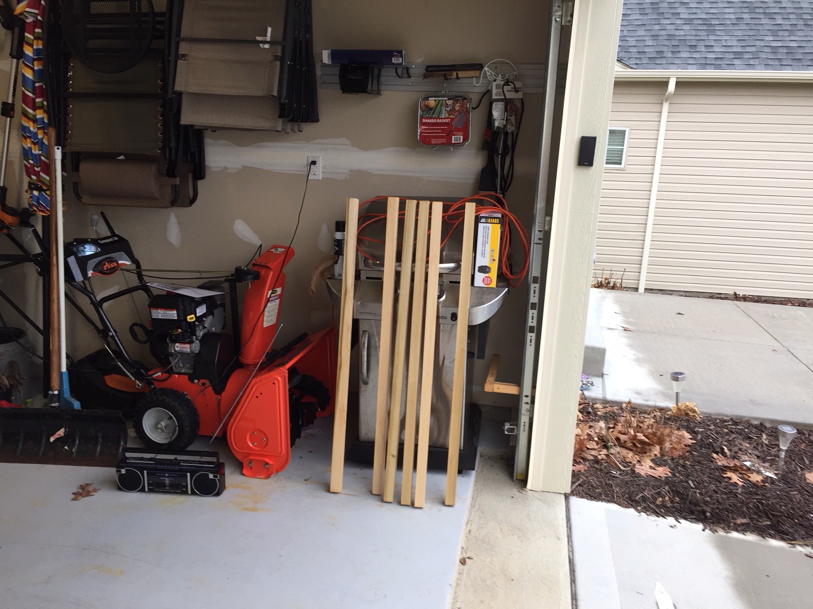

Postby G3750 » Wed Feb 21, 2018 6:12 pm
Updated 2/21/2018:
I managed to take advantage of today's good weather and make some progress on the Staging Area's bench work.

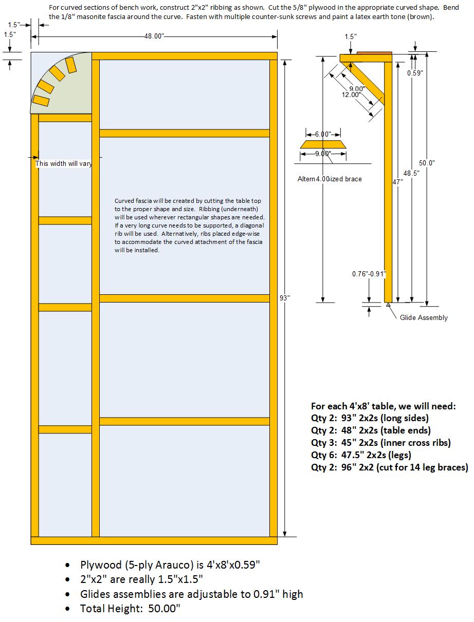

This is the plan for benchwork tables.
Table7-Page 2.jpg (125.95 KiB) Viewed 4495 times

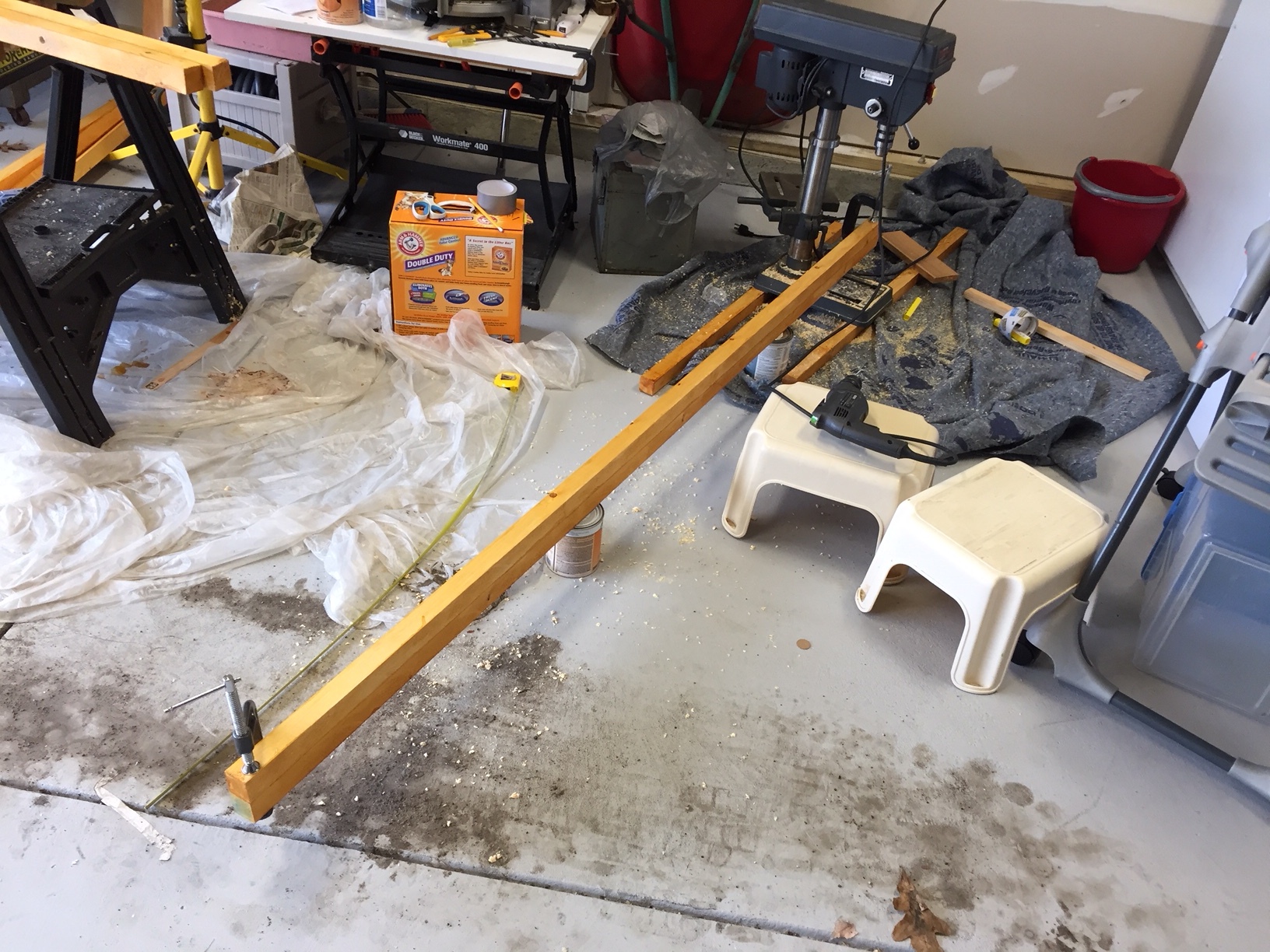

Originally, I planned to drill holes in sides and end ribs for both wiring and for bolting tables together. The plan was to clamp the adjacent sides (or ends) together and drill aligned holes through both pieces. I thought my Sears bench top drill press would be the perfect tool for this work. I was wrong. Whether it was me or the depth of holes or the depth of drill bit needed, it just didn't work. I couldn't adjust the thing to do the job. I ended up clamping pieces together an using a hand drill. I also decided that I would only drill holes for bolting tables together. Wiring will be carried by zip ties with screw holes.

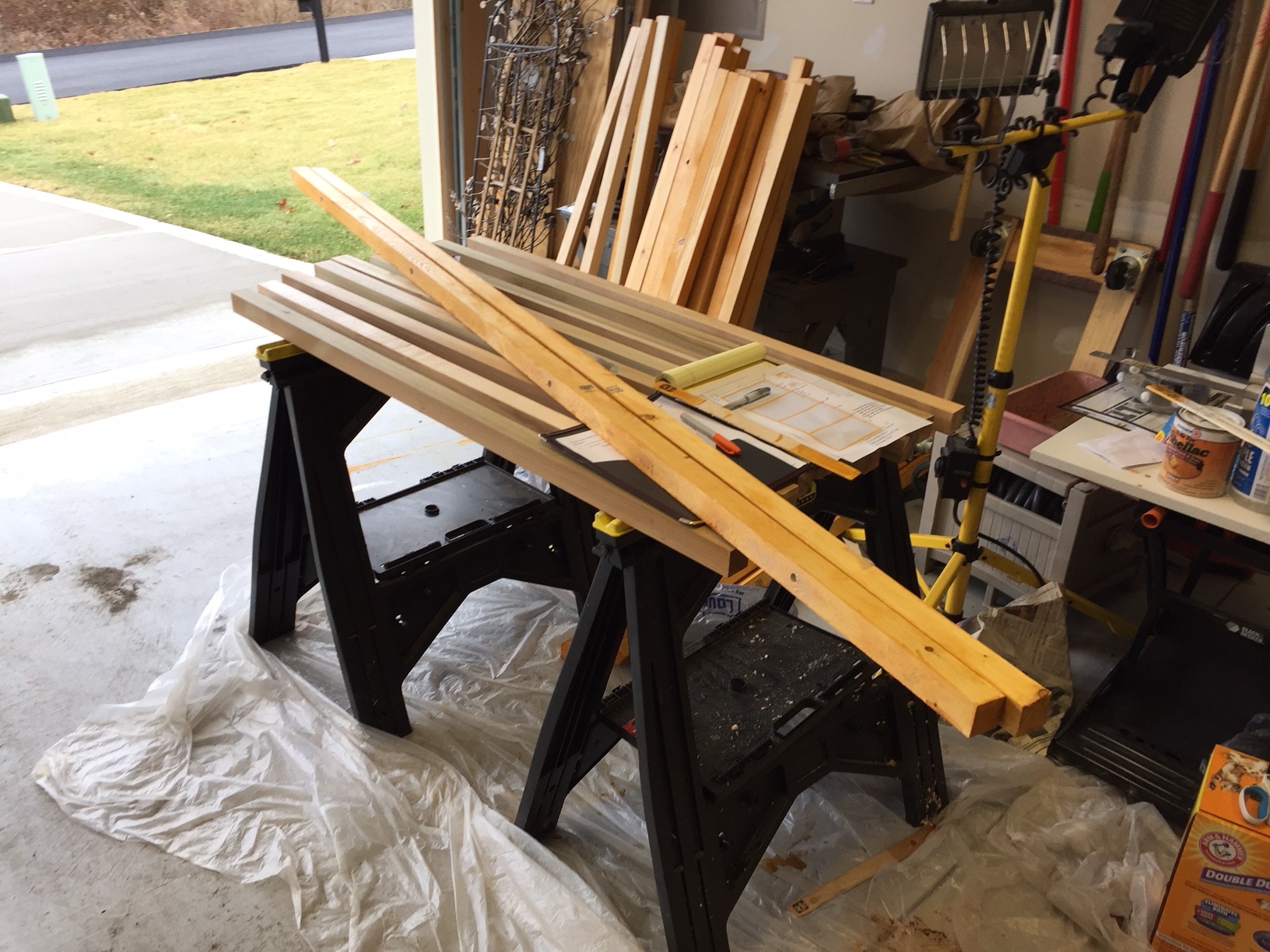

Stained wood. These are some of the "nice" legs that will go on the perimeter of the layout (facing visitors).
Varnished wood - long side pieces.
Some stained and many more varnished legs.
Two sides that I already drilled. They are sitting on some finished (stained) legs.
In the foreground is my set up for drilling holes. In the background is my useless (for this purpose) drill press.

Squares are 1'x1'? This makes the downtown area about 11'x12'? Are the tracks all on "street" level or are some "underground" like Chicago/NY or are some hidden behind flats?
Can you scale the dept store down in terms of footprint while retaining the height?
Can you cheat the actual auditorium of the theater into the back ground while making the lobby the main focus? The last of the original "big" theaters in Ann Arbor is arranged with the main auditorium running parallel to the street and the lobby/entrance are perpendicular to the street. There is a two story row of shops/apartments that are between the theater and the street.
