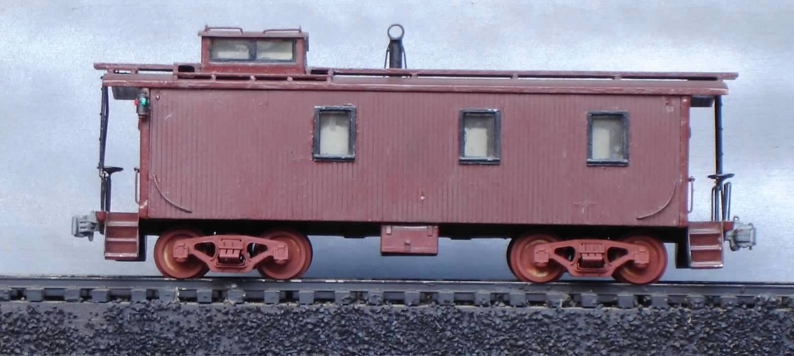

Hmmm, terrific examples of wood-sided cabooses. The workmanship is remarkable.
When we cleaned off The Old Man's workbench, we found this partially completed Ambroid kit (O-10 NKP Wood-Sided Caboose) in his stash. It's been sitting here now for some 25 years, waiting for someone to finish it:
Not sure how one might glaze the windows after painting, or indeed if the windows are even complete. Still lots of bits in the box, though.
Purchased from Gilbert's in Gettysburg probably 40 years ago (at least), for the princely sum of $12.00.

Re: Caboose Projects
healey36 wrote:
Not sure how one might glaze the windows after painting...
Usually the roof or floor is left removable, or those window castings are not put in place until they are painted separately and glazed.
Maybe you can pry them out - glue might be dried up enough to permit that w/o damaging parts.
That's a good idea; he had attached the steps, but those fell off a few years ago.
I know Sarge has mentioned a technique using PVA to make window glazing, but I've only tried it on a small repair of a 1/72-scale model airplane canopy. This would be much larger.
Micro-scale has a glazing formula you use the same way as either PVA or canopy cement, basically stretching a bubble across with the stuff on a brush. You have to cover the brush and span the width of the opening as you pull it across. Let it dry, then hit with clear gloss lacquer to toughen it up.
healey36 wrote:That's a good idea; he had attached the steps, but those fell off a few years ago.
Good sign that - glue is probably dried out and the window castings will probably pop out with a little persuasion. Paint them separately, glaze, and reinstall once the car body has been painted.
