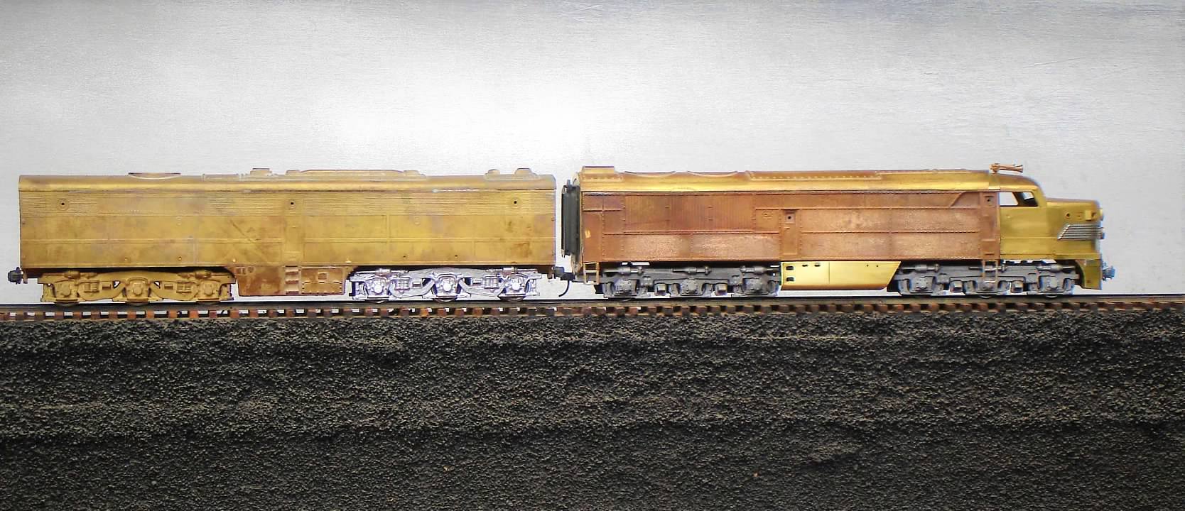

I am awash in CLW cast PAs. Here is a photo from 2017:
My roster list tells me I have a total of ten -- seven PAs and three PBs. I am embarassed to say that none of these ten are ready-to-run, except for a lone B-unit dummy in UP colors that came with the Fernando Valley cast Erie-Built:
I am not sure I will leave them paired, but they actually do mate up reasonably well, and there is evidence that UP mixed and matched their passenger units. So maybe.
More on the fate of the rest of these cast PAs later.

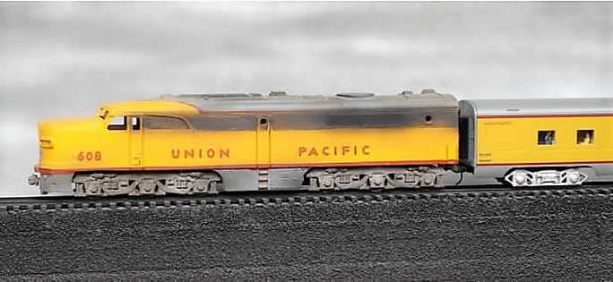

This one actually ran before the sprockets cracked. Six axles powered by a giant 24000 series Pittman (way larger than the 9000-series, and way slower). Dennis cast the passenger car trucks from a mold my dentist buddy made for me.
And surely better than the sides that came with those early doorstops.
But back to the PAs:

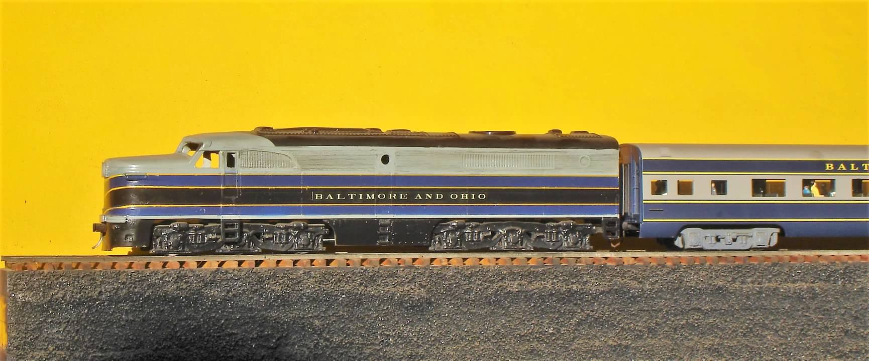

Back when I was in the "actively acquisitive" mode, meaning in the days when I scanned eBay at least once a day for possible "buy-it-now" bargains, I came to realize that Christmas time was often when some of the best deals appeared. I guessed there were two reasons for this: buyers were either tapped out with buying presents for everybody, or they were distracted with holiday events and just not looking. One year I found this pair of CLW PAs for $300:
These have the noses that many complain about:
Nonetheless, given the condition and price, I thought it was a good buy. The decision was made easy by the presence of sprung trucks and drives for both units:
For a long time, I called this chassis setup the CLW "second generation", in that they followed the original solid-gearcase drive in the original PAs. It turns out there were other drives in between, but they are exceedingly rare, so "second generation" still works as a practical matter. They are distinguished by the adjustable frame (which reminds me of an Erector Set), phenolic body bolsters. cast brass gearboxes, sprung trucks, cardboard drive tubes, and open-frame Pittman motor. Works for me.

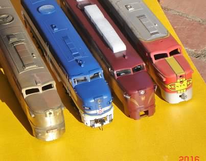

Here are my "noses." Left to right, early CLW, Lionel (latest run - exquisite), Overland, and MTH.
Recall that Jay helped me get a lost-wax nose for my Erie-Built project. Worth every single penny. I would convert a late CLW PA in a heartbeat, but am not looking to invest in it.
As of right now, there are four MTH Scale PA shells on eBay, each for just under fifty bucks. The first shell I converted cost over $80, special deal from MTH. The MTH windshield is not as good as Lionel, but the nose itself may be better.

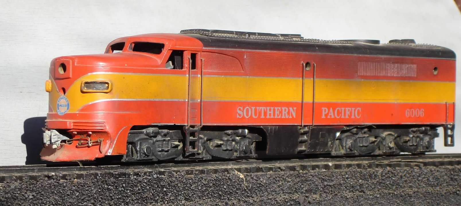

Here is my first CLW PA. Steve Pittges sent it to me for fifty bucks way back when - I worked it over pretty good, powered it with CLW plastic gearboxes and a 9434 Pittman, and painted it SP:

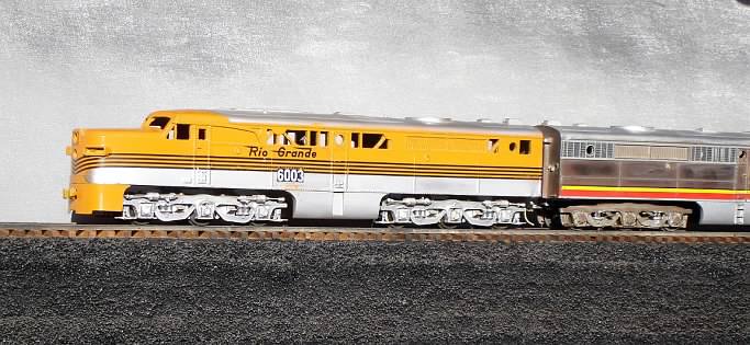

Just thinking about the DRGW - here is one of my favorites: MTH, but converted to silicon bronze by a process known as "shell cast."
The unit behind it is also MTH, but converted by conventional "lost plastic" to nickel silver by Dennis and Kathy. Had to cut it in half to fit the flask.
