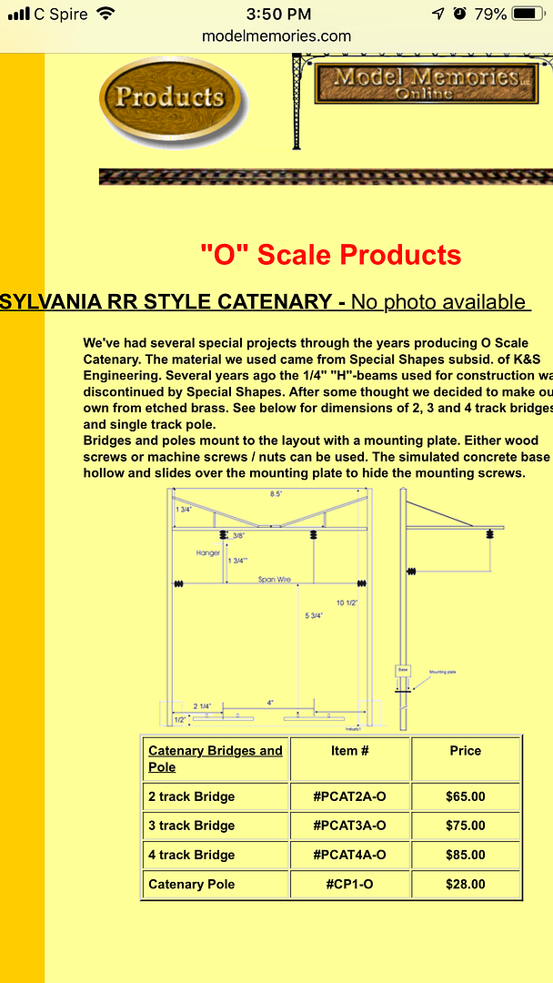

The time has come to electrify one of my main lines. For starters the catenary will not be electrified to actually run the engines. Here’s what I’ve got so far, these single poles look nice but run $28 a piece. A tad pricey.

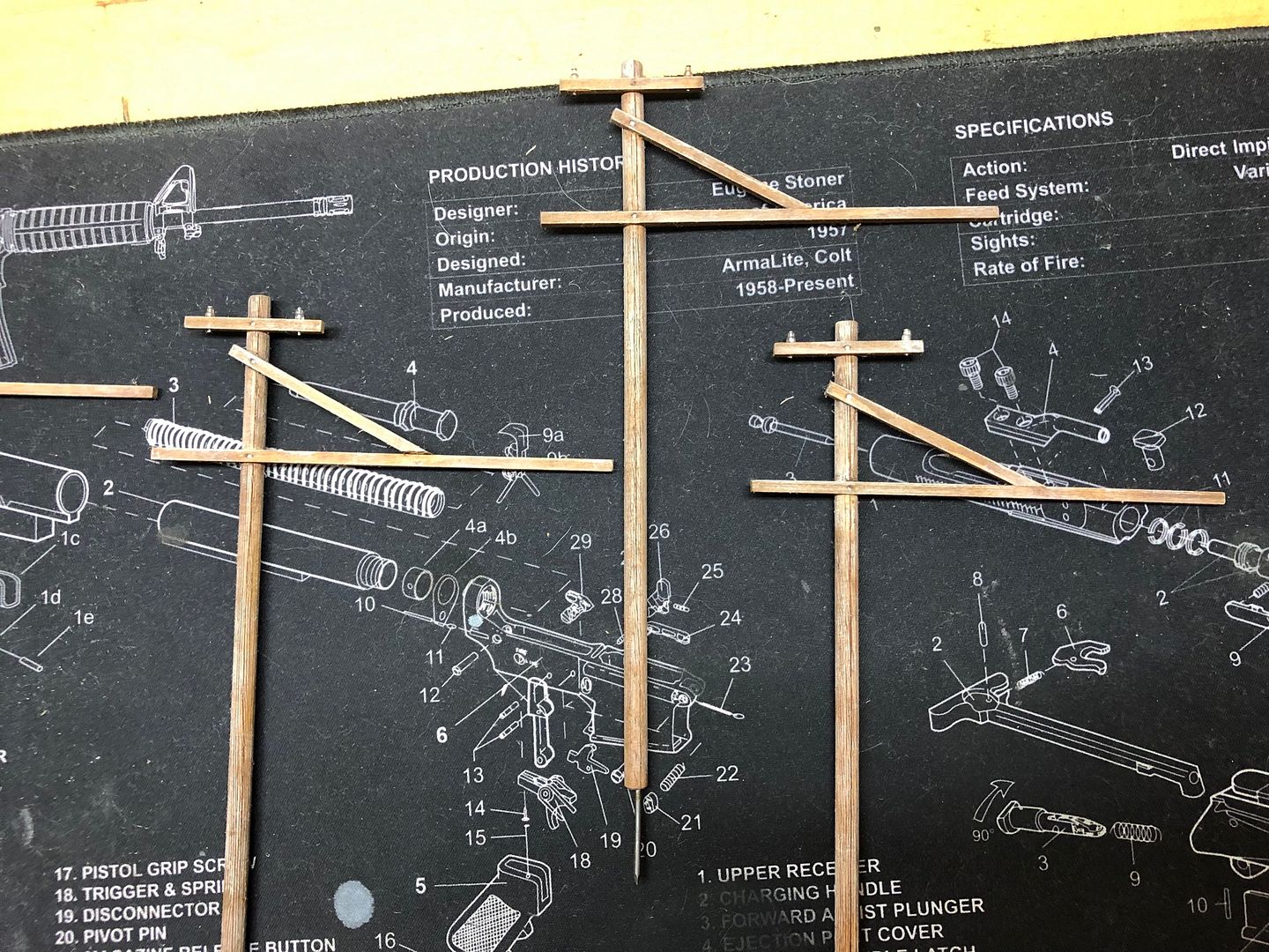

A fella a ways back made me a few of these, but not sure if prototypical. But should be cheap to reproduce.
Any input would be greatly appreciated! :D

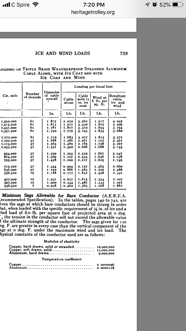

Maybe overkill but look at this book http://www.heritagetrolley.org/Electric ... Richey.pdf
Starting on page 550.
Regards,
Dan
Re: Help with Choosing A Catenary System
Postby 2railjon » Mon Dec 10, 2018 8:23 pm
Dan, I appreciate it. But that made my head hurt! :D

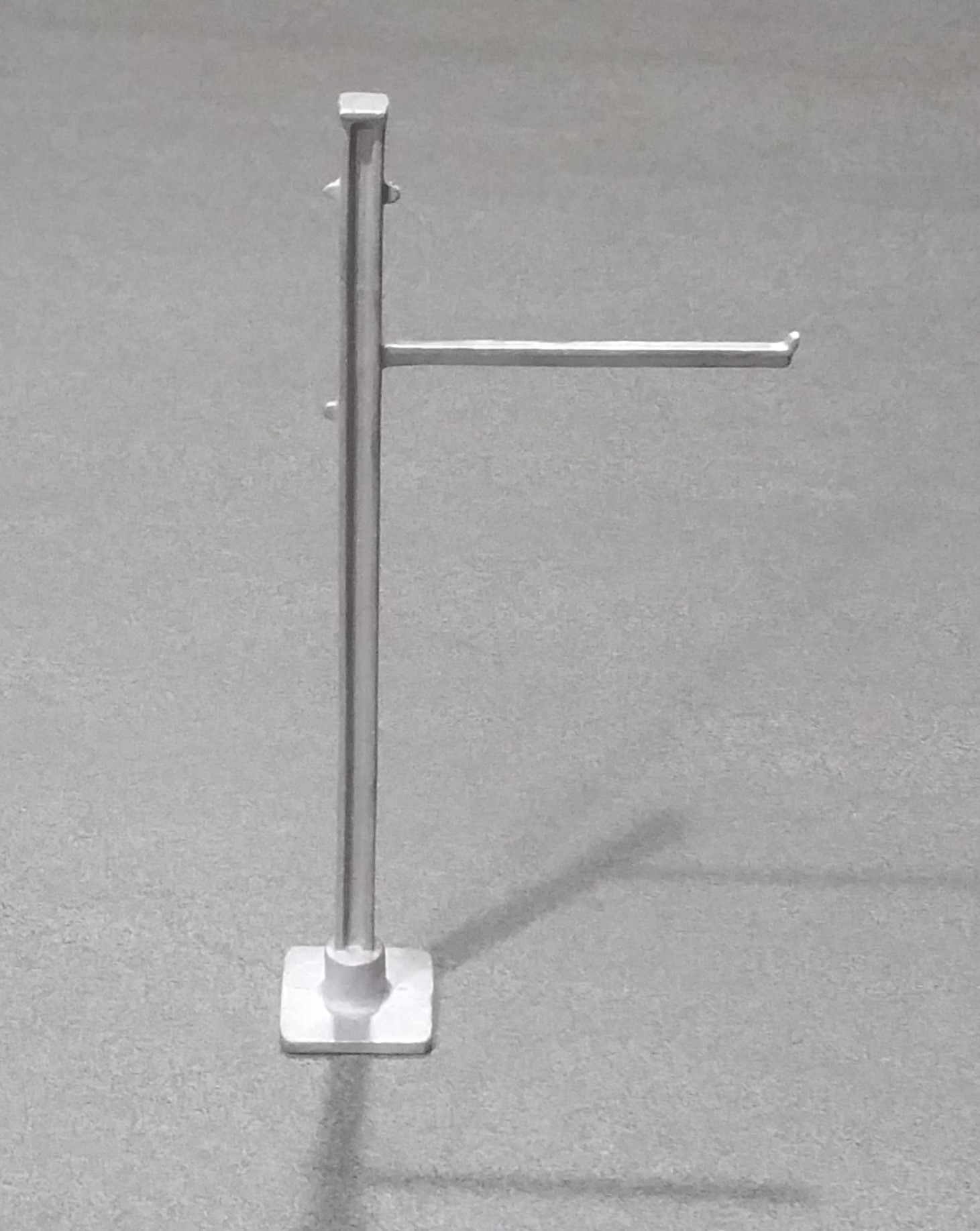

Jon, I don't know how many you need, but I have a box of these:
Line Pole -- Aluminum.jpg (373.24 KiB) Viewed 7297 times
Here they are in the 1990-91 House of Duddy catalog:
They may be originally an Ed Alexander design. PM me if interested. I will make you a good deal.

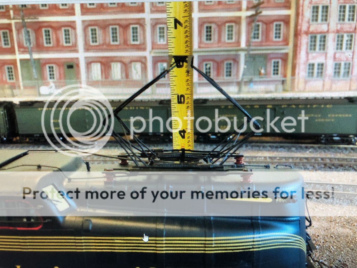

Jim, those poles look interesting for sure! Do you know how tall they are? This afternoon I’ll get a measurement of my GG1 on the track with the pantograph raised to see if they’ll work!

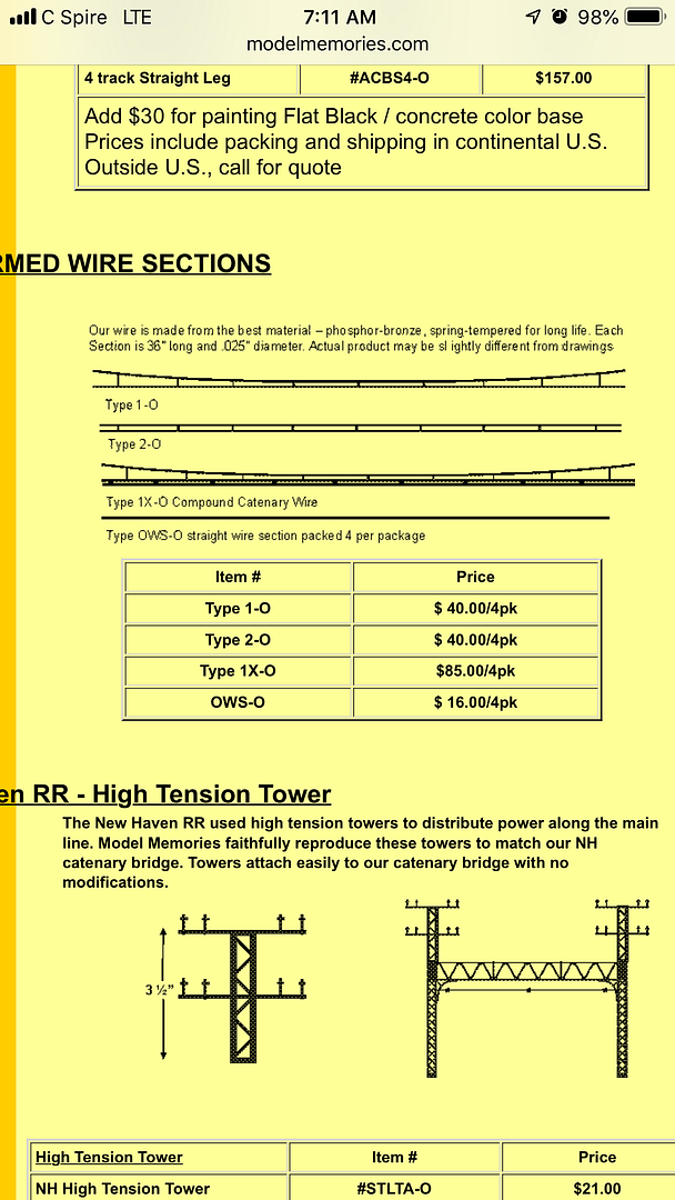

I see these are made in 36 inch lengths. My poles will probably be spaced closer then that. So would I cut the centers out to shorten them and solder? Inquiring minds need to know!
:D
Or I guess I could order the Type 2-0 so I wouldn’t have to worry about the suspended ends lining up with the poles.

Jon -- I got your PM. I will have to measure these for height when I get home tonight. My thought was one could always put them on "concrete" (wood) footers if they needed to be raised.

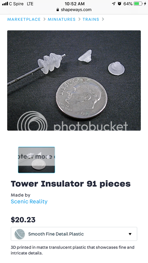

I found a source for insulators:
Postby 2railjon » Tue Dec 11, 2018 6:13 pm
Ok, with the pantograph fully raised on Old Rivets the height is 6 inches.

Postby R.K. Maroon » Tue Dec 11, 2018 10:20 pm
Jon -- the poles I have are 6-1/4 to the bottom side of the cross-arm. You would have to either use that double-wire straight catenary or raise the poles by putting them on blocks, as previously discussed.

Jim , thank you for checking on the pole height! Let me get this CUT P1 assembled and check it’s pantograph height to see if they’re both similar.
