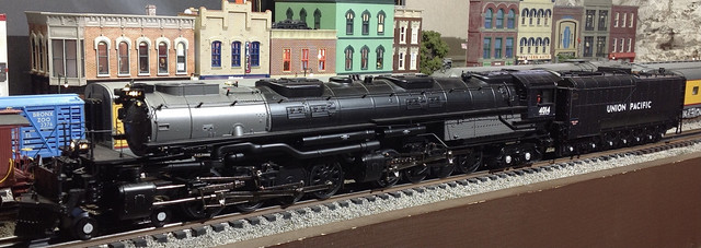

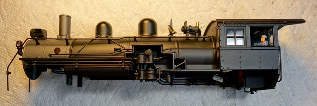

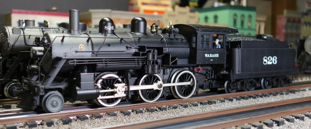

Whoa! Hold the scraper. Lacquer thinner will remove the lettering without damaging the paint. Just use a damp paper towel or Q tip.
The Black paint on MODERN MTH and Lionel steam engines will not be damaged by lacquer thinner. Do NOT use it on any other manufacturers engines including Williams, Weaver, and 3rd Rail. It will damage their paint.
Before.
After
Finished
This is an MTH Big Boy that was numbered 4012. The whole number was removed and replaced.
