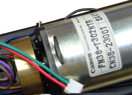

My 3rd Rail E7 has a big honkin can motor inside...any idea what the current rating is on these things?

Re: 3rd Rail E7 Canon Motor?
Seaboard Air Line Fan wrote:My 3rd Rail E7 has a big honkin can motor inside...any idea what the current rating is on these things?
Mine is the horizontal motor belt drive. I'm thinking of converting it to battery
Canon FN38-T302N1B
Rated current: 1.7 amps.
Stall current: 7 to 8 amps depending on motor length.
Reference: https://www.canon-prec.co.jp/english/pdf/dcm/FN38.pdf
Thanks Wayne.
The E7 is the only 3rd Rail engine I have. It runs ok on 072 curves, but I get a strange almost chattering sound above a certain speed. I don't see any wear and tear and figure maybe it's just the drive belt or drive train not playing nice with the curves. My new 2-rail layout should help, along with converting to 2-Rail battery (top speed will be lower) I hope it will be alright.
I may put this off until the Silver Meteor set arrives, I have other engines to convert.

I opened both engines, the motor Wayne showed is the same.
Seaboard Air Line Fan wrote:Arthur, the only real concern is if the motor will operate or trip the polyfuse.
You believe you should test it yourself as Arthur suggests [opinion].
Did you see the note at top of FN38 specifications? "Changes on winding configuration, shaft length or other customizing available."
What are all those numbers after FN38 (FN38-T302N1B)? They are wire size and winding turns specifications and a few other things. Does 3rd rail use a stock 12 volt Canon FN38 or is it custom wound for model train engine use? I could not find enough information on the Canon website to figure it out.
I tested my LionChief Plus GP7 and was surprised at the low current (0.2 amp true rms light*, 1.0 amp true rms stalled with wheels slipping.) I have one Lionel locomotive with a single Pullmor motor that causes the CW-80 overcurrent light to come on when stalled. You cannot really know what a motor will draw without measuring it in the environment it is used in [not opinion, experience].
* "Light", meaning pulling no cars, smoke unit turned off.
Thank you for the photos. One of them answers, "Where does the speaker go?" It goes over a truck (no motor in the way.) Another answers, "Where do you put the batteries?" The answer, "Between the China Drives."
