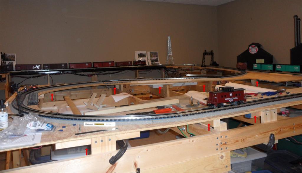

Awhile ago, a friend visited the layout with his 3rd Rail NYC Hudson. It was not a pretty operating session. While my Williams Pennsy engines were very forgiving, the 3rd Rail locomotive found every low or uneven spot on the layout. In addition, the declining elevation coupled with curves were a problem. The original concept behind the idea of elevations was to run helper engines (snapper is the Pennsy term) for trains, but the layout is really too short to realistically support that notion.
The root cause of these problems is pretty straightforward and self-inflicted: I used plywood (11/32) for the subroadbed that was too thin. The thinking was to save weight, but the thin subroadbed requires a lot of bracing - which is what I am now correcting.
The result of the operating session was a list (longer than I would like) of trackwork areas that need help. So I set out to fix them and this is some of my progress.
In the photo, the red arrows indicate the areas that have gotten an increase in height. The track still descends somewhat, but the grade is much more gradual. The track and Vinylbed in the middle of the photo will be re-aligned slightly.
Once that is done, the bridge at the rear of the photo (from the Hi-tension tower to the left edge of the photo) will be replaced. That will involve rewiring a double-crossover.
