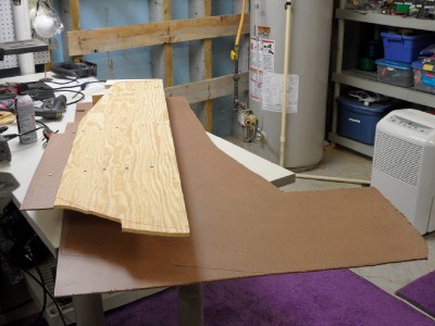

Here are photos of the access hatch on my workbench. The first shows the bottom of the sandwich (upside down). There is a hole for the wires and the terminal strip for the power connections (each leg of the switch).
MPLX 024W.jpg (231.41 KiB) Viewed 7900 times
The second photo shows the wide (slag pit) end of the hatch. I plan to use building foam to create the slope and provide a stable filler between the top and bottom layers at this end.
MPLX 025W.jpg (113.4 KiB) Viewed 7900 times
You can see that area better in this photo.
MPLX 027W.jpg (120.26 KiB) Viewed 7899 times
At this point, both layers are attached to the ribs. Next step is adjusting the fit for easy removal, a coat of paint, followed by attachment of Vinylbed, the track, and the wiring. After that I will probably try my hand at carving and installing the styrofoam "filler".
