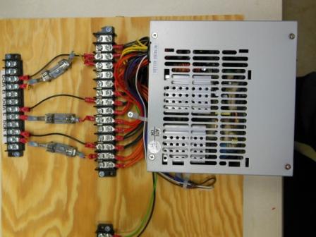

Finished my conversion of PC power supplies into sources of lighting for the layout! I ended up with two power supplies. The Western side of the layout is served by a 235 watt unit. Both power supplies have built in fans and ON/OFF switches and are mounted on a plywood base. The base will fit inside my transformer (TV) cart. The lights and accessories on the Eastern side will be powered by a 300 watt unit. Each supply provides a 3 VDC, 5VDC, and 12VDC post with its respective ground post. The Western unit has a practical supply limit of 176 watts (75% of 235), while the Eastern unit can provide 225 watts (75% of 300). I expect to mostly use the 12VDC output and will run a buss around that side of the layout. From the buss, I will use suitcase connectors (IDC's or Insulation Displacement Connectors) to run feeders to a small Euro-style terminal strip. Wires from the accessory or building or light will join the feeds there. If multiple lights have to be fed, I may use a small bakelite (traditional black plastic) terminal strip to distribute power.

Postby G3750 » Tue Feb 19, 2013 8:17 pm
Pictures!!!
The first is of the board that holds both power supplies. It will be inserted onto the floor of the transformer (TV) cart.
The second is a close up of the 300W (Eastern side) power supply.

Postby G3750 » Tue Feb 19, 2013 11:10 pm
jw_clarke54 wrote:George, let me get this straight- you have BRIDGED ALL the wires????????????? or just the ones that you are using-4 I am guessing.James
No. That would be bad. :lol: :lol: :lol:
You probably can't tell from the last photo, but all the orange (3V) are bridged. There is also a set of ground wires for that tap. Then I've done the same for the red (5V) and yellow (12v) taps.
