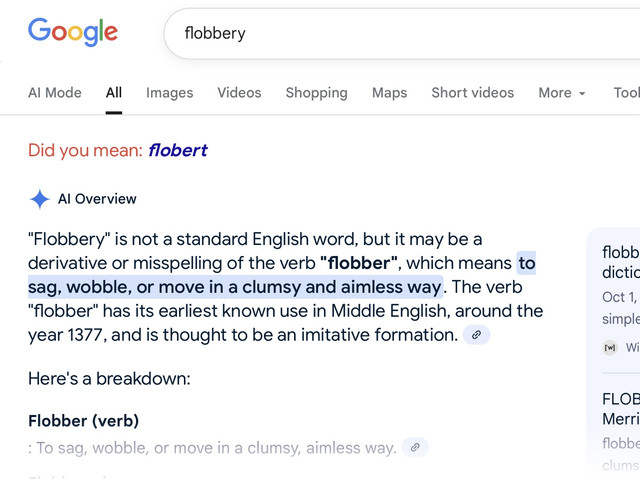

"Flobbery" is not a standard English word. Still, it could be a non-standard or colloquial form of the verb "flobber," which means to sag or wobble, or an adjective form of that verb describing something that exhibits this characteristic. The word "flobber" itself is obsolete, recorded only in the Middle English period.
Surely you're not still trying to pass Google AI Overview off as a source with any veracity at all, are you? If so, the attempt to disguise the reference by changing a word here and there changed the meaning a bit. :lol: :lol: :lol: :lol: :lol:
It's a perfectly legitimate local colloquialism and just a wonderful word!
I truly wish Google would admit their "AI overview" bit is an absolutely unreliable and inconsistent failure and stop trying to pass it off as being remotely accurate in its pronouncements. People might actually believe it.
