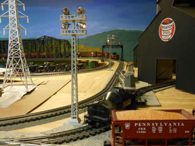

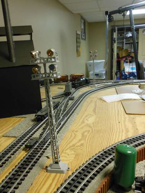

Figured I'd wire up some MTH Floodlight towers using my 12VDC bus. Did the first one and this is what I got... :cry:
I'm seeing 9.6 V at the bridge piers (they have Evans Design U3TR slow red blinking LEDs on them as navigational aids). I might have to go to a nearby 12VAC bus (same one that first the smokestacks at the Open Hearth).
Here's a view of both floodlight towers.
Dang!

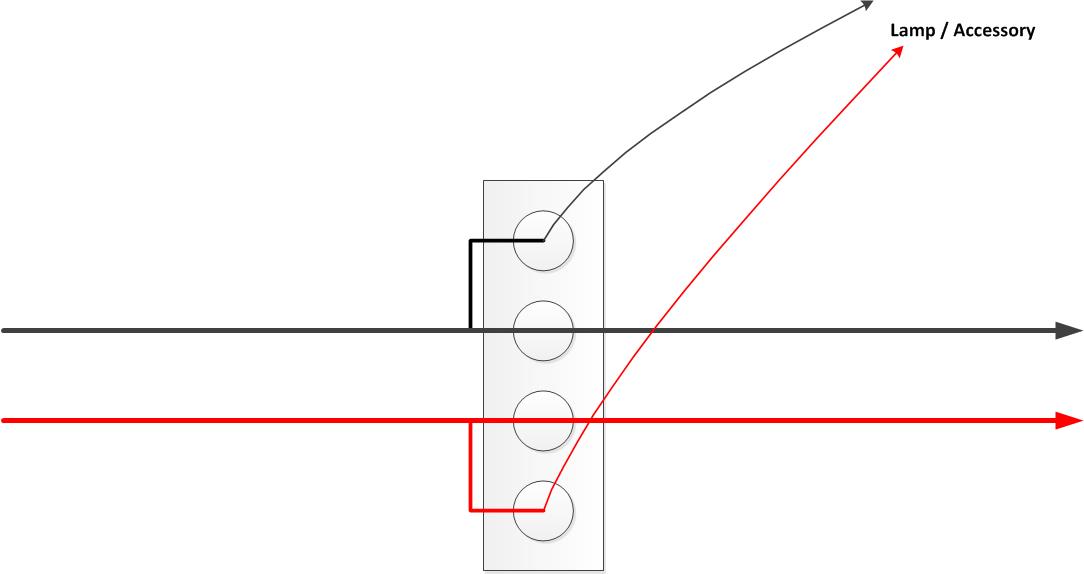

Are the bulbs wired in series?
John Long
Posts: 4347
Postby G3750 » Mon Oct 24, 2016 1:06 pm
jlong wrote:Are the bulbs wired in series?
I don't think so. Here's how they are connected to the bus (this is my quick, crude rendering of a terminal strip).
The bridge LEDs are ahead of this and also connected in this manner.
Postby J. S. Bach » Mon Oct 24, 2016 7:28 pm
I suspect that the bulbs may be rated at more than twelve volts, maybe fifteen to eighteen. A twelve volt bulb operating at almost ten volts should be much brighter.

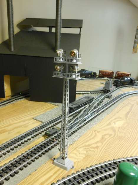

Lamp issue fixed. I was putting 9.6-9.7 volts through the MTH Floodlights. Although they are rated for 7-16 volts (AC or DC), obviously 9.6 produces a very dim light.
I took my 12 VAC feed (from a PowerChief 120F) to my Open Hearth smokestacks and ran an extension to one of the floodlights. Turns out to be 13 VAC at the accessory. :lol:
But at least the tower lights up. It's somewhat brighter than before, but not overpowering.
And yes, that Pennsy signal in the background has lost its mind. Should be indicating "STOP", not "ALL CLEAR". :roll:

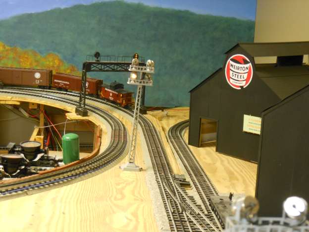

Got both MTH Floodlight towers hooked up to the 12VAC accessory bus. The view is looking "north" with the Open Hearth on the immediate right.
