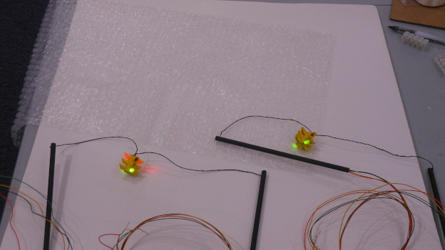

I received my 2 traffic lights from Greg Leonard. They are very good looking. For some reason, I'm having trouble uploading a photo.
Regardless, they are here.

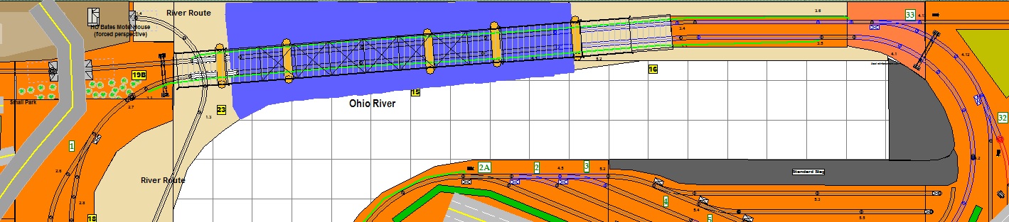

After a whirlwind of distracting activity over the past couple of months (the RPM-East meet, April York, the NMRA Division 2 Jamboree, and NMRA MCR Convention), I have finally been able to turn my attention to working on the Ohio River module – bridge, track, and scenery. Completion of this module is first step to working on the remainder of the benchwork and the layout. Here’s the area in question.

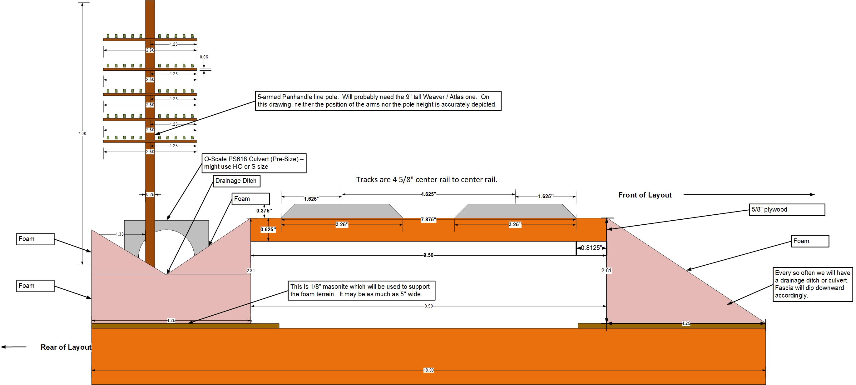

  • Construct the benchwork at the extreme eastern end of the segment. This will help me place the eastern approach to the bridge properly.
    In cross-section, the 4’ or so piece of track just east of the stone arch will look like this.

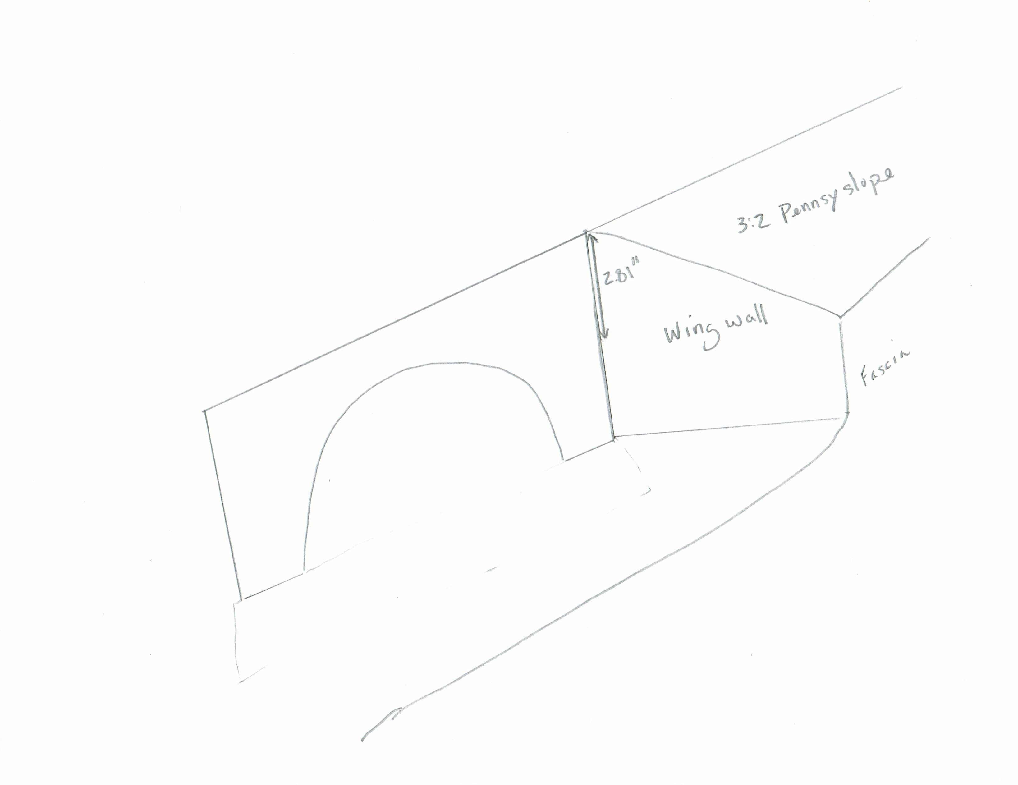

  • Construct the section of track west to the arch. I was struggling a bit with how I would transition from that cross-section to the arch itself. I came up with the use of wing walls. See the overhead view.

  • Slope the ground from just west of the arch down to the river. This sketch shows the arch from the side and beginning of that.
Postby chuck » Wed May 08, 2019 5:40 pm
Wing walls are a reasonable solution, very prototypical. I appreciate your attention to detail and fidelity to the prototype. You can't be 100 scale/accurate given the size of the original material without having an abandoned K-Mart or movie theater to house the layout. All of the things you have been working on provide a great feel/flavor for the place/time you are modeling. Really nice work and thanks for taking the time and making the effort to share it.
Postby G3750 » Wed May 08, 2019 8:02 pm
chuck wrote:Wing walls are a reasonable solution, very prototypical. I appreciate your attention to detail and fidelity to the prototype. You can't be 100 scale/accurate given the size of the original material without having an abandoned K-Mart or movie theater to house the layout. All of the things you have been working on provide a great feel/flavor for the place/time you are modeling. Really nice work and thanks for taking the time and making the effort to share it.
Thank you, Chuck. I appreciate the encouragement. At the moment, I am struggling with the 3-dimensional aspects of this piece of scenery. :? I am creating a more detailed set of drawings. In the process, I hope to work through some of the problem areas, e.g. the drop in height and the relationship between the scenery and the fascia. This is all new territory for me.
Postby chuck » Wed May 08, 2019 8:42 pm
Cardboard is pretty cheap, local grocery store may have some produce boxes you can get for free and use those for mock ups. Drawings/CAD is great but you can't beat seeing a rough approximation in real 3D. You can even mock up the slopes with some cardboard bulkheads and the cheap "masking" tape from a dollar store for "stringers" to get a feel for the slopes. I wouldn't use that stuff for anything else, especially not masking for painting unless it was a job I was doing for someone I really, really, really didn't like :)

I agree with Chuck...get some bits to play with and start fashioning a few alternatives. I think that will lead you to a solution/look that you'll be happier with rather than trying to lay it out on paper. The layout's the canvas, right...if you go with something and you're not happy with it, no big deal to pull it down and try something else. Plaster and foam is cheap.
