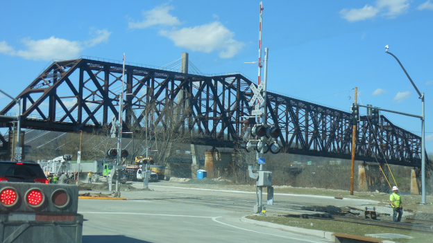

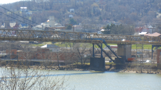

Today I needed to be in Weirton for a BOD meeting for the museum. I took the occasion to photograph what was left of the BOP and parts of the Steubenville waterline.
This hillside just below the road (Weir Avenue) was where my grandparents' 2 story frame house stood (the man who built the large ship models). His backyard ended in a chain-link fence. Beyond the fence was Warehouse No. 2. During the war, that building made 8" naval shell casings.
This photo is of the Market Street bridge and the Ohio River. Water Street (the site of Steubenville's red-light district) is to the right (inland) side of the large brick-faced bridge pier.

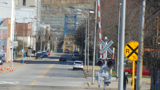

In the 1950's, Steubenville was a bustling center of commerce and industry.
Here's that same view 60 years later. Times have changed and not for the better.

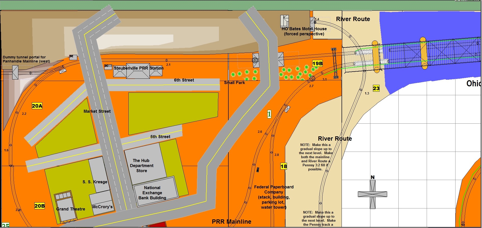

Updated 4/4/2019:
Previously, I alluded to some changes. Here's a little more description of those changes to the Steubenville area.
Below is the northern half of Steubenville. Changes here are:
1) To the left of the PRR station I am thinking of installing a Wye with the right-most track passing into a tunnel. This would be a dummy, signifying the westward aspect of the Panhandle.
2) I have also shrunk the 4th, 5th, and 6th street blocks a bit.
3) At the left-most bottom of the figure, I have started the curve of the Panhandle towards the east a bit sooner than before
4) I am also thinking about doing something with the area to the east of the PRR station (maybe adding a short freight yard or passenger siding
Below is the southern half of Steubenville. Changes here are:
1) I am modeling the ground more prototypically. I have cut back the tunnel to the left edge of the layout. The ground will slope down towards Water Street, which will be at its correct lower level.
2) The edge of the layout below Water Street will be (implied) the Ohio River. The fascia will be a bit lower and represent the shoreline. Drainage ditches and shoreline will be modeled.
3) I will model part of the Market Street at it passes above Water Street.
4) Water Street will have its houses of ill repute back up into the hillside below 4th Street.
5) Buildings serving as view blocks will be necessary at both ends of 5th Street and 6th Street.
As always, your thoughts are welcome.

You could just end 6th at the park. It looks like the real one ends at Logan? I would consider kicking 5th over to meet 4th. Not prototypical but there is a lot of compression going on. On the west side you could put a short length of a cross street to tie it off, almost a "U" turn. Alternate would be to angle 5th south just past the olive area to be more parallel to 6th. I'm not sure how many visitors would be willing to get that close to the back wall to actually look down those streets to there end.
Really nice work on the plan. Comparing the model to the real thing on Google Earth you've done an excellent job of balancing the key points/flavor of the city without torquing the geography/geometry too much.
