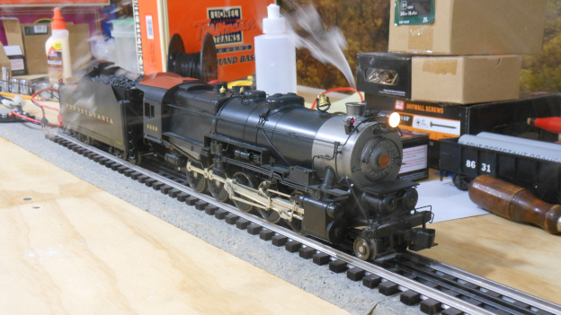

All, I just got TMCC installed on my 3rd Rail Pennsy I1s Decapod (2-10-0). I am psyched! Here are some photos.
There is a video on the Panhandle post over on the other forum.
George,
Beautiful locos.
Except for one thing.
I never saw a Pennsy loco, especially an I1s, that clean.
Beautiful locos.
