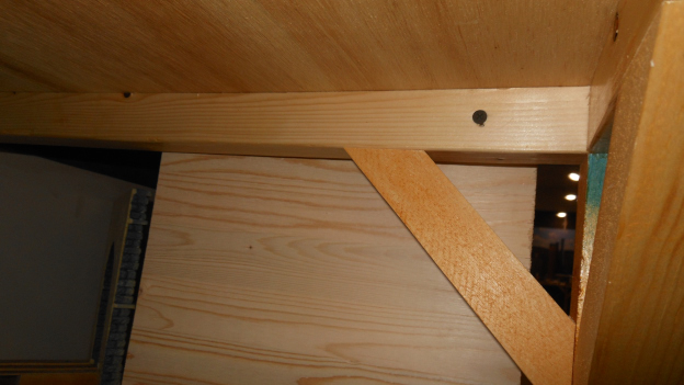

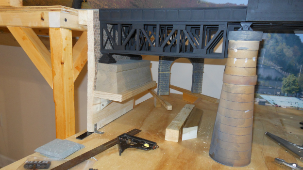

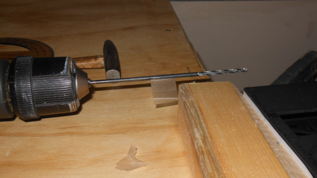

It's been awhile (a month :shock: ) since I posted some progress. In that time I have acquired a part-time job. Anyhow, I managed to get some time this morning to attach the bridge to its western (Steubenville) abutment.
The first step was to cut and place wedges at the correct angle between the abutment and the wall attached to the bridge.
This is the southern end of the western abutment (nearest the viewer). It shows the wedge from the top.

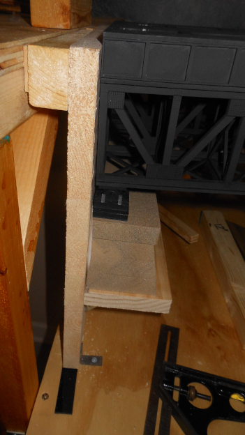

Here is the view from underneath (actually within) the abutment. I used a 3" screw to drill through the benchwork, the wedges, and the wall holding the bridge.

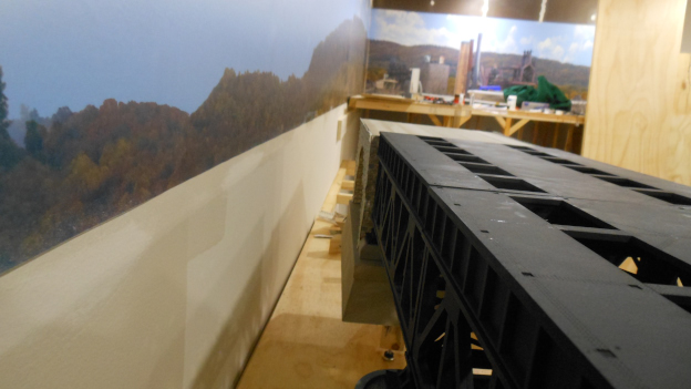

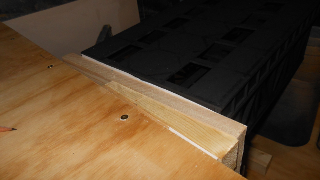

This photo shows a top view of the wedges at the northern end of the western abutment (farthest away from the viewer).

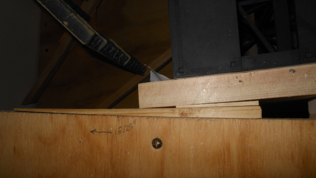

I used a piece of tape as the depth indicator when deciding how far I should drill. I didn't want to penetrate the wall holding the bridge.

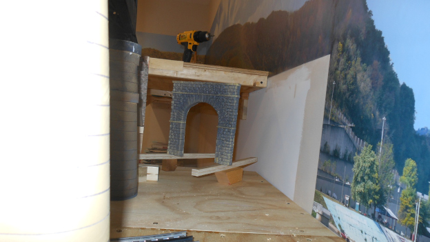

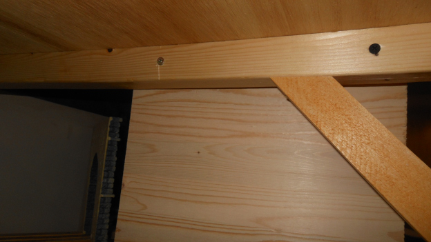

Underneath the abutment we are looking at screw that holds together the benchwork, wedges, and wall attached to the bridge.

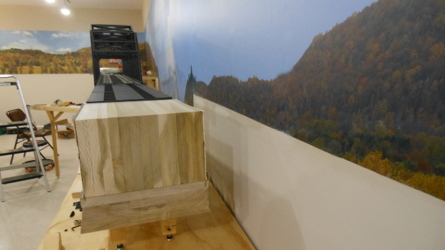

And finally, here's the "L" reinforcement holding the wall to the river bed piece of benchwork.

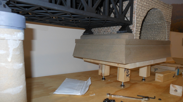

Over the past few days I have re-thought my plan of attack for installing the bridge. Specifically, I have decided to construct the C&P River Route tunnel portal and surrounding scenery below the western end of the bridge, as well as the terrain on the WV side BEFORE putting the bridge in place permanently. These areas will be difficult to reach and work with if the bridge is there.
Photos of the western area:
Photos of the eastern area:

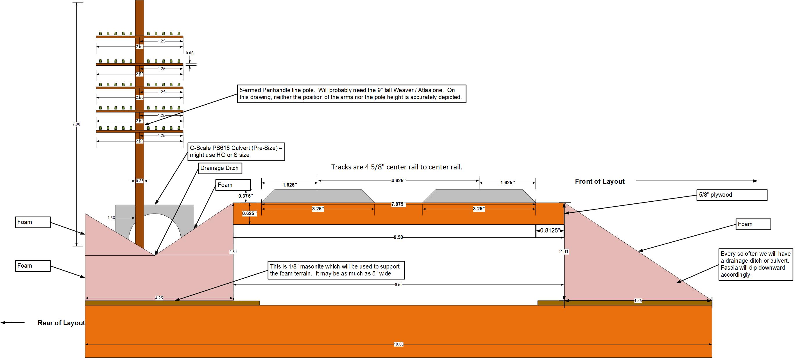

I want the area east of the stone arch to have a cross-section that looks like this:

All of the above means that while we have the bridge and piers in place temporarily, we must mark those locations, remove the bridge, delineate the river boundaries, perform the western portal and track work, do the eastern landscaping (rough), and then put the bridge in place permanently. That's the rough order of things, near as I can figure it. I'm sure there will be some adjustments.

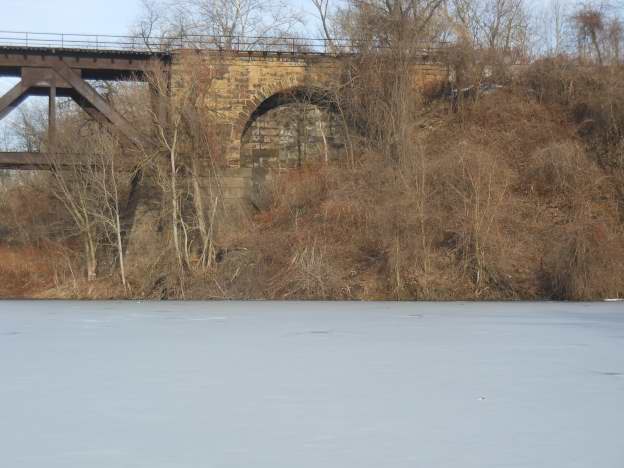

Postby G3750 » Mon Dec 17, 2018 3:02 pm
chuck wrote:You can probably get away with some stands of cat tails on the east bank. Not necessarily on the bank per se, but in ay low areas form the bank to the stone arch. While they are an indicative species of a "wetland" we used to say the tended to grow in any land that was wet. You can see them popping up in any low part of a freeway median if there is enough rain and the soil's drainage is poor.
Looking at the site from Google Earth it looks like their is a "pond" there between the RR bridge and the bluffs that turn into the river valley just downstream of the bridge.

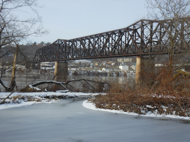

Chuck, that "pond" or backwater has been there for a long time (well over 100 years). This is from construction of the 2nd bridge (1880). It's pretty big as well. I've stood on that spot with the smoking building.
Here are a couple of more modern photos of the area. Plenty of opportunities for junk and cat-tails here!
Postby rogruth » Mon Dec 17, 2018 3:36 pm
George,
Is that on the West Virginia side?
I'm still amazed at how different the water is now from when I left the area.
Postby G3750 » Mon Dec 17, 2018 5:05 pm
rogruth wrote:George,
Yes, that is the WV side. The water should look much cleaner to you. Does it?
Of course, the last 2 photos show the "pond" in the dead of winter. That's ice.
