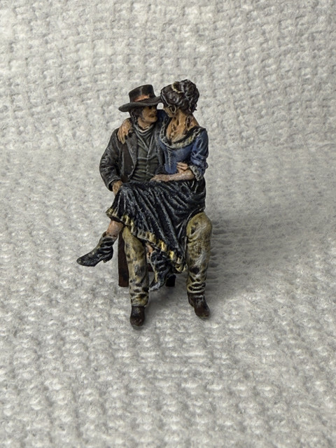

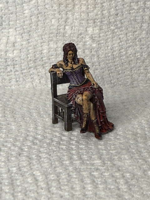

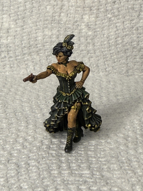

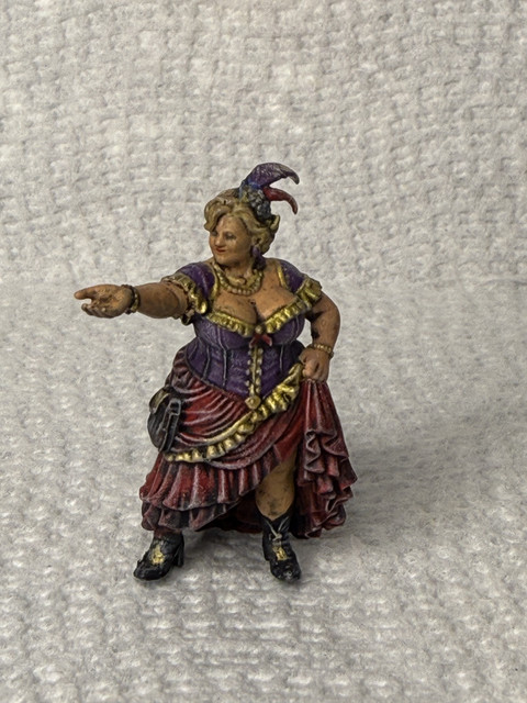

So I mainly followed Paul’s tutorial, except I discovered if I painted the figures black first it allowed me to see the details a little better. I found the dip left some of the skin tones a little dirty looking, so I did find myself wanting to brush some of it away. I may have gotten a little happy on the dry brushing white but over all I like the results
Re: Figure painting
Those look terrific, Greg, especially that third one down. They look ready for “action”, lol. Nothing beats a figure with a bit of good detail, and your paint job is exquisite!
