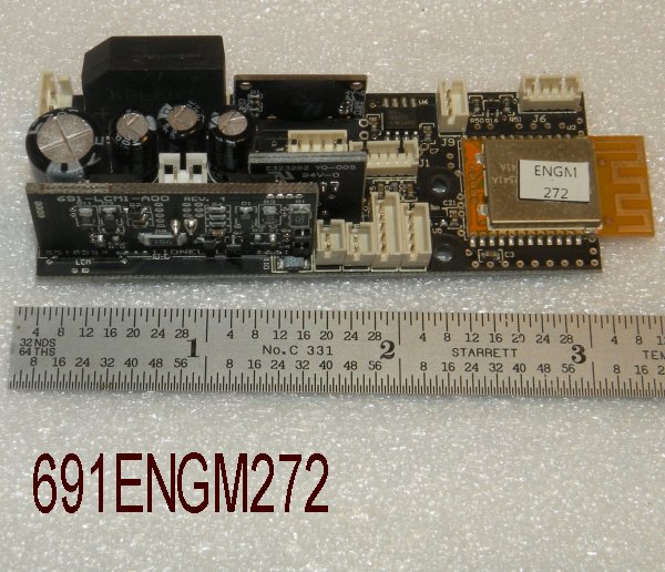

Postby HONDO74 » Mon Jun 16, 2025 2:32 pm
I sent you a PM with my email address You can send the photos to me
Robert HONDO74
Re: Lionel Lionchief
Postby HONDO74 » Mon Jun 16, 2025 5:42 pm
Thank you I received your email with the picture of the board. Interesting that it was for a American flyer S gauge engine.
Since you put this board in a Williams PA I am guessing it would work also in a Williams F7. I have an extra Williams F7 that came in a 3 unit set.. I put motors in the dummy F7 Now all I would need is some electrol couplers for it. Any suggestion on the couplers.

Postby Norton » Mon Jun 16, 2025 8:30 pm
They used that board in both S scale and O scale. The board thats annotated is for a Lionchief NW2. Same hardware.
Pretty sure most all Williams have the same 2” couplers. i usually replace them with 1 3/4” but my minimum diameter is 042.
Lionel refers the mount as mount C.
2” might have the correct ZH connector.
https://www.lionelsupport.com/COIL-COUP ... ENGTH-2.02
1.85” not sure about the connector.
https://www.lionelsupport.com/COIL-COUP ... ENGTH-1.85
All can be found here.
https://www.lionelsupport.com/search?ke ... %20coupler

Postby HONDO74 » Tue Jun 17, 2025 1:11 pm
I looked up the part number from the picture you sent me. 691ENGM272. Apparently they are out of stock. Putting these boards in other engines mush be popular. Have you ever done this with one of Williams brass engines. Would the brass affect the RC signal.
This is the link to the website.
https://www.lionelsupport.com/custitem_ ... ooth%20pcb
This is the link to the picture of the board
https://www.lionelsupport.com/Support%2 ... 067-01.jpg

Postby Norton » Tue Jun 17, 2025 1:57 pm
I used that photo because it showed the connectors better. The one I used that had smoke was for a Great Northern FA.
I think most all the steam boards support smoke though I know the early one for the Docksider does not. Thats the one I am using in my Firecar. If one that is in stock catches your eye, see if someone posted a video of it to get an idea of the horn sound.
