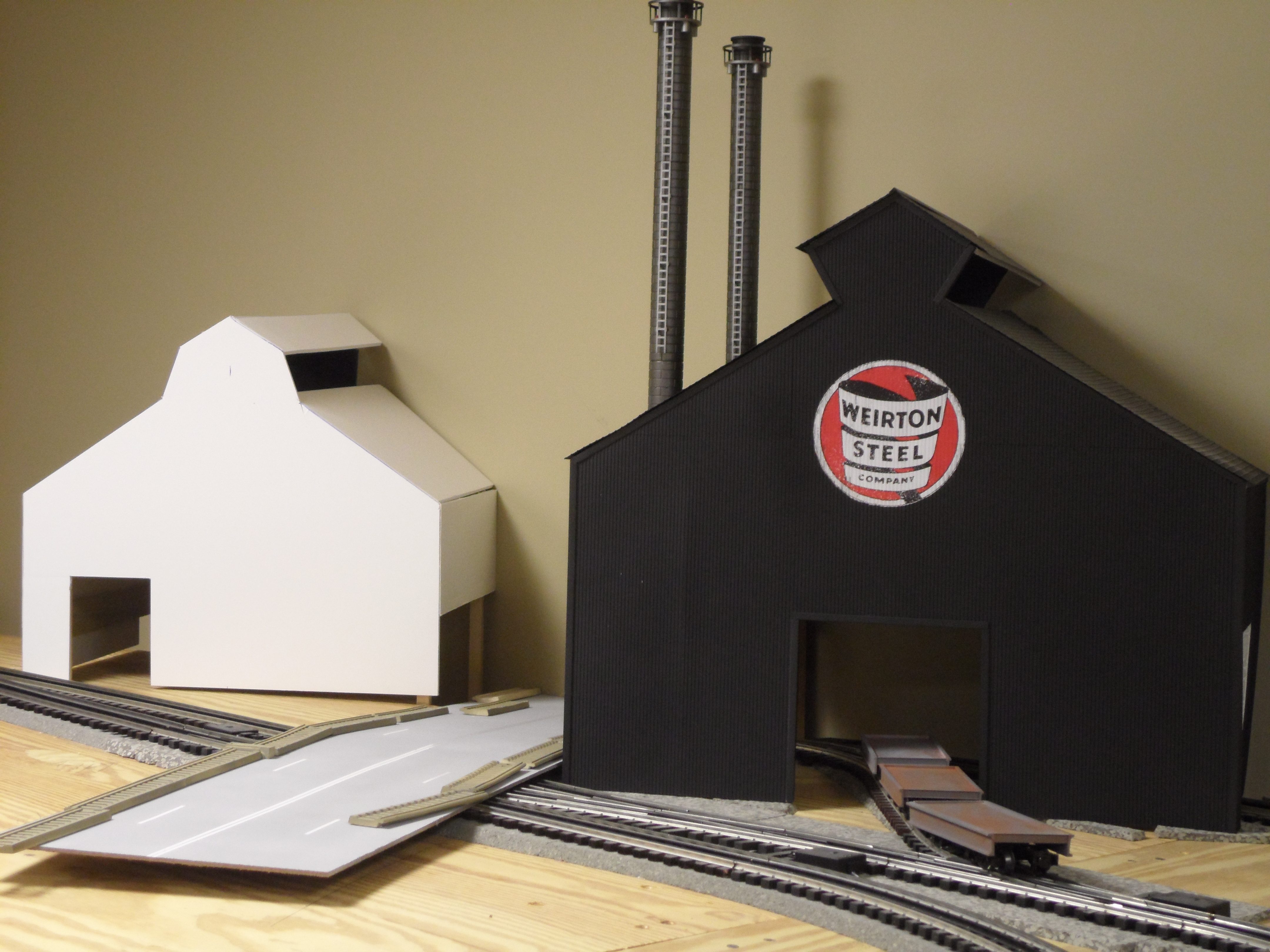

To answer your question, no. When I originally designed the mill area, I took advantage of the trick of angling the buildings into the wall. This made the buildings look bigger. It also allowed me to put 3 mill buildings in that space, a mere 18" x 10'. A linear arrangement for the prototype helps them make steel. But a diagonal arrangement for the model saves space and helps me make theatre.
With the expanded space, I am now able to get 4 much larger mill buildings into a 7.5' x 11' area as well as all the tracks necessary to actually service or operate them.
And, I am maintaining some fidelity to the prototype. An overpass does really divide the mill.

The photo showed the area known as "Crawford's Crossing" as viewed from downtown Weirton (looking northeast). Here's another view of the overpass from a slightly different angle.
And here's what I did with that area in the current layout (version 2.0 will duplicate it but (hopefully) be better!!!).
