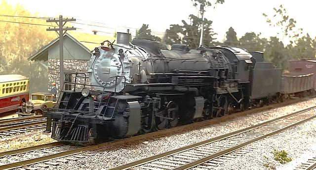

Last week I was invited to an operating session of my old RMCA club at (the late) Ray Duvarney’s layout, still maintained/curated by Bruce Copeland and Brad Smith who are also working on the RMCA’s new layout design as well as rendering their own massive HO version of the Southern’s Macon-Atlanta-Chattanooga mainline in the transition era.
The Duvarney layout's a 1:48 scale thing of beauty, a perfect venue to view and operate some of Marty Magregian’s excellent custom built steam locomotives, among others this newly completed Southern Ls-1 mallet, built as a donation to the RMCA club.
Using prototype photos and company plans Marty started with an OMI Y3 chassis and determined that a salvaged B&M R-1 Mountain boiler was a good facsimile for the prototype due to its smaller diameter than the Y3s. Extensive modifications were made to the handrails, valve gear sets, piping, domes, adding a custom built cab, a rectangular road# plate to the smokebox door to match the specific prototypes road# 4019 as well relocating the headlight from that spot to the pilot platform per the engine’s final service configuration.
Per Marty there were a number of contributors to the model specific to the drive mechanism too; I recall the drive/gearbox was a Doug Cockerham rebuild done some years ago with frame axles most recently modified by Rod Miller with roller bearings (my apologies for any inaccuracies or omissions.)
The big payoff on top of it’s appearance is it runs like a Swiss watch, easily handling some thirty plus cars. Interestingly Marty went with the suggestion to put a small HO Boiler Barker speaker in the smoke box rather than the usual tender “Boom Box” which was surprisingly more than adequate in volume and tone, quite realistic sounding. Stay tuned, more to come.

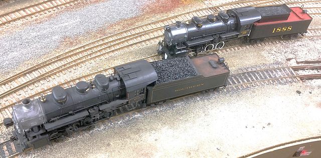

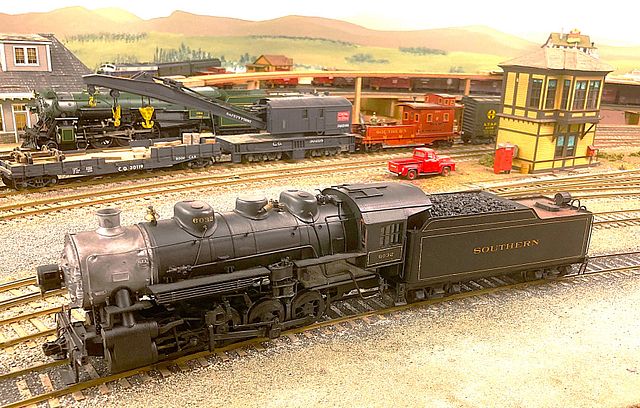

Part Deux, a USRA 0-8-0 by USH that Marty’s modified and painted as a Southern class AS-11 #6032, modifications include re-locating the headlight to the front of the firebox, applying a paint scheme that reverses the road name to the tender and road number to the cab side, somewhat of a mystery, though terminal engines were often “customized” by the local shops.
Likewise the prototype #6032 sported a full width bunker with low sides, here rendered with a salvaged Williams tender as opposed to the more common “visibility” tender as found on AHM’s ubiquitous IHB U4a 0-8-0. I’ve included this shot with a more conventionally painted Southern example of the USH added for comparison. Stay tuned, have one more to post.

Postby bob turner » Wed Jun 17, 2026 8:53 pm
Thanks!
Any chance of a builders photo (broadside) of the model?

Posts: 3134
Re: Some SRR Steam Locomotives
Postby R.K. Maroon » Thu Jun 18, 2026 12:24 am
Pete, that first photo of the mallet is great -- the locomotive looks like an old workhorse in action. Love it!
This isn't the builder's photo Bob wanted, but it's the only Southern locomotive I own:
https://dl.dropbox.com/scl/fi/0slqba43woz0n3hj6ty6l/Hines-0-8-0_02.JPG?rlkey=8iv5ra5wcxekppc1z3aizho01&st=0auph37i
https://dl.dropbox.com/scl/fi/fx5usq15uuic90vyxhm4a/Hines-0-8-0-Tender-01.JPG?rlkey=z7ondpzjfr4p0jns6wr9ofy6y&st=yyjl9r3c
This is an original Hines. Nice that the builder left his mark:
I bought this from a woman in Ft Worth. Her father built it in the years after he came home from the war but before he got married (at which point he put all his trains in boxes, never to fool with them again). Those who have been on the forum a while may remember the Antiques Roadshow thread, which showcased the amazing assortment of vintage models in that collection. Good times.
By the way, the 0-8-0 runs:
Per comments, I have been thinking this needs a high-visibility tender (a.k.a a "coffin" tender, yes? no?), but maybe I'd better do a bit of research on the Southern's prototypes before jumping to any conclusions.
