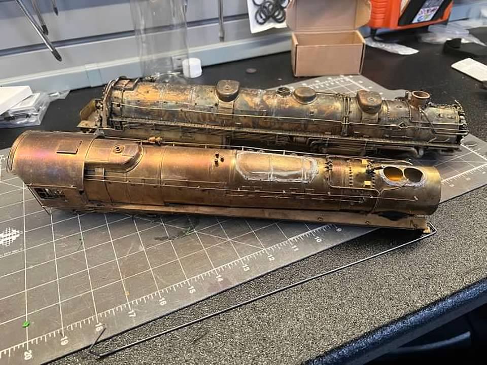

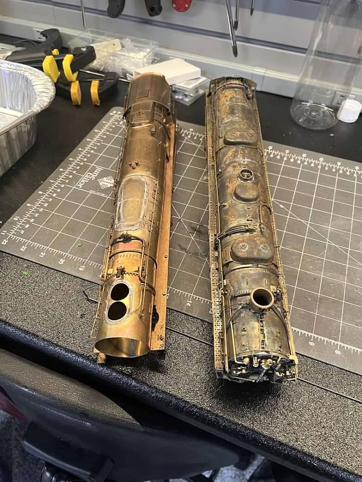

I thought this was interesting so it gets its own thread. I just stripped (again) the paint off the USH FEF and 3rd Rail Z5 shells. I used the PVC soaking chamber method, so they stayed submerged in the pasty Max Strip for 12 to 24 hours, with the Z5 soaking the longest (harder paint).
So, the big question is what does this discoloration of the brass shells tell me (if anything)? Is the 1960's alloy "better" quality or contain more copper or zinc than the 2012 brass used in the Z5?
The discoloration doesn't bother me, as the Z5 is just a donor shell to scavenge whatever detail parts I can for the FEF project........and there will be a lot. Too bad the Z5 perforated running boards aren't as wide as the FEF3's.

up148 wrote:So, the big question is what does this discoloration of the brass shells tell me (if anything)? Is the 1960's alloy "better" quality or contain more copper or zinc than the 2012 brass used in the Z5?
While "brass" is generally a 2:1 copper:zinc alloy, there are probably a lengthy list of variations from that ratio and then processing in sheet brass.

I figured it was a different % of ingredients in the alloy used by 3rd Rail and the Chinese, compared to what was used back in the 60's by KTM/Japan.
I mic'd the thickness of both shells in several areas and both are in the .030 to .032 range, which I thought was a feather in the cap for 3rd Rail. I remember my Korean built models were less when I mic'd them back in the day, but I can't remember the numbers now.
