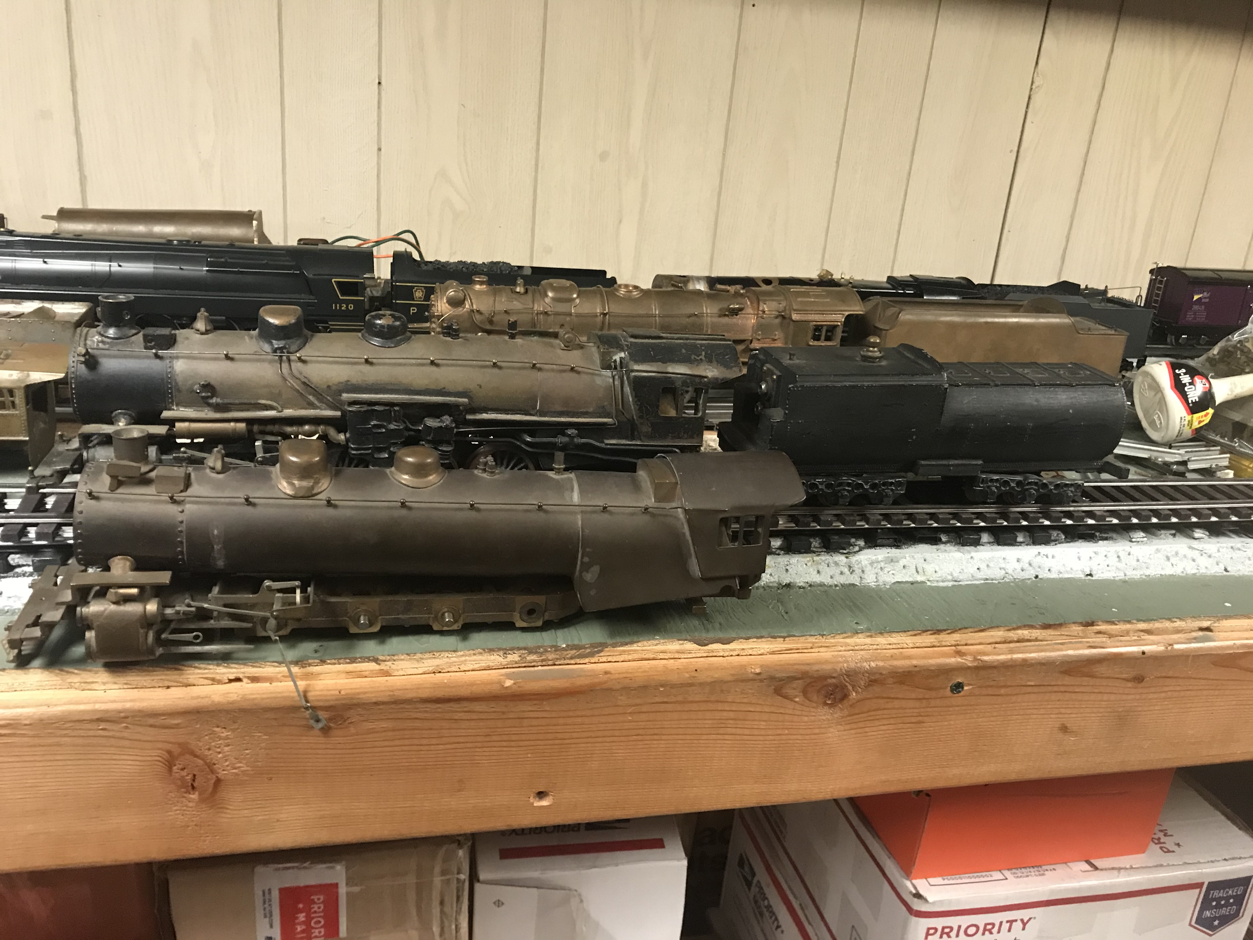

Do you typically use a higher melting point solder when putting the major sections together? Any support rings inside? and how do you prop for alignment? I have a Scale Craft Mountain boiler that the builder allowed to droop in the middle. He must have had it supported by the smoke box and the cab.... I, understand to fix it, it will need to all come apart and that is fine... I need to learn how to do this stuff...
Here is a pic of the little beasty

Difficult to tell from the photo - is it one piece from smokebox to firebox? Is the crooked joint the firebox seam?
Yes, I use inserts - usually .032 or better -with 2-56 flathead brass screws to ensure alignment when I solder. I use straightedges and eyeballs to get the tapers aligned. I do not always get it right the first time, so sometimes the screw holes need realignment. Once in a while I get the taper wrong, and it is start over time. Firebox tapers are the last thing I do, and those are mostly eyeball. I always bolt the cab on, and study it for a week before soldering.
I use 60-40 solder for everything. I have 80 Watt, 150 Watt, and pencil torch at my workbench. Cleanliness and good flux are essential.
I did do a boiler with silver solder - the real stuff; 1100 degrees! Never again! Result was ok; you can see it in my SP Steam threads (GS-2 in 17/64, viewtopic.php?f=10&t=19746&start=15, bottom, #4410).
In the olden days, Oatey's H2O was spectacular - I could use it on dirty brass, without tinning. Can't find it, so I just use ordinary flux and cleanliness, and tin both surfaces. Even old solder needs to be cleaned and tinned.

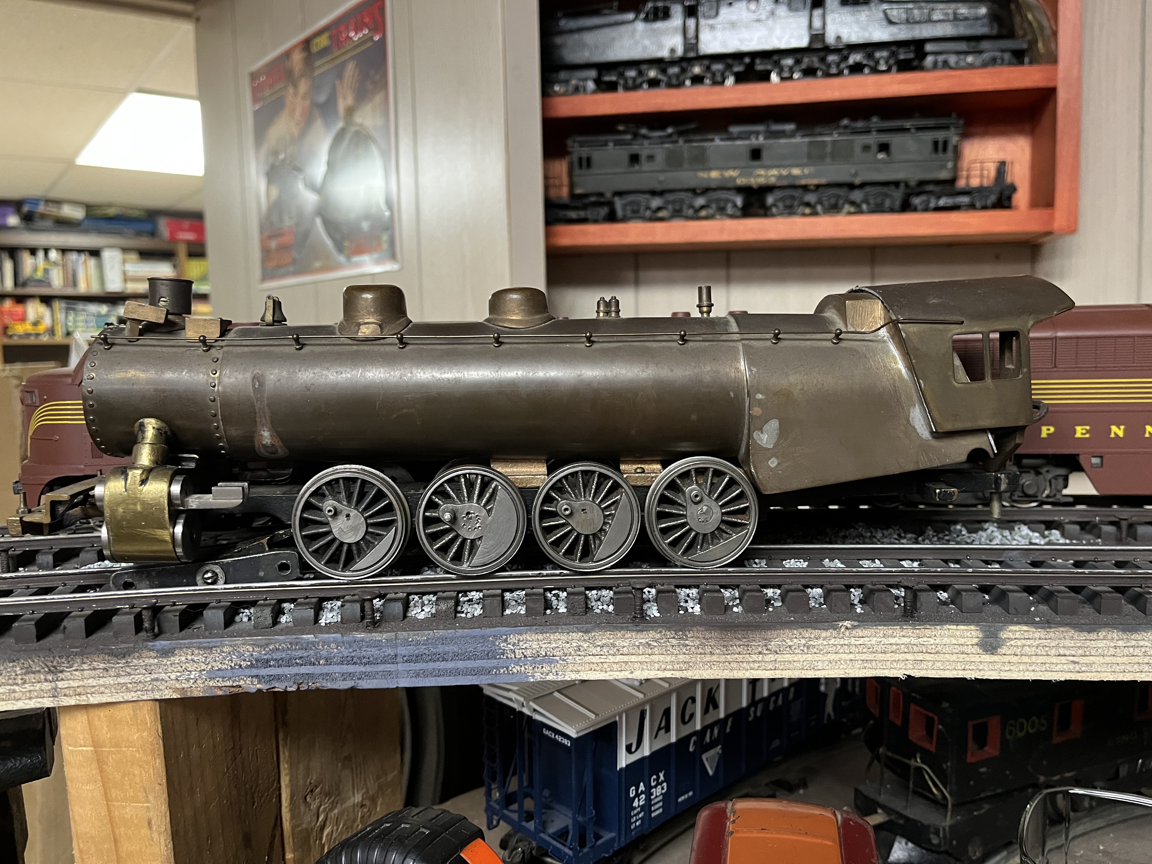

Can you get a better photo of the sag?

I'll get a better picture tonight. The smoke box is separate but the main part is one piece from there back to the firebox. Typical Scale Craft boiler, still has their big bronze casting between the tube and the firebox section. I'll get some pictures.

Hope these pictures show the sag. It isn't much, I think I can fix it.
I think I just need to make a jig to support it. I'm just wondering if I should pull it all apart or just try and heat and re align. That might work on the smoke box, but I think I'll need to get more serious on the firebox end. I feel like the cab is sitting to high, although it is partially loose. I have a couple of other boilers like this, I may try and do some practicing.

Heat it up with a torch. Firebox and cab should just drop off. You might have to pull the smokebox out. Obviously, wear welders gloves.
Any mating surface that is not shiny silver needs to be cleaned to shiny brass. I suggest a new smokebox overlay, with better rivets, but what you have is sort of standard for the area.
Tin the bare brass with a soldering iron. Assemble either in a jig or with pins. Heat with a torch, touch some solder in the joints.
Yes, cab gets lowered. Use photos to gauge - lots of them on Bing.
