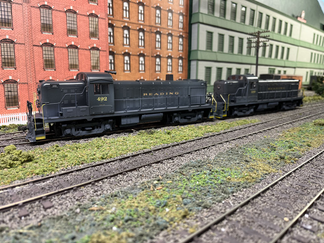

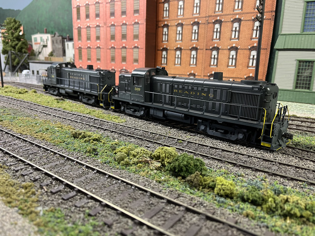

I'm writing an operations scenario for the ops group that meets here every other month, this one to be Harrisburg in the 1960s when PRR was running locals and transfers powered by Alco T6's (because I have two of the Carworks ones I finished up). The other player in town was Reading, and their signature power around town was the RS-3. Fresh off the workbench is this pair, detailed up for Reading, painted, drives geared down with Stock Drive components and NWSL geared wheelsets.
Reading put the Pyle National bug-light markers only on the long hood, rain gutters were a signature, and the headlights differ between the two with 509 equipped with the earlier single-bulb style while 492 had the twin sealed-beam type.

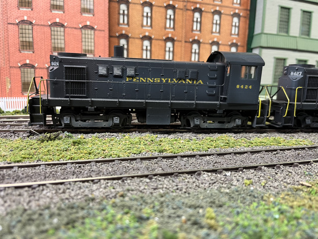

Here are the PRR T-6's I did up, Carworks brass imports, regeared with Stock Drive parts.
They originally lived at Enola and regularly did local work into Camp Hill and around Harrisburg until they got moved to New Jersey in the mid-60s where they remained into Conrail. To stay within that span of years in Enola, the scenario is set in the early '60s, so the Reading power out of Rutherford in Harrisburg assigned the same sorts of work were predominantly RS-3s. Only a couple of them ever were repainted in green and yellow, so that earlier dark green you saw is the appropriate Reading scheme for this scenario, which is intended to represent transfers between the two railroads and the various urban switch-jobs.
