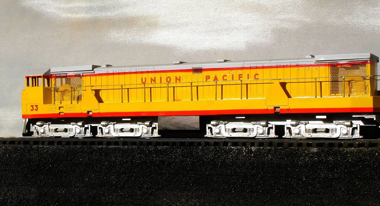

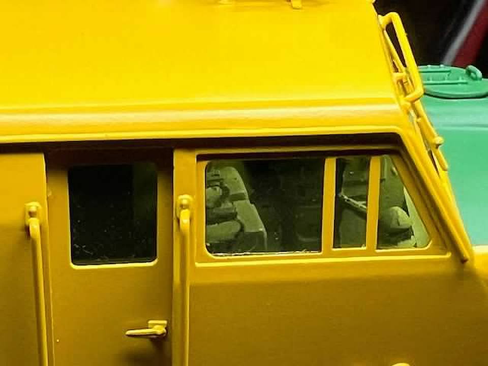

Hand built by two Japanese craftsmen for a Japanese model railroad club. Look at the pilots. One model open and one modeled closed. Just incredible detail for hand built and everything I check against my UP books is correct for the "as delivered" loco.

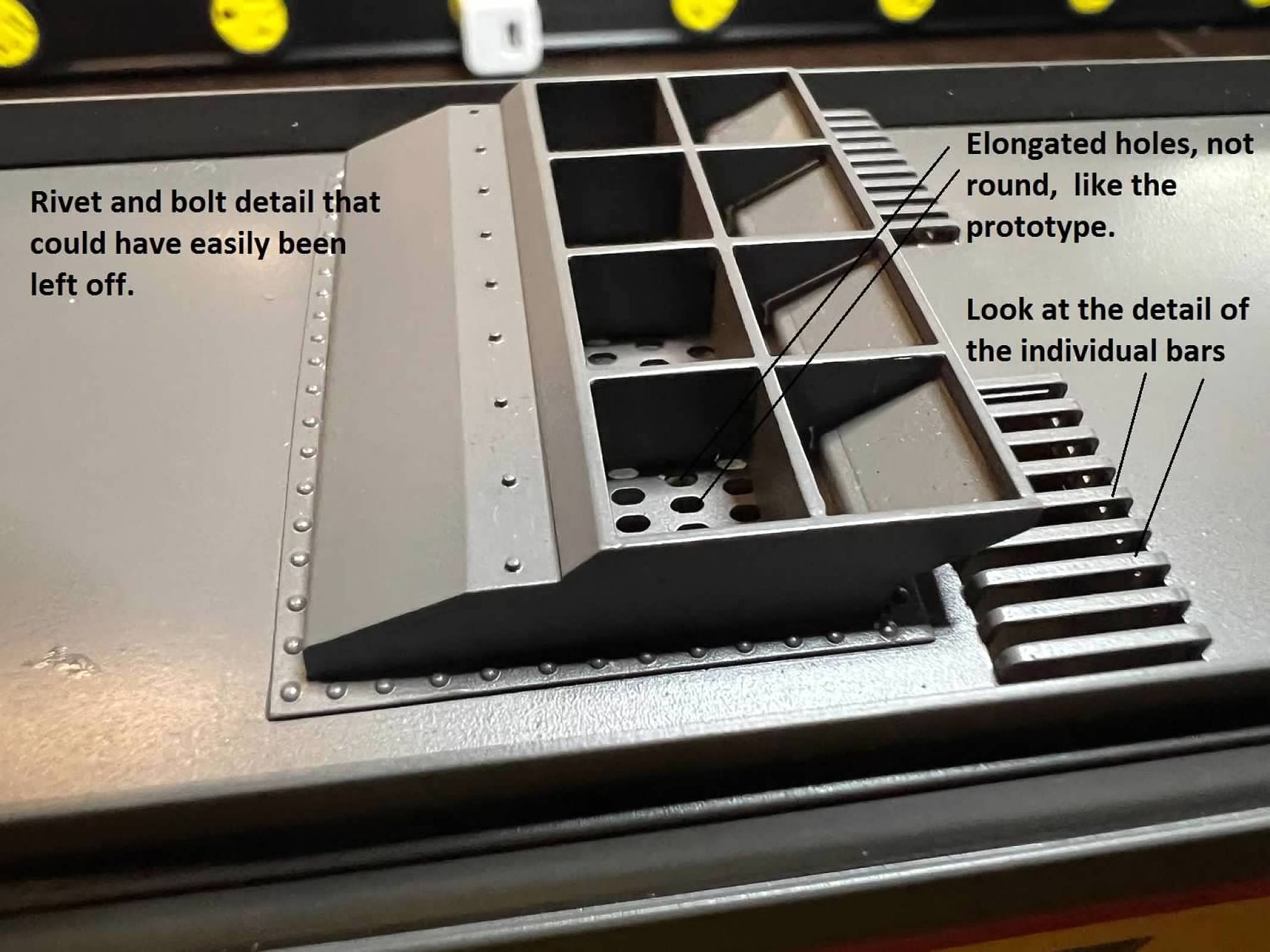

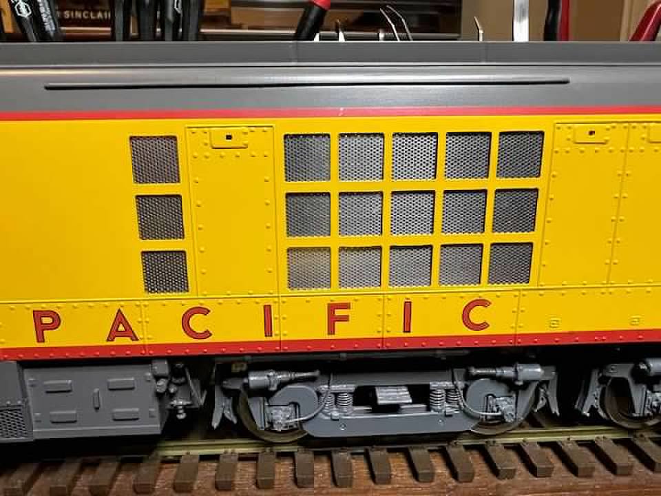

I really wasn't interested in this model until I saw the photos and checked it out for accuracy. I expected something much more crude looking, not something that looked like it was built by AJIN or Samhongsa back in their day. The relief on the brass just doesn't look like hand built.

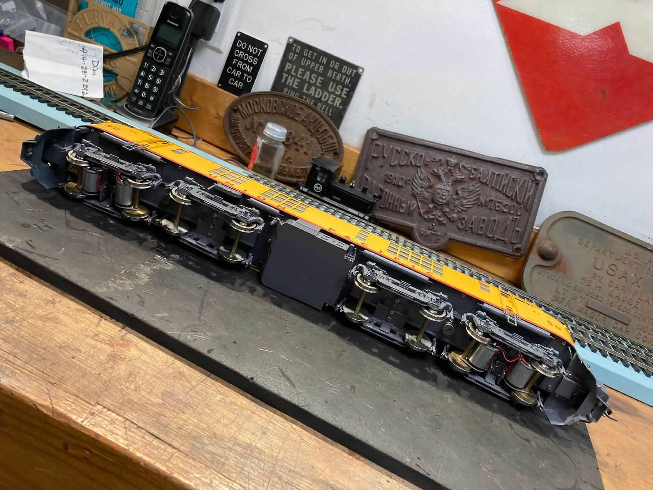

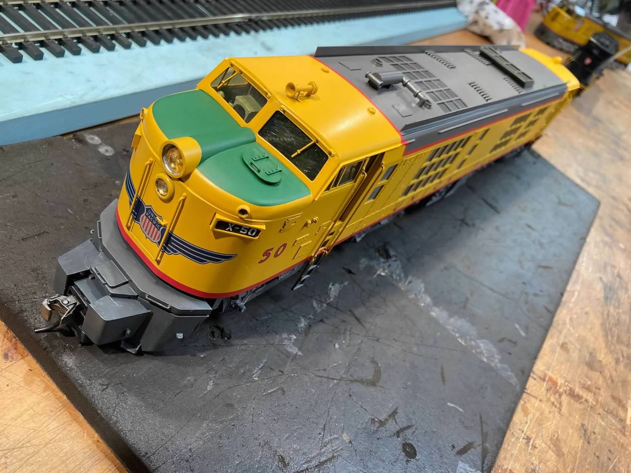

Oh, maybe I will. Took some new photos this evening:

Model arrived on Tuesday with a little (easily repairable) shipping damage, but we've had the Grand-kids since Monday (spring break) so train time has been limited. They went home last night so I can get back to trains and chores. They get a whole week off for spring break in grade school these days.....in my day we didn't have this and maybe a teachers conference that gave you a Thursday and Friday off.
You guys know I'm a rivet counter and an illness for highly detailed brass models. Now days plastic models are just as highly detailed as the best of the best brass, but back in the 80's that was not the case. Lots of great history of brass models too that I love.

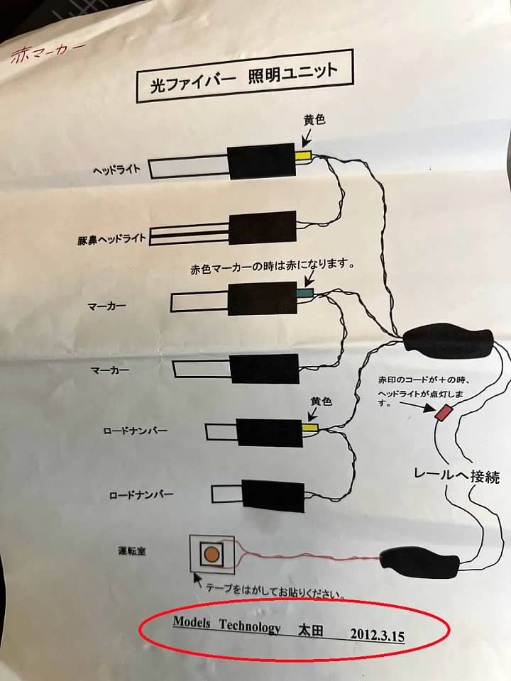

Anyway, the model is even more impressive than I expected. The etchings, castings and overall detail is extremely high quality. In with the model was a wiring diagram in Japanese and a name at the bottom in English of Model Technologies and the build date of 3-15-2012, so the model is a much later build than was expected. I was given the names of the two Japanese builders who must own Model Technologies, but don't think it wise or post them on the internet...........but if anyone has heard of Model Technologies in Japan I'd sure like to know.

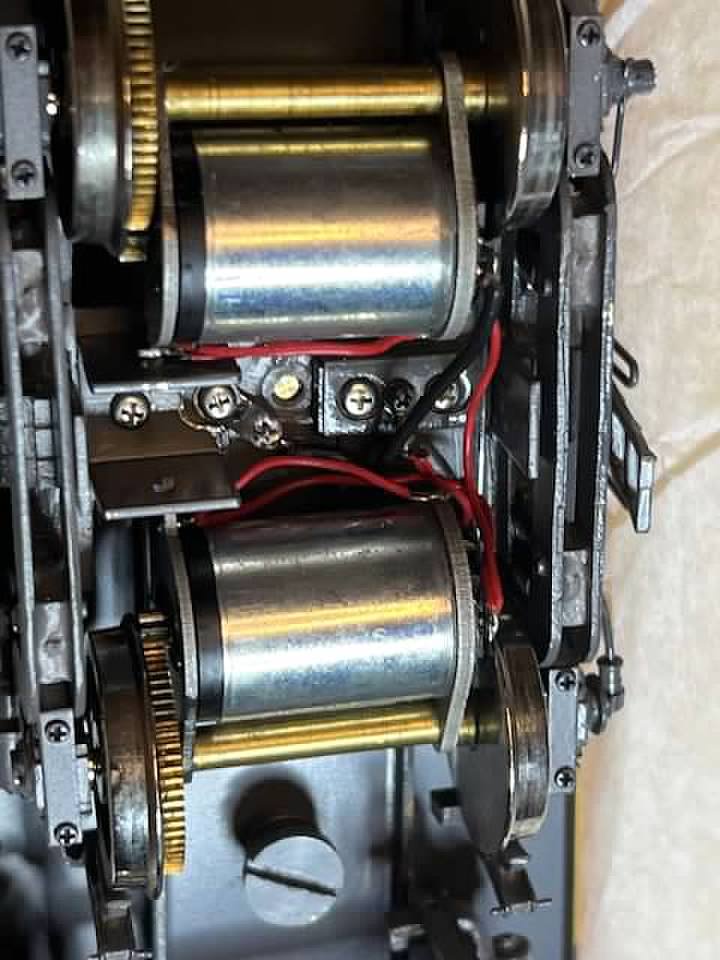

I've never seen the "Magic Carpet" drives in person, so if anyone can confirm that is what this model has I'd be grateful. This drive set-up is coasting, but maybe off MC type drives were.

Re: Union Pacific #50 Turbine
up148 wrote:I've never seen the "Magic Carpet" drives in person, so if anyone can confirm that is what this model has I'd be grateful.483387[/img]
Magic Carpet is an NWSL term for drives like the one in your O-Scale UP #50.
The NWSL Magic Carpet drive hangs the motor off the axle but since the term magic carpet refers to there being no drive components inside the model (looks like a magic carpet when the body is removed) I would call K-Line's motor in the truck a magic carpet drive also.
The K-Line three-rail drive truck.
As usual, it's Wayne to the rescue.....thank you. I can see the drives in my turbine are based on the same principle as the others, but my turbine motor appears to be larger and has only one drive gear and one driven gear, versus the reduction gear set-ups I see for the Walthers and NWSL versions. I still haven't powered it up, as other life projects have taken center stage.

I'm hoping that is the case. Trying to figure out if there is a way to add DC/DCC to this loco, but with the drives/trucks picking up the power directly from the track I'm not sure how a control module could be wired in. But, I know nil about DCC. Lot's to learn and think about.

up148 wrote:I'm hoping that is the case. Trying to figure out if there is a way to add DC/DCC to this loco, but with the drives/trucks picking up the power directly from the track I'm not sure how a control module could be wired in. But, I know nil about DCC. Lot's to learn and think about.
Butch, it can be done pretty readily.
Unhook each of the motor leads and solder (with shrinktube insulating each solder joint) them appropriately to a pair of bus wires, then bring the ends of the pair of bus wires into the carbody.
Repeat the same process with the pickups and a second pair of bus-wires.
Test to make sure you have the pickups sorted and there are no shorts.
Put power to the motor busses to ensure all the motors run in the same direction.
Hook the pickup bus-pair to the pickup inputs of the decoder (placed in the carbody).
Hook the motor bus-pair to the motor outputs of the decoder
Then you can treat all lighting and sound outputs from the decoder as normal.
That's pretty much how you treat one of those Key Samhongsa Alco RS's with the underfloor-style drives.
