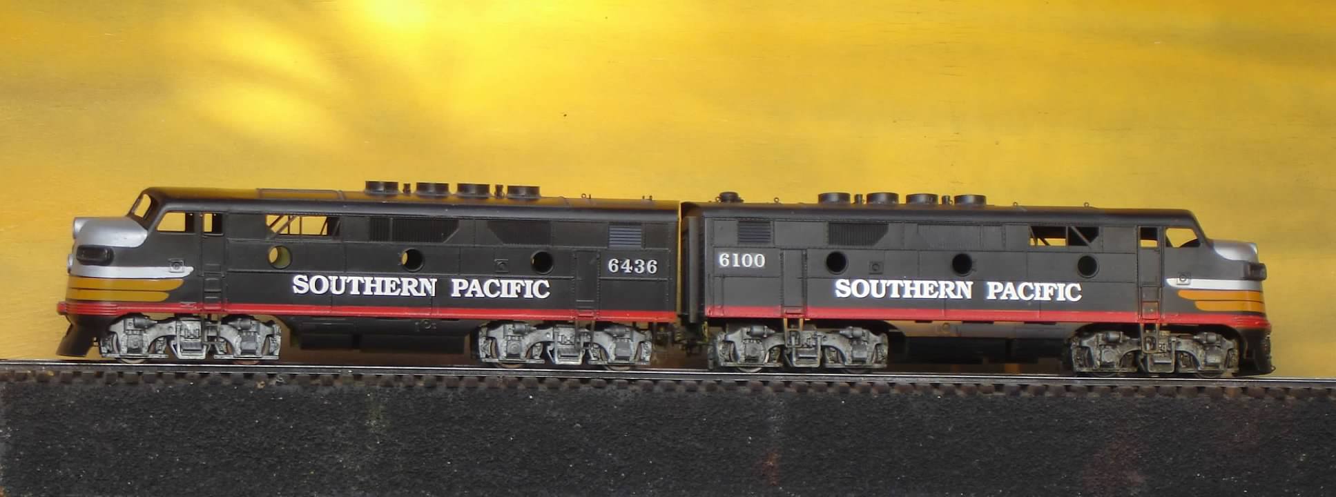

The Atwater/All Nation F3s do not have a reputation of warping or disintegrating. As far as I can tell, they are pretty much equivalent to the Deses except that they may be not as heavy. Deses improved the windshield, but not by much.
As an owner of an A-B-A UP set and an A-A SP set of Atwaters, I have always been happy - but Maroon sent me some brass/bronze castings that I like a lot better, due to the feeling that they will never, ever, ever disintegrate. They may come unsoldered, and some crazy guy in 2079 may have to re-solder them, but they are here forever.
Yes I have posted these elsewhere, and yes, they await a more sophisticated paint job, but I really like them.
I think I have an Atwater photo in the Shutterfly:

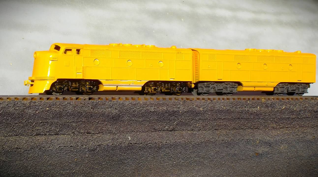

With permission, here are Carey's images.
I will get Retro's permission to post his ACL FTs here as well.
Note the striking color scheme - almost as good as Warbonnet!

As promised, Retro's FT:
With permission.
We have decided that this set is simply a scratchbuild, using Adams castings for nose and roof. The rivet battens on the sides are exquisite, yet indicate that each rivet was hand-punched. Very unlike Wentzco or any other early FT model. You can see through the screens.
I have some better photos, but I would have to put them in Shutterfly to copy them here - MTJ needs a host.
With permission.
