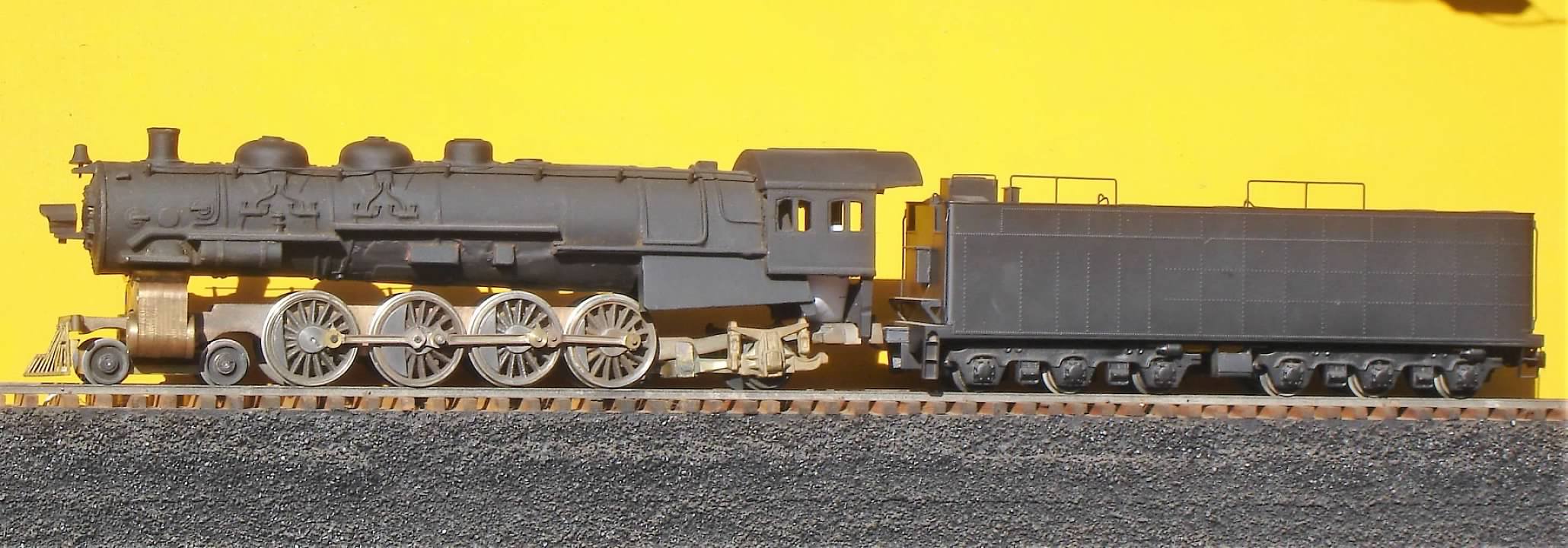

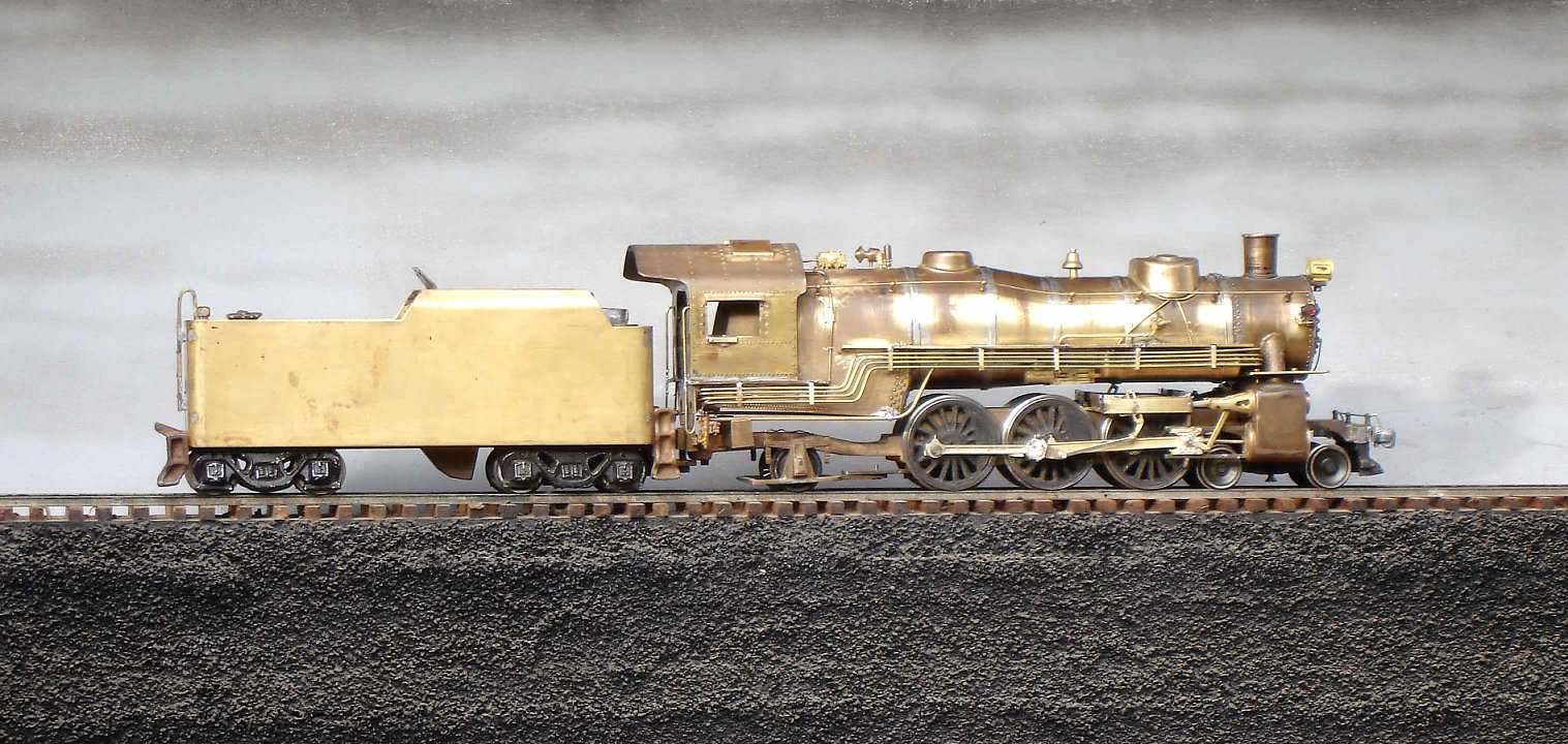

So here they are again - first the Mike. This thing has a Lobaugh Berk mechanism, which is in balance a good thing. And since I have great disdain for the Scale Craft tenders (all of them) I make my own.
That can become a Pacific with a couple of screws replaced:
Apologies for the tender truck (that is for Dave - hope he is doing ok) - and it looks like I could use a spacer under the cab end - but don't forget, right after this photo the boiler became a Mike boiler.

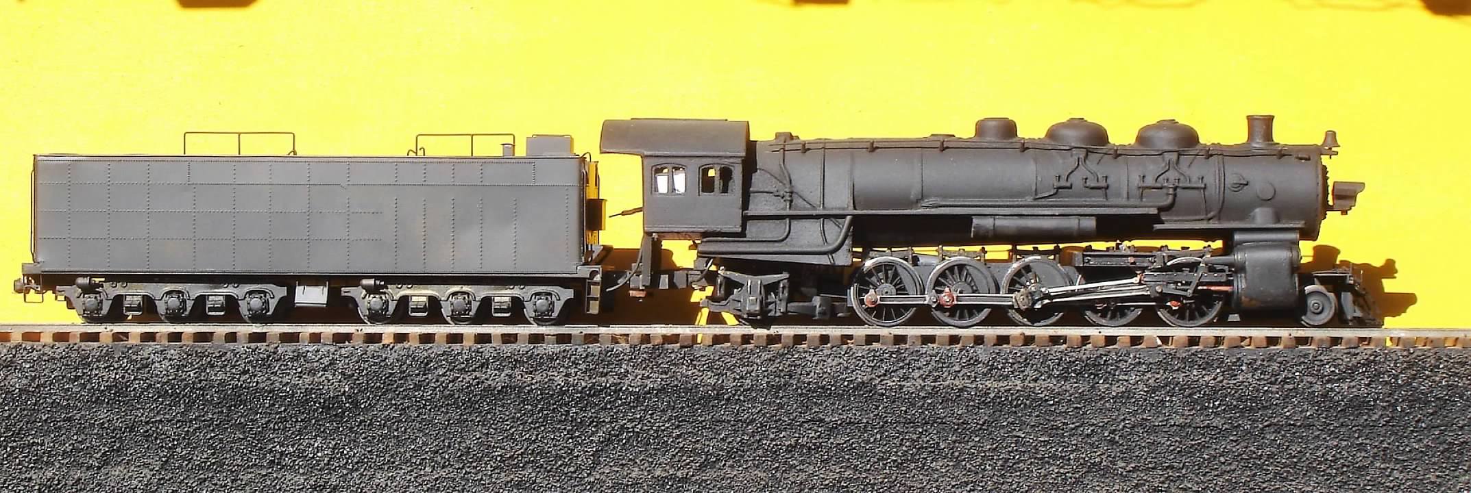

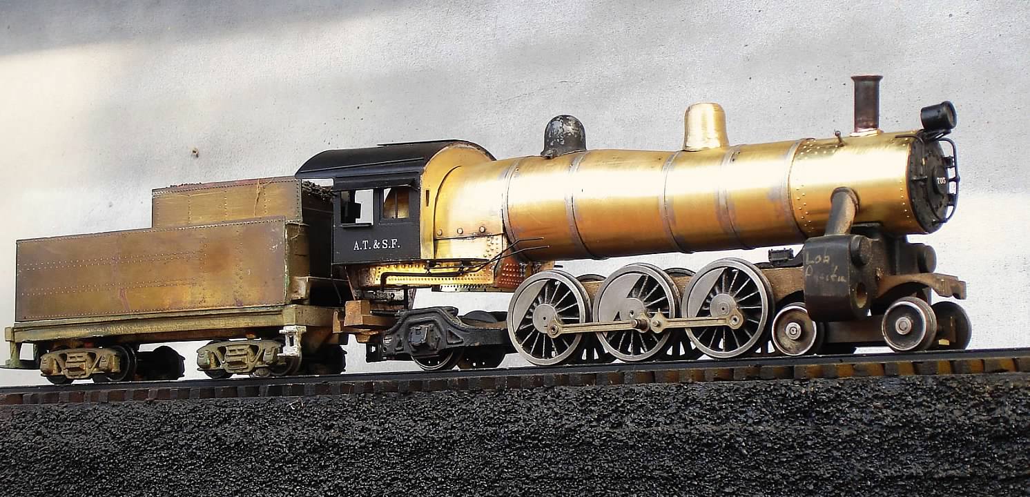

And the 2-10-2 - again Lobaugh frames. I believe all of these are operable, but it has been a while, so maybe a little lubrication? And paint! It is time to find some rattle can black.
Again a screwdriver and two screws, and voila:
Yeah, this one is unpowered, and needs some work. If another boiler shows up, you can bet I will finish it. And one of these days I will do that standard ATSF six axle tender that Scale Craft so poorly attempted. I can see the brass sheet from here.

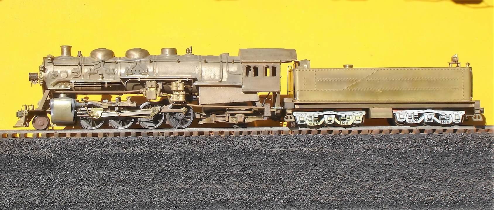

Jim is sending that boiler, and as of right now it is slated for the Mountain mechanism, which could use my attention anyway for rods and crossheads. My reasoning is only this: I cannot find a photo of an ATSF Pacific with exactly those sand domes - nor could I find a photo of any ATSF Pacific with the more or less standard Box Pok drivers shown here:

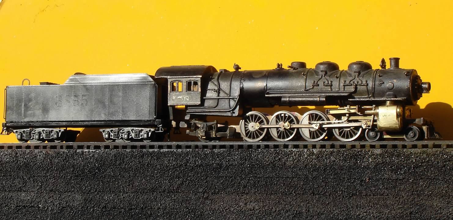

I am repeating this photo on the off chance that a forumite might uncover an ATSF Pacific photo that sort of tracks this model. As it is now, the mechanism is under an All Nation boiler, and is (was) doing yeoman duties on my loop - a smooth runner. It will become "KATY" - because that is the only road for which I could find a Pacific (unstreamlined) with Box Pok drivers of this type.
The Mountain (and 2-10-2, of course) requires a 1 1/2" boiler extension - as I recall, it goes immediately ahead of the firebox throat sheet. The prototype will be #3700, as shown on p. 295 of the Worley book. That will not include yellow rods and gear. Note that, as with the 2-10-2s, the boilers of the Mountains seem to range from abrupt tapers to the more gentle taper found on the Scale Craft casting.
As an aside, I have found variations of this type on the PRR Mountain types as well - my preference is for the more graceful tapers.

I managed to get a used copy of the Shade Tree ATSF 2-10-2 book, and can find no examples of a 3850 class 2-10-2 (or indeed a 3700-class Mountain) with the huge rectangular tender I show above. I am about to assume that, while I like the looks of that giant tender, I may have to build two of the slightly smaller more conventional shape tenders that came with these locomotives.
The big book (Worley) does say that extra rectangular tenders were ordered and used behind various classes, but alas, no photo evidence.
I did get Maroon's boiler extended and bolted to the Mountain mechanism. I now await the resurgence of small square brass stock to widen the running boards. K&S tells me their supplier is not forthcoming. As I recall, it takes 3/32 square to do the job.
Tender is just a spare Berk tender - the ATSF version is larger, with really long Commonwealth trucks.

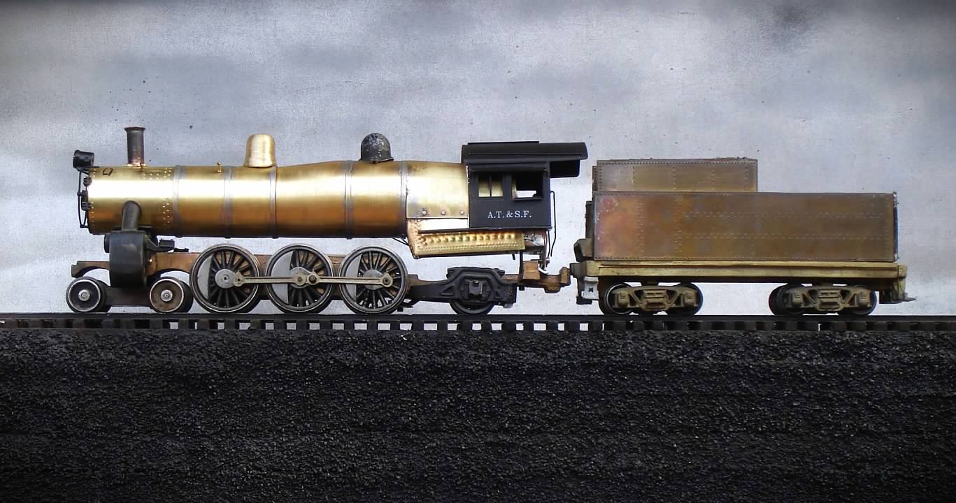

I cannot post an ATSF photo, but here is the Lobaugh B&O Pacific - a very rare prewar model, although the mechanism was used for countless postwar Pacifics closely approximating the USRA light.
If we could find one of these boilers, it would be almost perfect for the earlier ATSF 1200 series Pacifics.

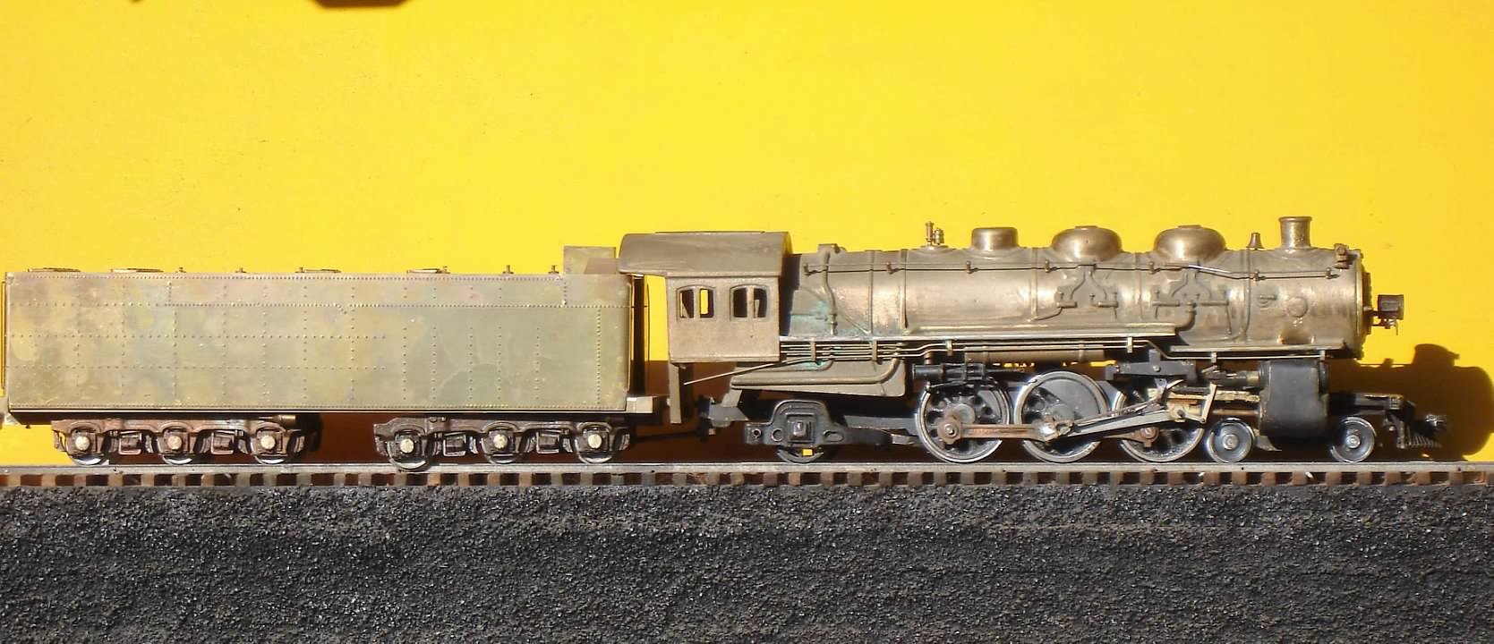

Here it is - it now has handrail posts, but I did not capture an image after I installed them. I tapped the 0-80 holes with my remaining good 0-8- tap, which broke at about the halfway point, then commenced with the Microfasteners tap, which simply wouldn't start in the #56 hole. I re-ground it to a pretty good taper, and tapped the rest. As noted in another post, turns out the tap was oversize - the 0-80 posts were lost in the hole.
So, using good old Lobaugh slotted posts and steel wire, I soldered half of them in. Looks a bit better now - but these photos give you the flavor:

And my broadside - the way I photograph most of my models:
The drawings and photos show the ATSF Pacific to be lower on the frame, such that the top of the drivers meet the bottom of the boiler in a side view.
SW is using a different mechanism, so I didn't cut mine - although there is something strange about my mechanism (look at the space over the lead truck). I may have to take a closer look, after I ship this boiler.
Oh - don't pay any attention to domes and stack. They are out of my junk box. The stack is just a cut off brake line. SW will get good parts from Stevenson.
