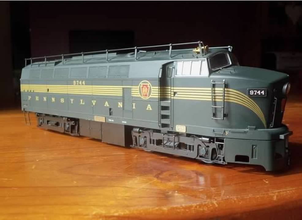

Image I like that Lionel got the Trucks right. I two railed it and lowered it.

.... I like that Lionel got the Trucks right. I two railed it and lowered it.
Me too Stephen, certainly looks as good some of the brass versions I've seen. What was the process for two railing this?
Likewise how much "surgery" did you have to perform to lower the bolster/car body?
Nice model, wow!

steamaheadstephen59 wrote: I like that Lionel got the Trucks right. I two railed it and lowered it.
Really nice job. Was the horn really a bronze color on the prototype? Not calling it out as an issue, but looks pretty cool if it was.

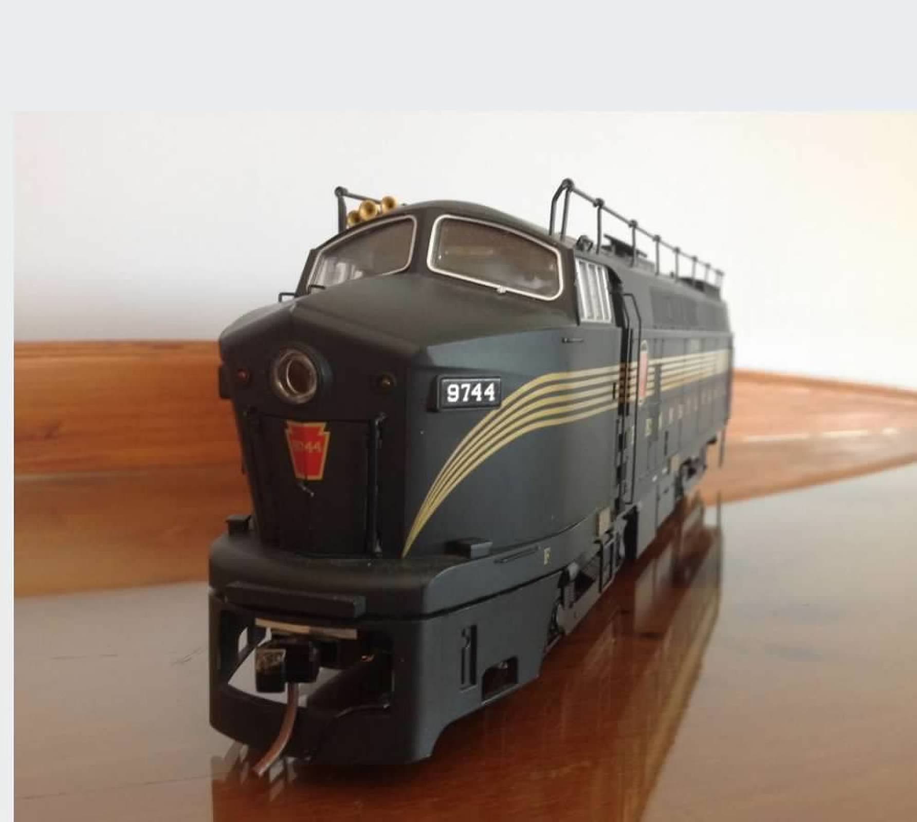

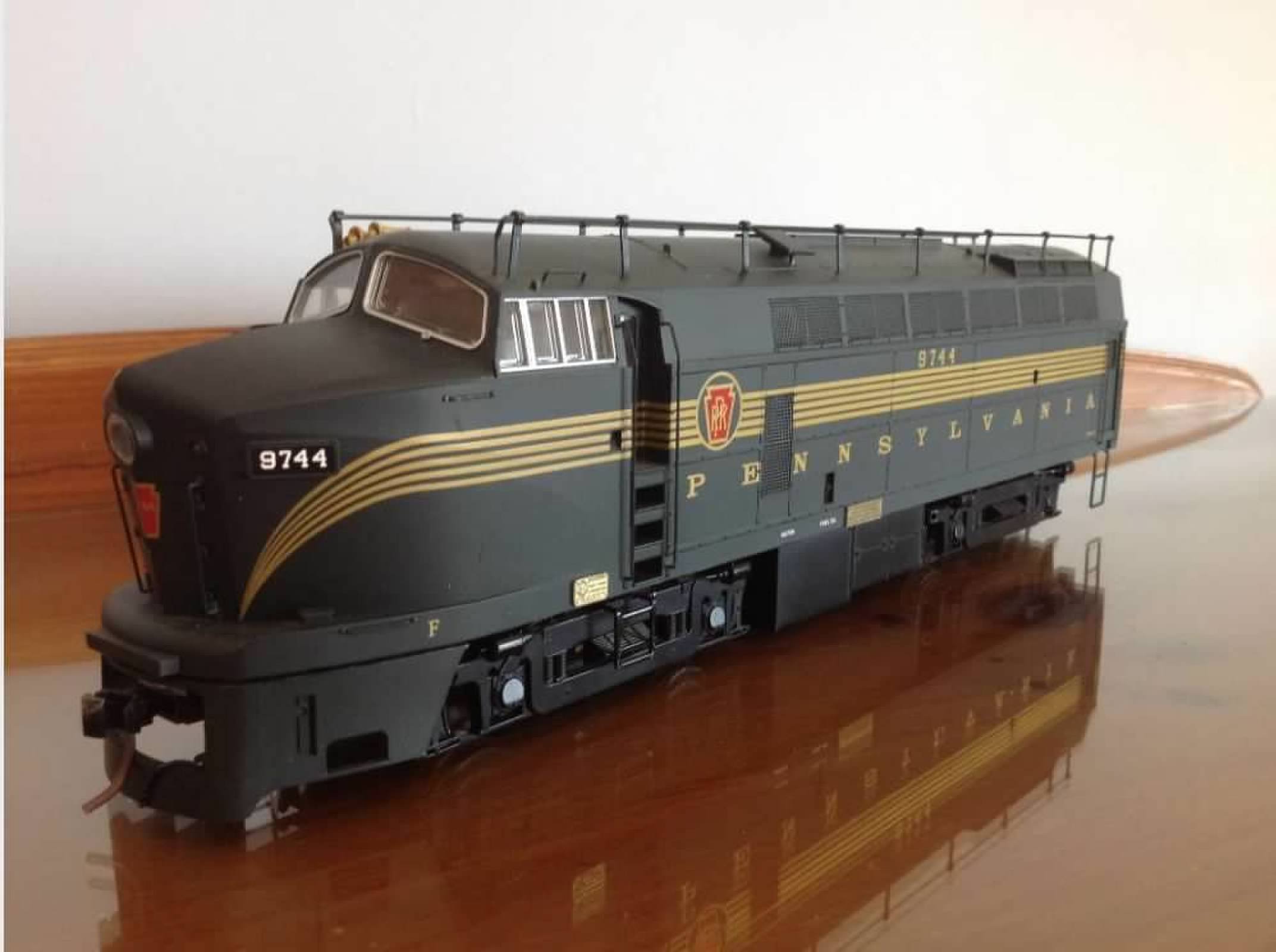

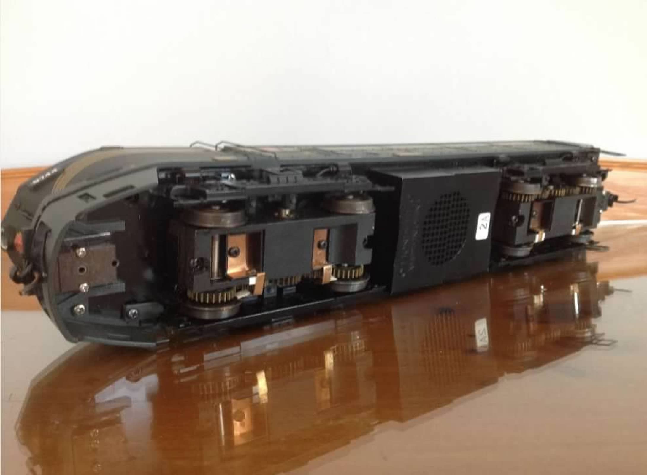

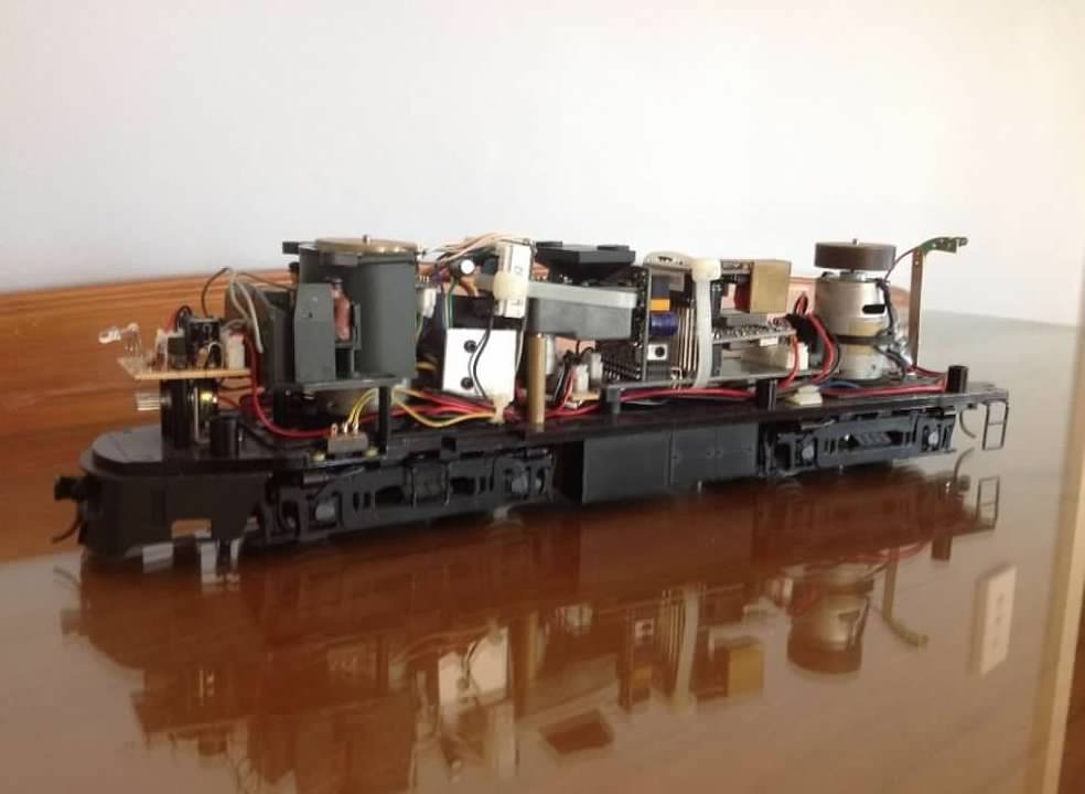

Image Image Image Image
More Pictures can't remember how I lowered it, its not hard, just fiddley. On the other form I think a member was doing a Shark and I got the general idea, and Id done an MTH SD70ACE and its pretty much the same ( lowering the model ) P&D provided the wheels (Weaver) I used the original axles, and had to bore the wheel accordingly, as I remember.

That's some pretty clever "fiddling" there, again looks great! I also like the more accurate(longer) sized tank/battery box over the FA sets.
Did it come as an AB or AA set?
