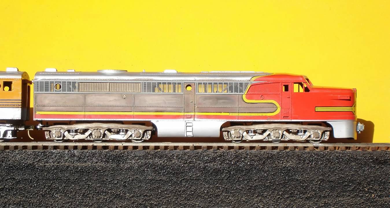

Here is the one Dennis did for me - nickel silver, and in two pieces. The joint is just ahead of the middle door, and I think we added a piece of styrene to make up for the shrinkage. As you can see, the detail was copied exactly.
The Santa Fe plated the sides of some of their Diesels with stainless, so I chose to simulate that with polished nickel silver. Not great - I think the Alclad II is a better idea for stainless.
Also, please do not be too judgey about those trucks - it was my first attempt at really scratchbuilding a complex sideframe master. If I ever have more made, I will put in fake springs and add the brake cylinders to the master before getting the mold made.
But no need - Lionel and others have made truly accurate sideframes for the PA - I believe you can still buy the kit from CLW, and that one was arguably the best ever done in O Scale (except maybe Key).
