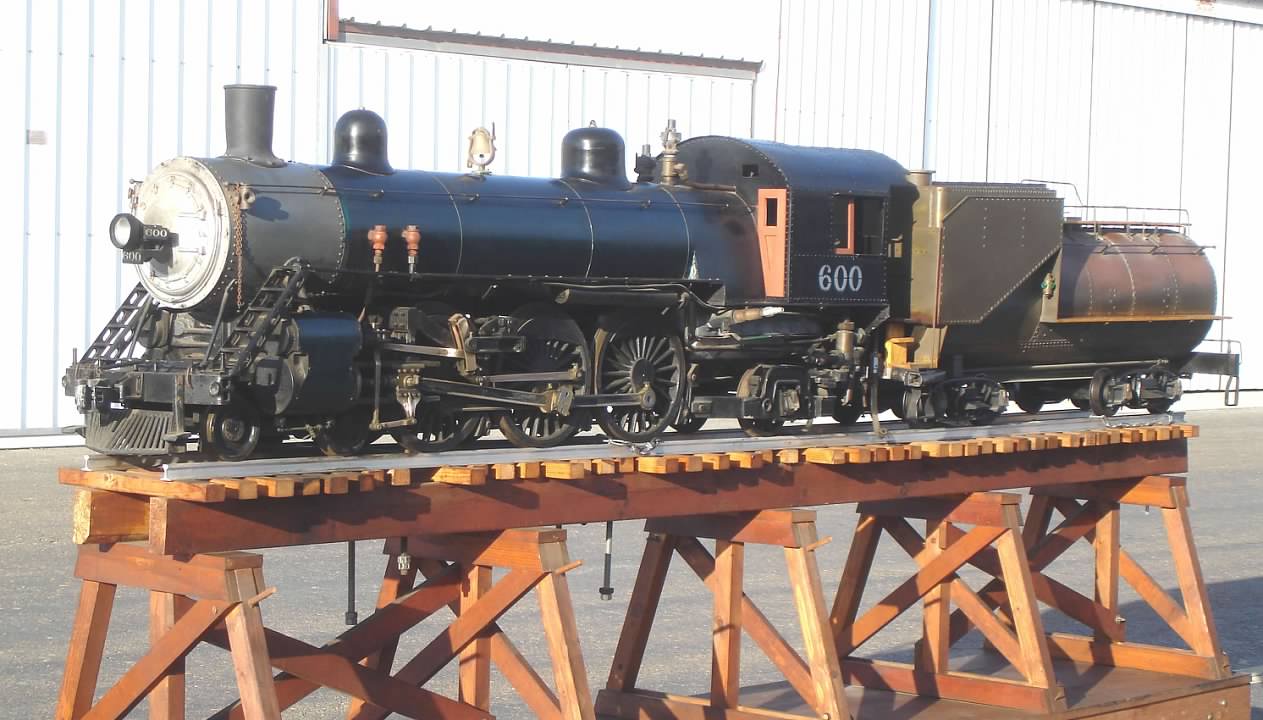

1.6" scale, 7 1/2" gauge. I owned this beauty for almost a quarter century. Had the boiler off for a new dry tube, straightened the tailbeam with Helicoil inserts, made a new cab, raised the domes and stack, and had great plans to run it. That didn't work; like airplanes and sailboats, operating one of these is a skill that develops over many weekends of effort and failure. I did run it under steam on a test track.
Tender is .032 brass, riveted with brass pins driven with a surplus Boeing rivet gun. As close as I could get to an SP prototype without actually counting rivets. Sold it several years ago, and really don't miss it all that much. Way too big.

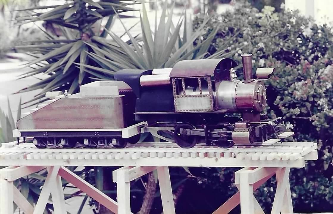

Carey just got a new Live Steamer - it is a 17/64 scale LE Northern. I think I shall encourage him to post here, so in the meantime I scanned my Little Engines Camelback, enhanced the scan a bit, and herewith:
This is from a while ago - it was running on air after about a half century of me trying to pretend to be a machinist. It is a bit further along, and the tender is now behind a Puryear/LE 0-6-0, which is probably above. I will get some more recent photos this spring in the digital camera.
Carey - your turn!
