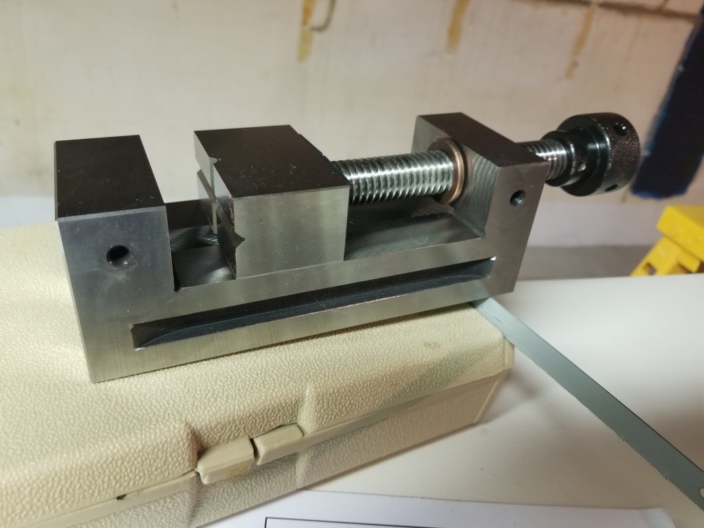

I ended up taking the vise apart to wipe it down. It was actually a simple job. But it's a good thing, because there was a fair amount of degreaser underneath the movable jaw and behind the various plates and screws. I re-oiled and it's ready to go.
