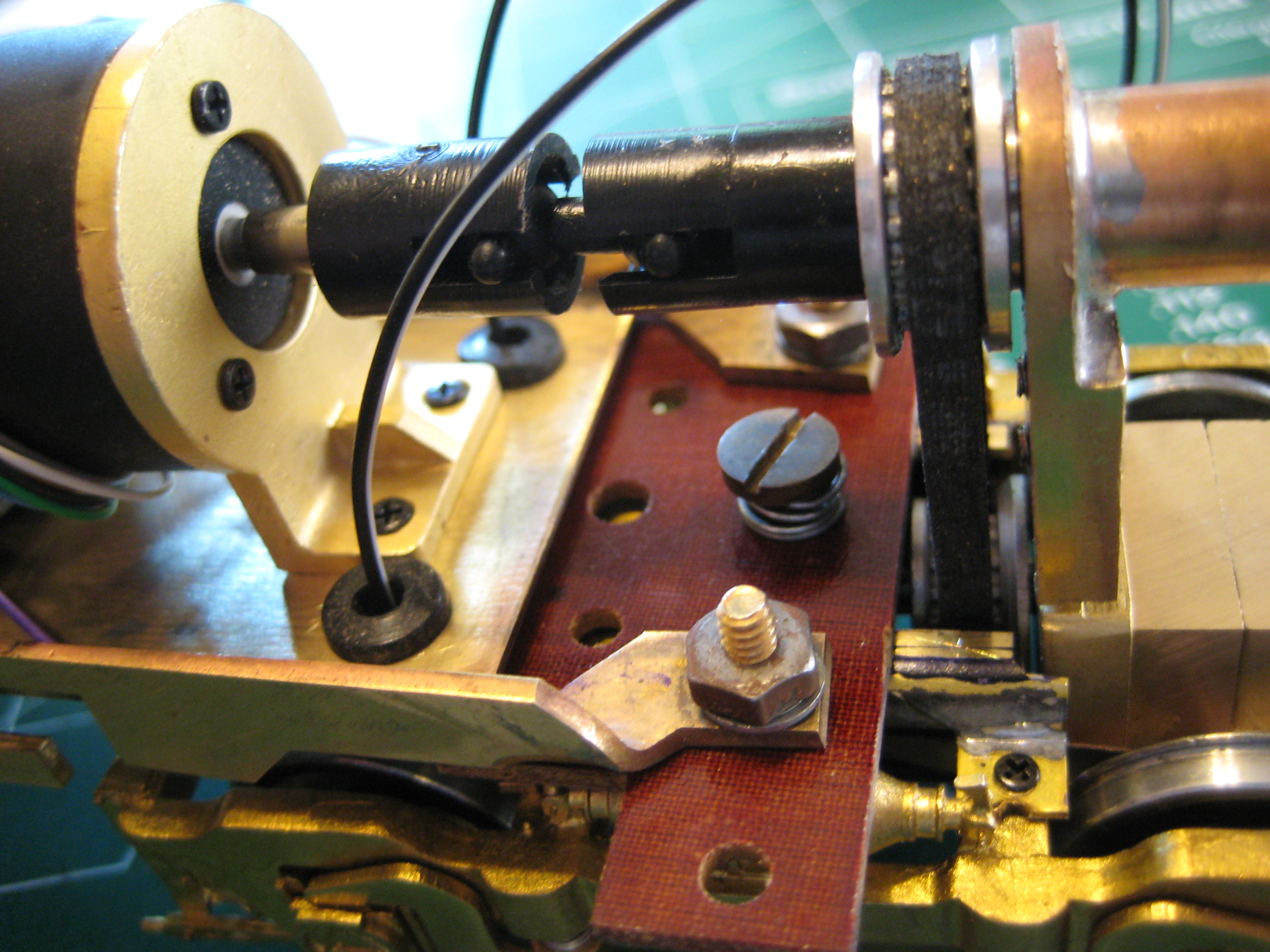

A friend asked me about installing one of my light duty (switching) drives into an All-Nation NW-2, owned by a friend of his...so, a friend of a friend. Anyway, all he had was the body but I had frames and, other required parts. In my collection of old A-N parts I found some brass frames and since I wanted to install a floor the seemed like the right way to go. Carl Jackson provided the OMI trucks (the originals were just too crude). The model was to be P:48, with a sound decoder. Seemed like a fun challenge so I went for it. I had some TCS WOW decoders (HO) with keep alives in stock so we used one for this project. We also planned to use a Tang Band speaker but it just wouldn't fit. It hindered the truck rotation. We might have been able to install the speaker inside the shell but I feared the die cast body would really impair the sound. I wanted to mount the speaker below the frame where it's pretty much hidden by the fake fuel tank. The mechanism used two 2619 Faulhaber gear head motors. Running at top speed, while holding the model in place, and allowing the wheels to slip, the whole thing draws 0.020 amps. Yep, the HO decoder will be just fine. Customer will just have front and rear lights so I installed two MiniaTronics 2 conductor plugs and wired one end to the wire termination blocks. The incandescent lights are 18 volt so no need for resistors. The remainder of the drive uses my ball bearing gearboxes, axles, and P:48 wheels. Wiper mounts are screwed to the new, narrowed, truck bolsters and are machined from Delrin. Wipers themselves come from Rod Miller. Oh yeah, it runs really well and sounds good too.

Jay, that's beautiful!
Re: All-Nation oddity
Posted: Sat Apr 13, 2019 12:48 pm
by bob turner
Yeah - work of art.
Posted: Sat Apr 13, 2019 1:05 pm
by 2railjon
Awesome, Jay!
