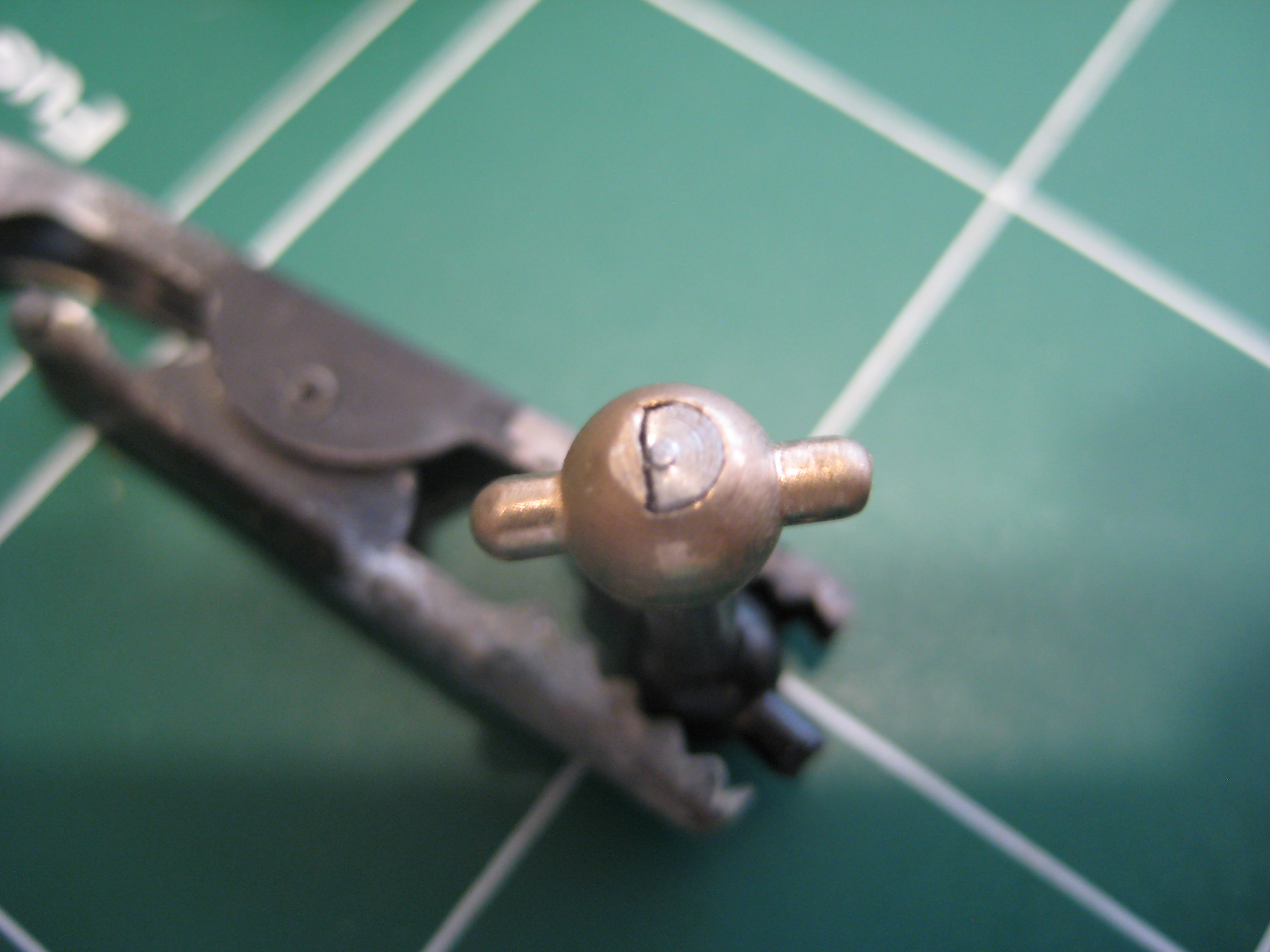

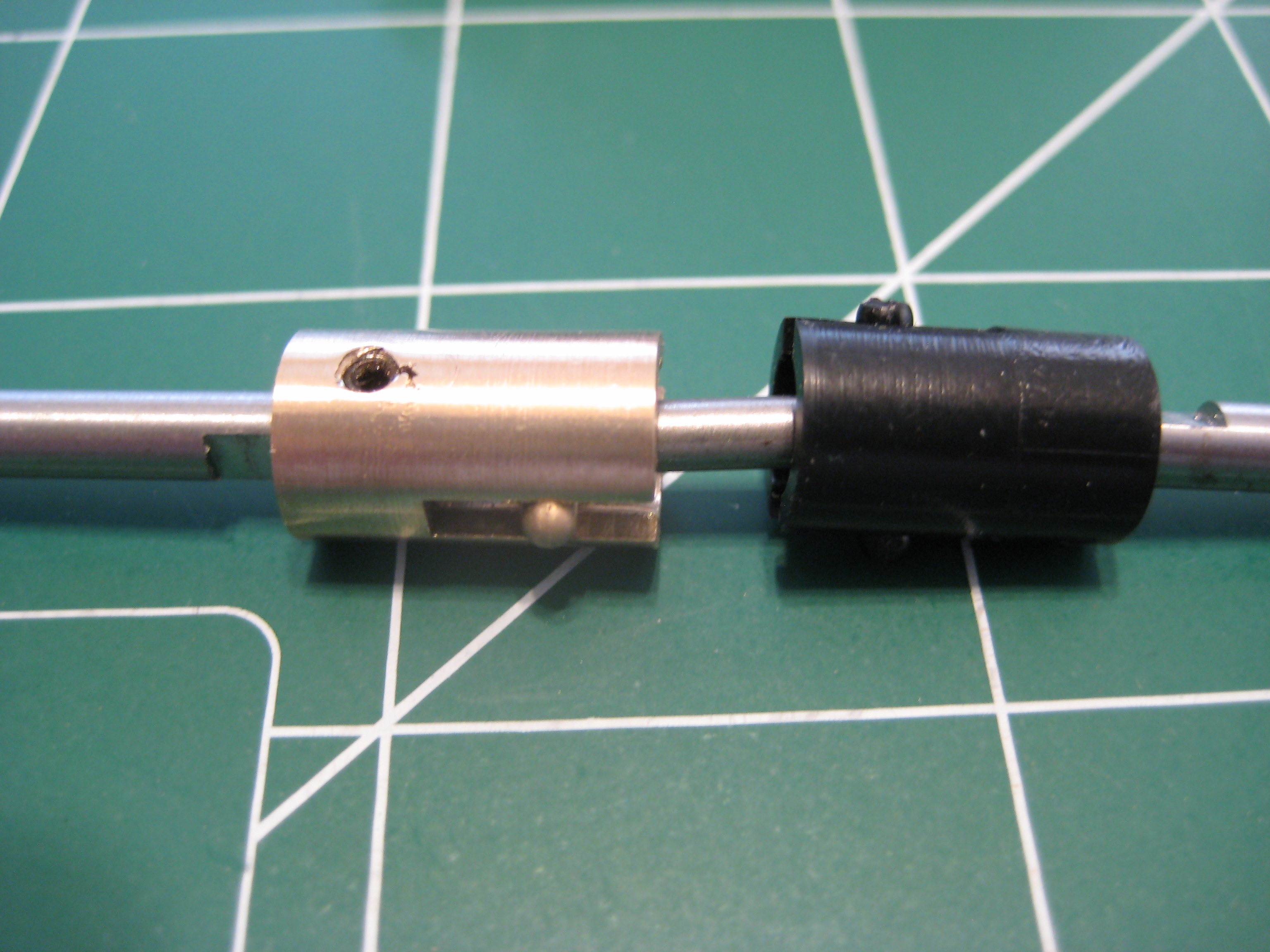

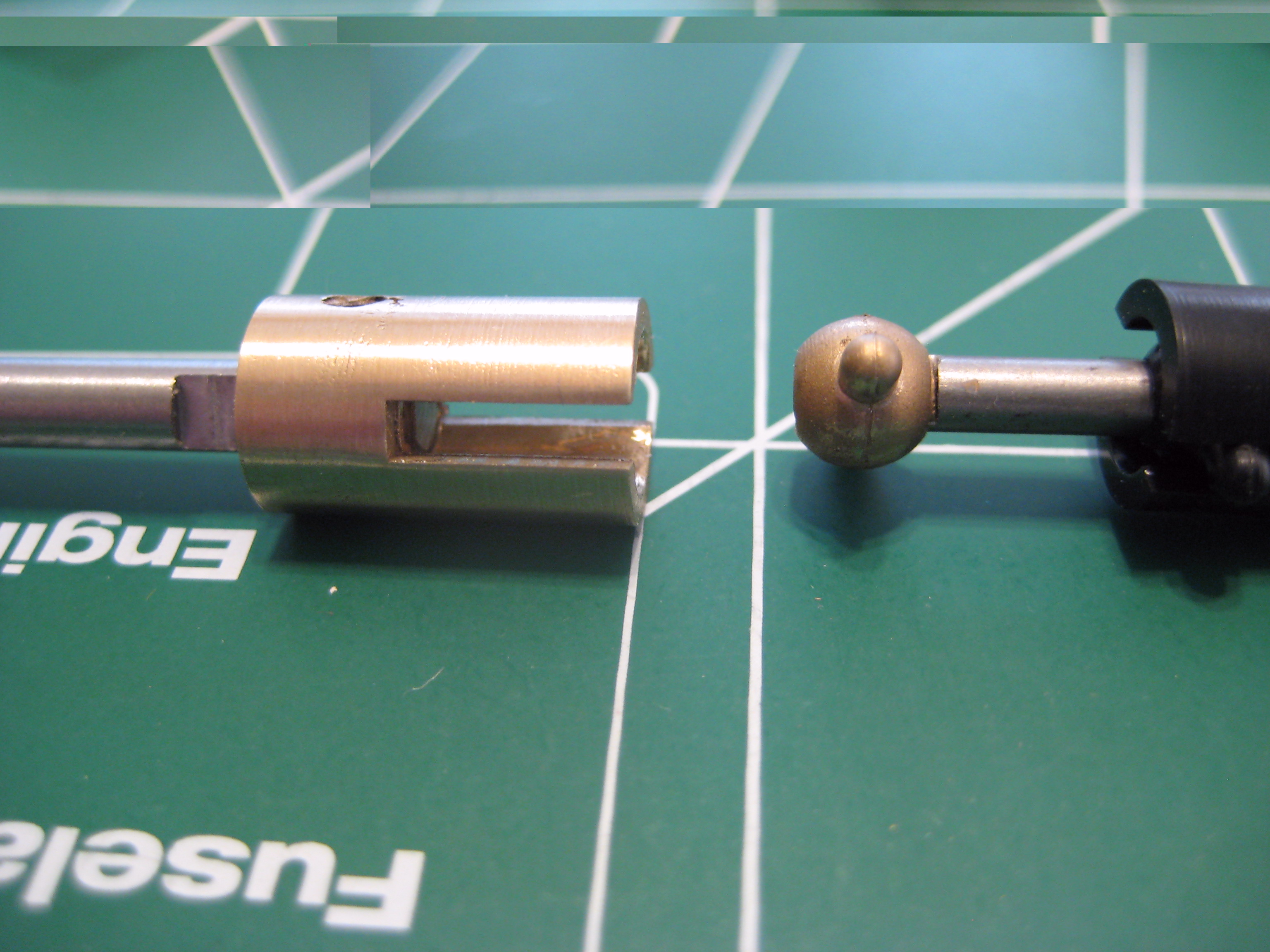

Good day at the foundry. When I build my drives, for light to medium weight diesels or electrics, I use the dog bone and sockets NWSL offers in Delrin. They work fine but I only use the 5/32" (4mm) socket. The set also comes with a !/8 socket that I have little use for. I decided to have the surplus 1/8" parts burned out and cast in bronze This will allow me to use these for all drives, including the heavy models. Bronze will hold up far better than brass. The reduced RPMs my drives provide should mean little wear. Biggest mistake I made was not boring them to roughly the needed size, prior to casting. Much easier to do plastic instead of bronze.
Next we're going to try casting up some of the sprockets like the ones used in the Weaver/CLW drives. Will eliminate splitting, set screws will be easy to install, and LocTite will work also. Probably have to polish them in my tumbler prior to use. The slightest nick or flaw would probably destroy the delrin chain in no time. Should be a fun experiment.

There is no mold. It is what's called a direct burnout. Think lost plastic.. One plastic part becomes one brass, aluminum, or in this case bronze part.

Looking like it might just work out.
- 2018-08-10 004.JPG (1.12 MiB) Viewed 5724 times
- 2018-08-10 002.JPG (1.22 MiB) Viewed 5724 times
- 2018-08-10 001.JPG (1.18 MiB) Viewed 5724 times
