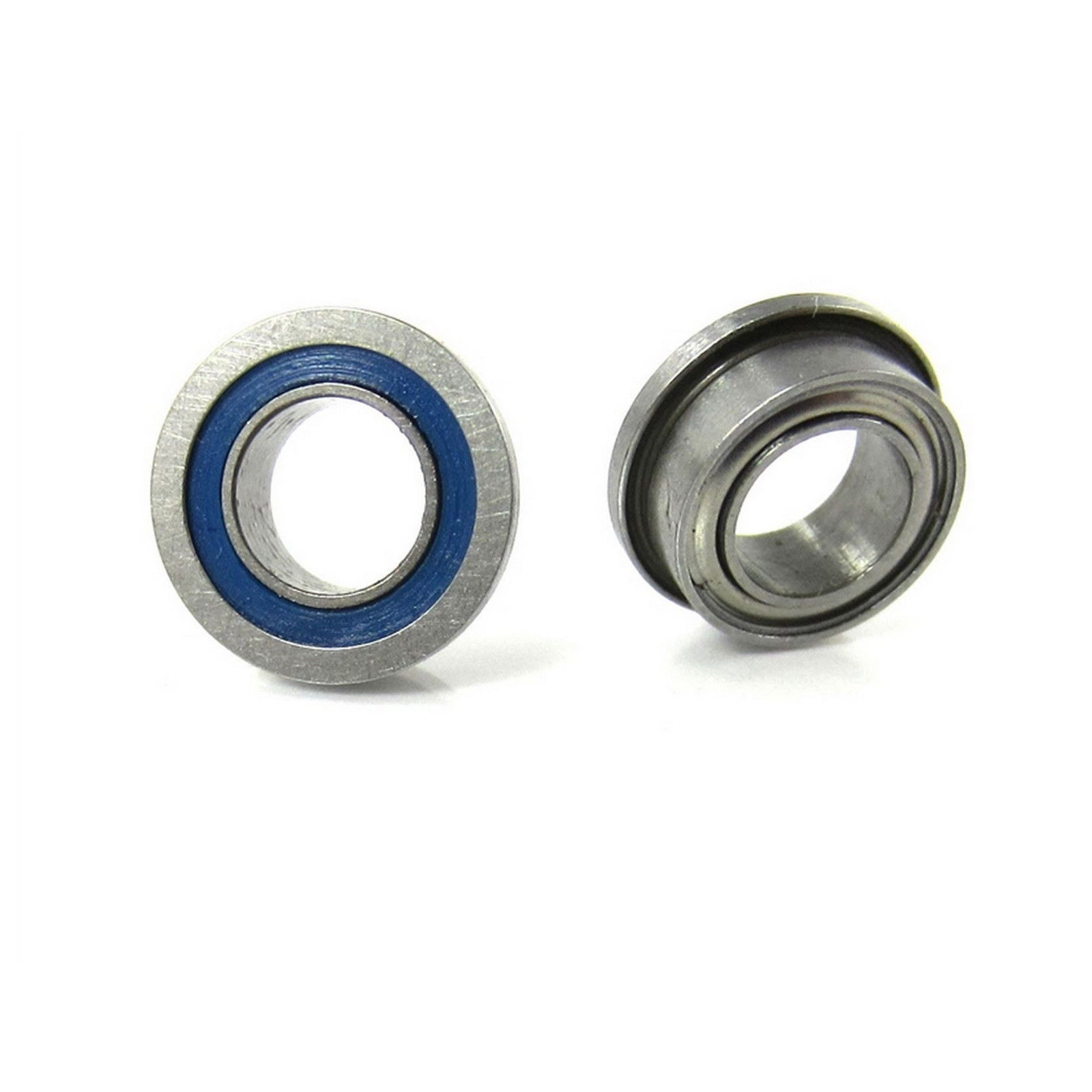

I've got a few of these beasts and been digging into two of the three. I've got both the center drive and the rear axle drive. Right now I'm focusing on the most recent one which came with what I think are Lobaugh Boxpok drivers. I realize I may be very wrong about that source, but so far that's my best guess. I've curious to see if you all can get me squared away on that driver source. Also looks like the builder did use the 1/4" dia axles in the frame turned down to 3/16ths for the wheels, also look like the little keys are present for quartering. Honestly I don't really mind them and will keep them on the loco for now. However, in the future, I'd like the install some more correct PRR drivers. At this point I think I've got the valve gear straightened out so that it is good and smooth. Right now the thing that is annoying me is the noise coming from the angle drive bearing block. As you guys know, the stub end of the worm shaft rides on a ball bearing and in the bronze block. The top (motor) end also rides in the block. Couple of things I noticed. 1) That top end bearing is sloppy, 2) The tee pin on the motor shaft was originally too long or wide so to speak and as such as been dragging on the inner surface of that block as the motor shaft spun. Filing the pin down so it no longer rubbed was easy. that actually quieted things quite a bit. It is probably fine as is but I am interested in improving things further. So at this point, the question is have any of you installed a ball bearing on the top end of that worm drive block. I've found a 3/16ths ID 5/16ths OD plus a shoulder. I think that would completely solve problem. Taking that a step further, it looks like I could similarly install the 1/4" ID version of the same bearings on the axles. The frame casting is thick enough and tall enough to accept the necessary machining operation. What are your thoughts? Obviously, I don't want to trash it but I don't think it will be that bad to work through either. I should be able to set the frame up on my lathe tool post for the axle bores and locate that way. For the bearing block since it is on an angle, I was thinking of using a spotface cutter if I could find the right diameters. I just wanted to bounce the idea and see what experience or ideas you all might have before I make some chips.

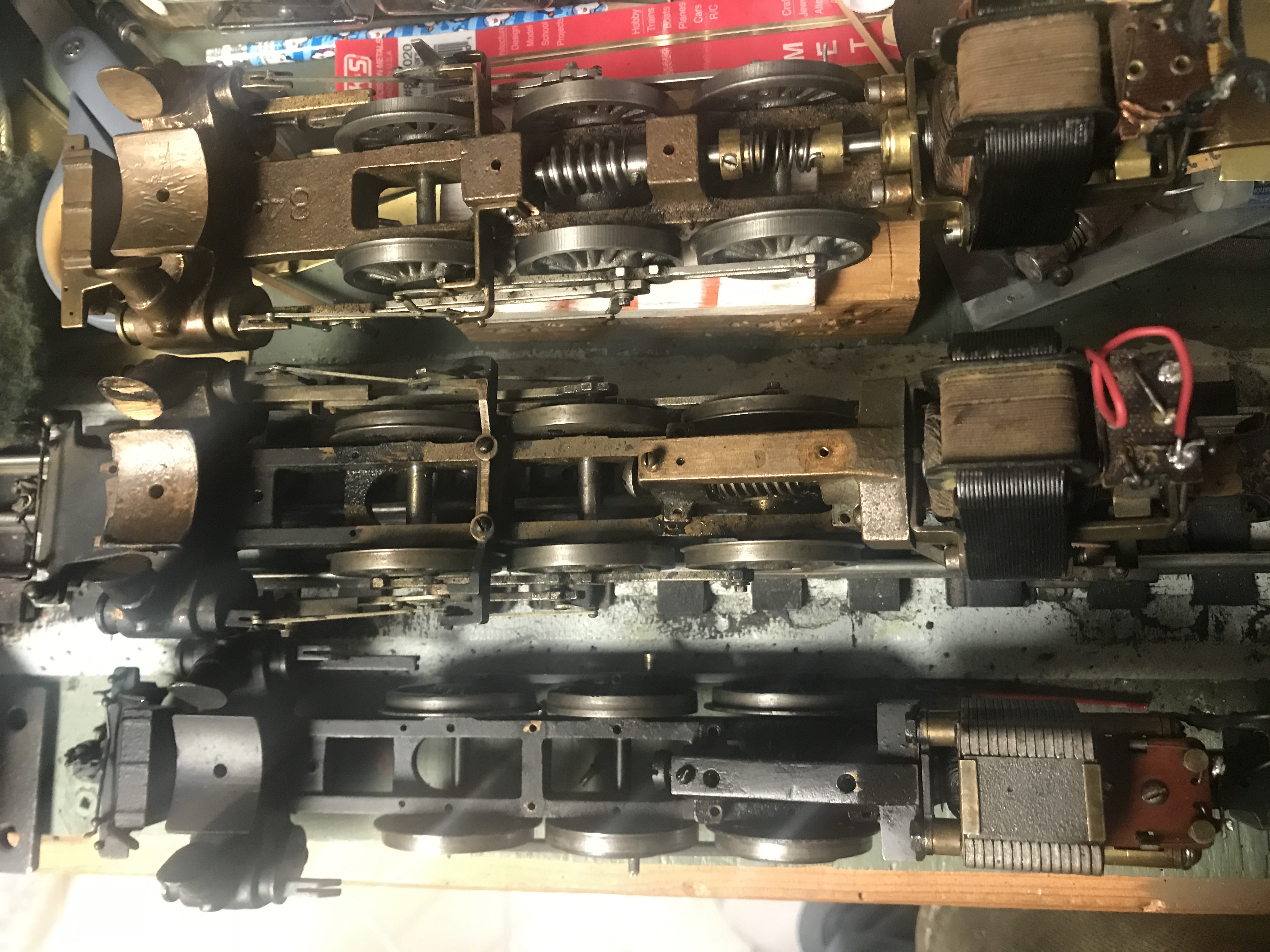

While I'm at it, here are the starting points for these. The first one I got was in pieces with the frame built up. I'm not sure if it was a factory built up frame or not. One thing I notice is that the motor mounting holes place the motor shaft considerably lower than the worm gear shaft centerline which puts the spring drive under a bit of a bind. The Toyota hose would probably help that but raising the motor up would as well. I'll get some hose and check that out though. It has the stock SC Cresent drivers like most of them and not 2 railed as far as I can tell.
The next was this all black one with rear axle drive. It was two railed and came with a Permag motor. It did run but was rough with some binding. The wheels were machined all over the place, with some being .020" wider than others the gauge was all jacked up. It has straight counterweight drivers, but only 15 spoke and they were machined to 1.603" or so which is a good bit short of a scale 80". The tires and flanges are all out of whack to each other as well. I think can save them but they might just be an experiment. The boiler to firebox joint isn't too bad but not too good either. I'll probably just leave it as is for now... It needs some paint though.
Last is this new one with the Lobaugh drivers. It was complete but had a bit of binding in the valve gear. Work in progress I guess.

Elongate the motor mount holes and straighten the drive shaft. Original motor and coupling will give you excellent service - a Pittman/ Toyota hose will make it slightly quieter and snoother. The can motor can be mounted in a tray using old rubber sheets and aircraft safety wire. My trays are just leftover segments of old boiler material.
Scalecraft made both types of drivers - the SP and NYC got the crescent counterweights. A Dremel tool and a very steady hand will convert the counterweights.
Yes - closer to 17/64. The SP was seriously oversize. Tender was closer to 1/4" scale.
