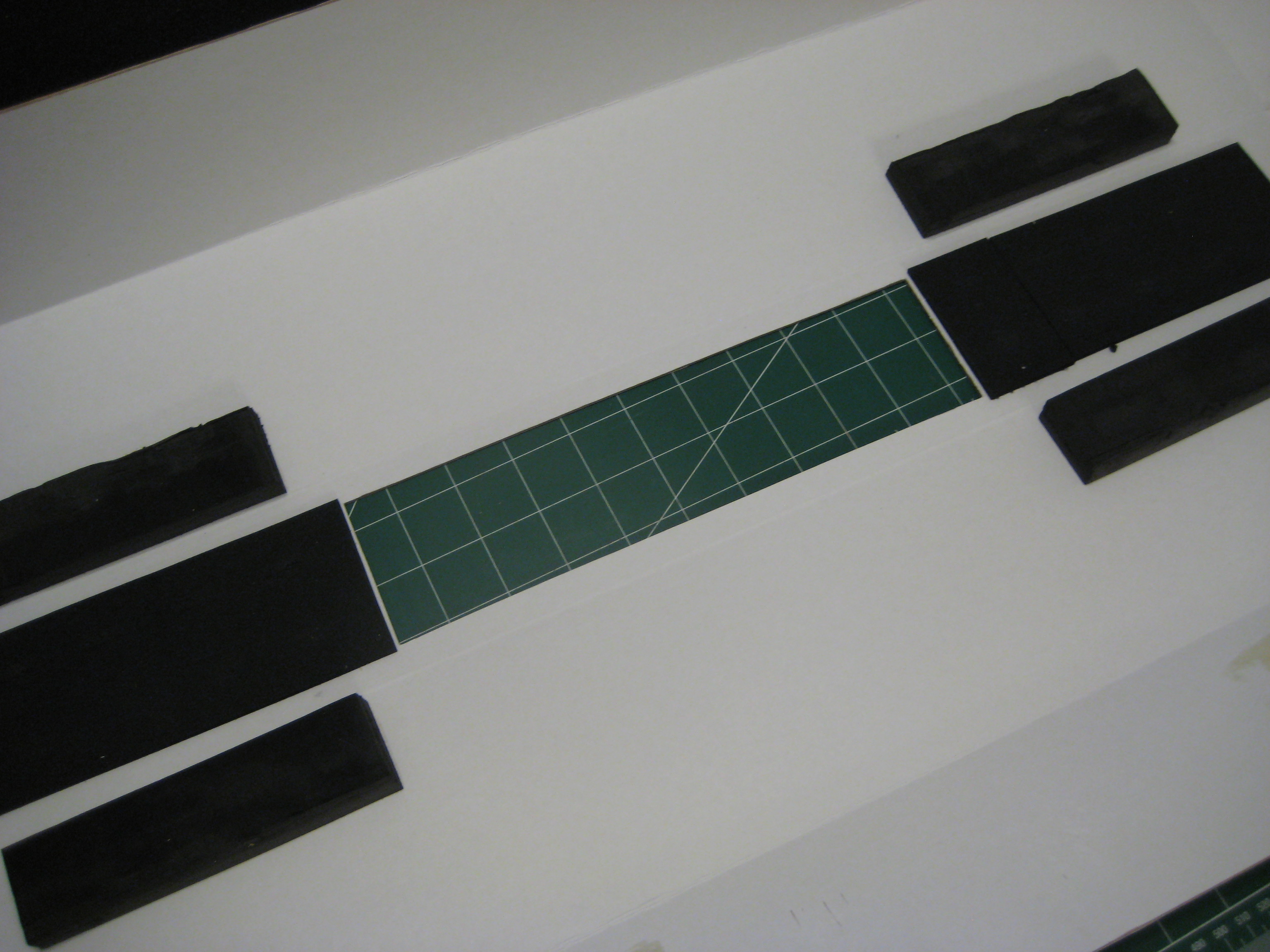

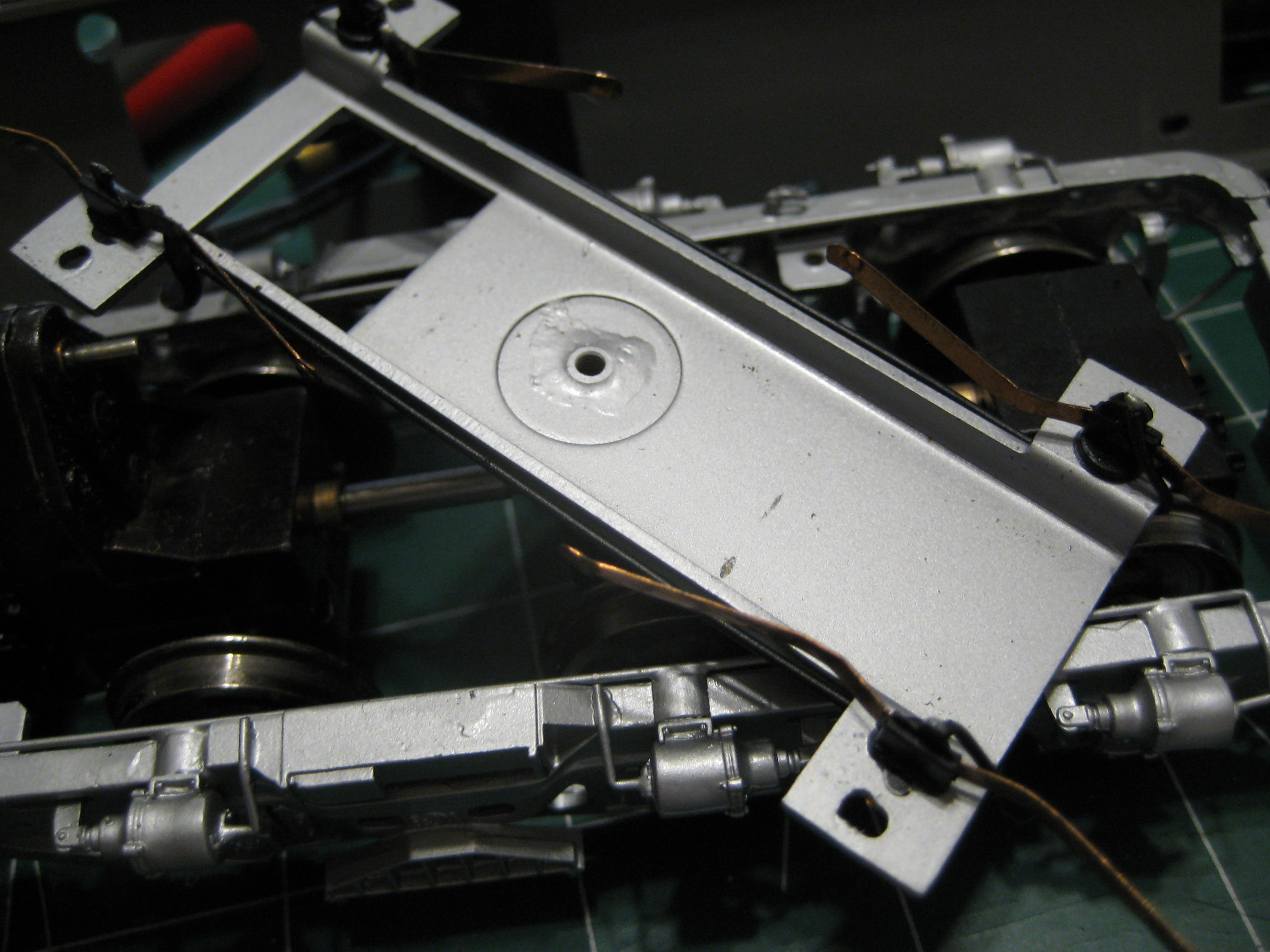

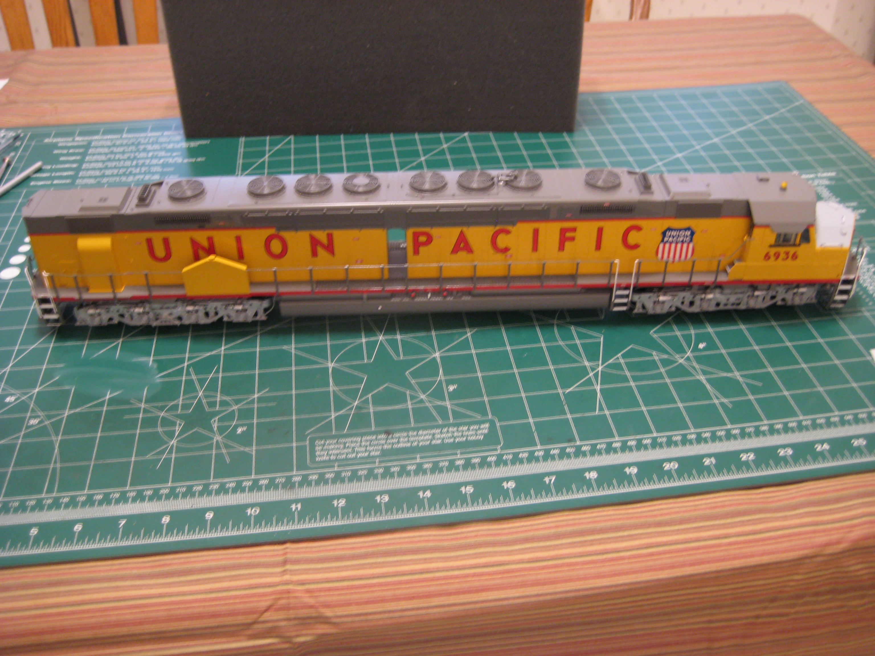

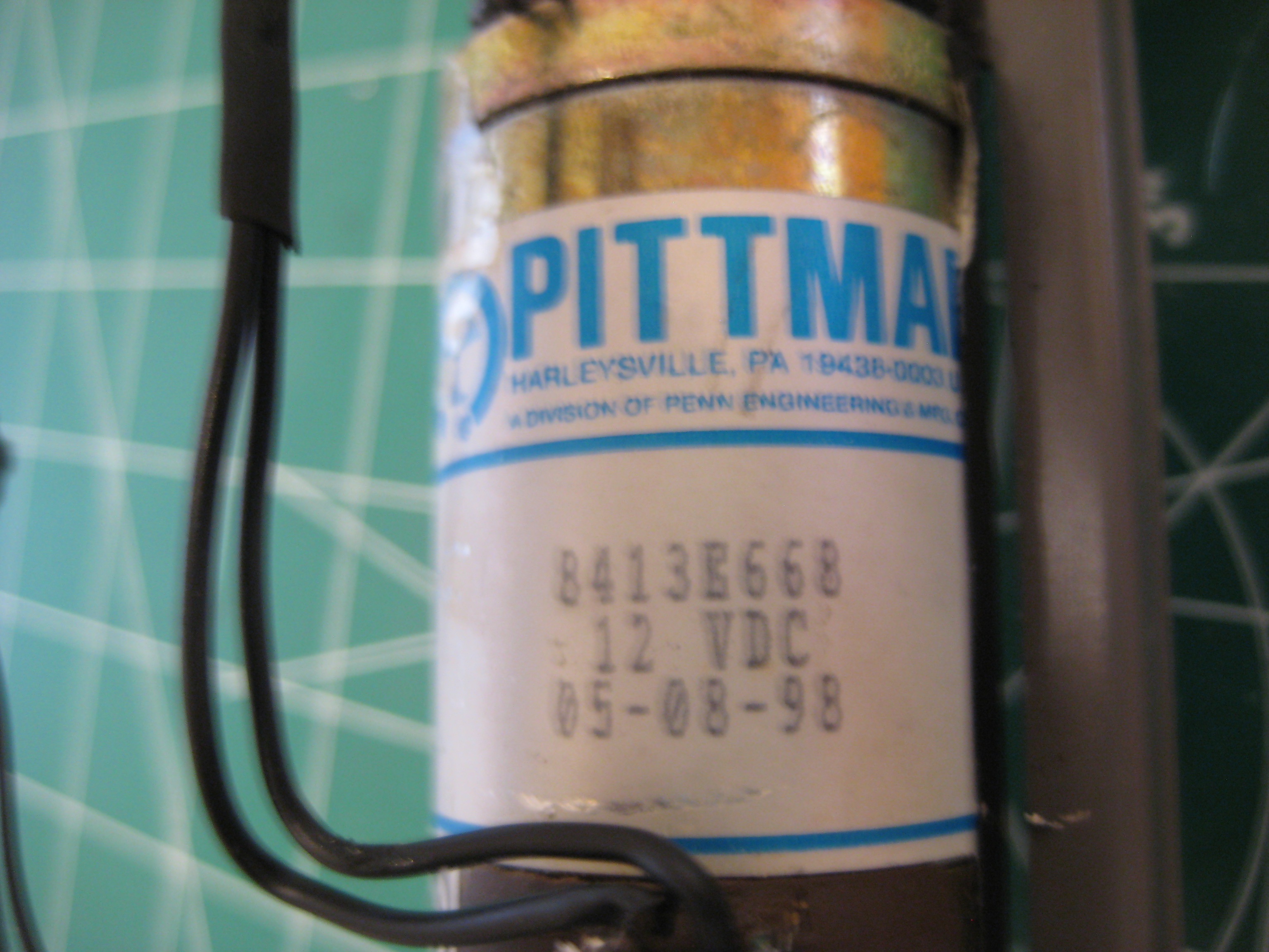

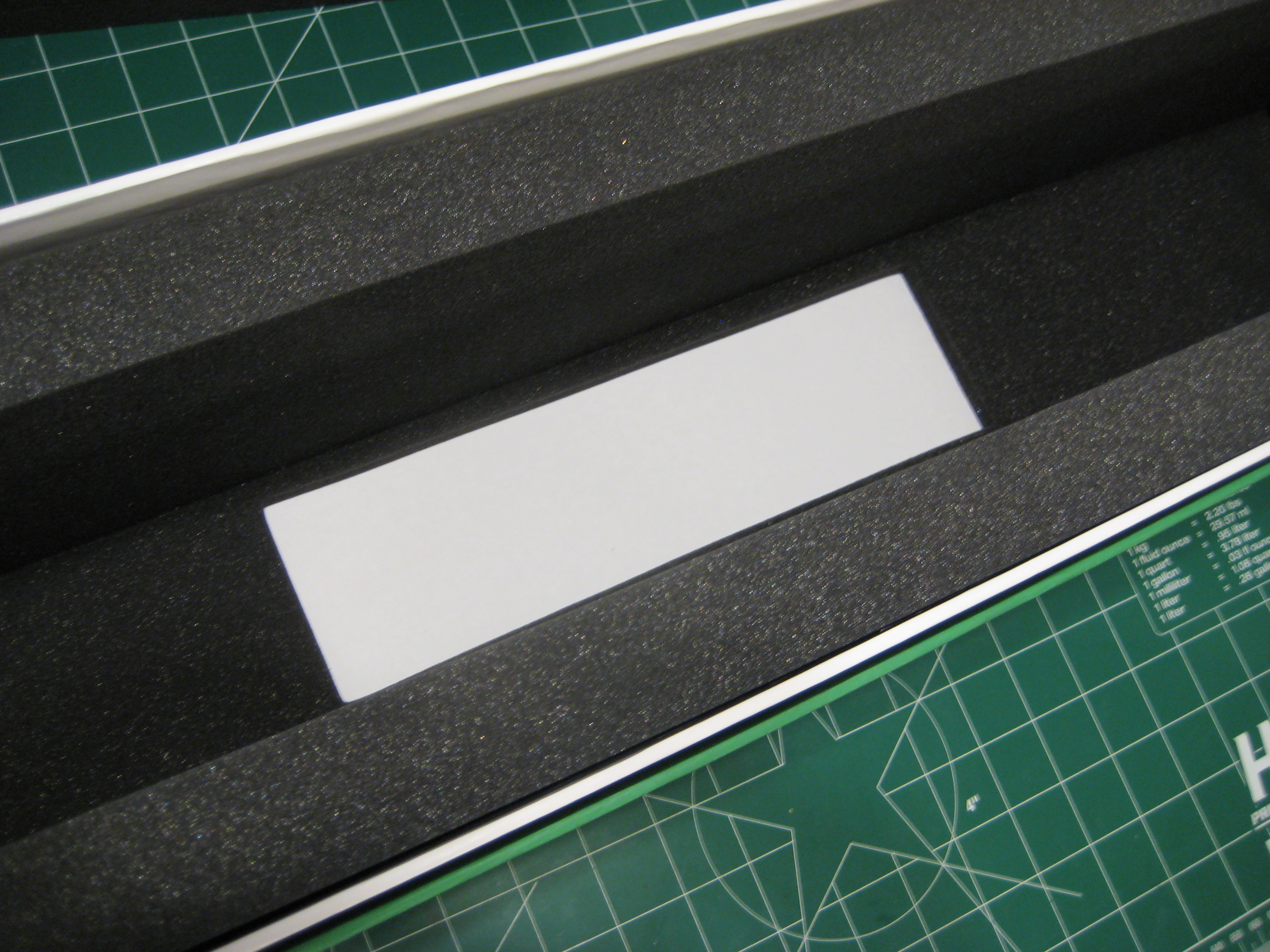

Re: Bad Overland drives, total write-offs?
Double "D" back together.
Absolutely all the weight on the wheels and zero support of the fuel tank. I submit, this is another case of damage during shipping. Not really the sellers fault. I consider it poor packaging from OMI. Any shock is transmitted directly to the wheels and then to the axles and their journals. Besides poor design of the factory packaging the formed brass bolsters become the next weak link. They flex and the axles pop out of the journals.
When I ship this model back you can be sure the fuel tank will take the majority of the support.
Fairly heavy formed bolster.
Twin cheaper Pittman motors
Factory box and packing actually showing a cutout for the fuel tank
Assembled model
Assembled model
Jay, what is this model? Almost looks like a "B" for the OMI turbine. The only issues I've ever had with formed brass bolsters bending (slightly) is on brass trucks that don't have the end stabilizer bars joining the RH and LH side frames. Most OMI models came with these attached, although on early model they can become lost or removed for some reason by previous owners.
