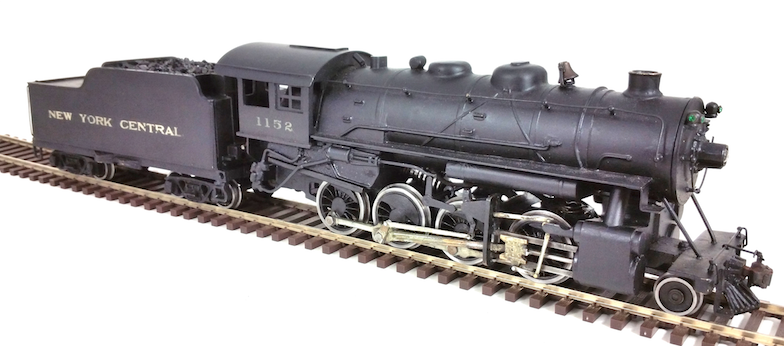

In over 45 years of attending O scale meets I do not believe I have ever seen a Megow loco. Looking at the frame from the underside it looks a lot like an early Hines Lines/Pearce 0-8-0 mechanism prior to the introduction of the Pearce ball bearing gearbox which was a great improvement to these drives. Perhaps Hines purchased the molds from Megow in the late 1940s. Certainly the boiler casting with all of the cast on details is unique to Megow.
Another survivor from the bronze age of O scale! It it were my loco I would install a proper brass pilot on the model. The one on the model now looks like a diecast Varney/All Nation pilot from the B&O Ten Wheeler.
I do not plan on bidding on this.
Joe

I had one here decades ago for rework. I remember it as a lead casting.
Re: This looks like something interesting for discussion
Posted: Sun Oct 22, 2017 1:57 pm
by sarge
I've had a couple through here, a pretty decent model of a NYC G43. Change the wheels out to 63" and you have the G5 and G6, which were pretty common NYC locos. It was also a Alco catalog design, so seen on several other railroads with some cab and furniture differences.
Boiler is cast brass, solid and good runners with little effort.
I believe Jim aka Maroon researched these back to Scale Model Railways, though he can clarify if my memory is flawed. Megow sold many things under their banner, few of which they actually manufactured but many they caused to be manufactured. They were a typical model engineering house of the era, not specific to railroads, ships, aircraft modelling as many are used to today, but more in the earlier mould of suppliers for the entire model engineering community.

A couple of years ago Sarge gave me the contact information for a gentleman who had a nice version of the Scale Model Railways / Megow Consolidation (Thank you, Brian). It is one of the locomotives shown and discussed in part one of my OST column on entry level steam (issue #92) earlier this year. Here is another photo:
SMR-Megow NYC G43 2-8-0.png (342.36 KiB) Viewed 5949 times
The lettering on the cab was done by hand but was preserved when the engine model was repainted. I believe the tender has the original paint but I would have to double check. I had previously noticed that the number on the model in the catalog is the same as the number on my model, but now that I look at it I think maybe it's actually the very same model.
G43 Catalog Shot.png (213.64 KiB) Viewed 5949 times
This model runs very well but is noisy -- the worm is attached directly to the motor shaft and has no support at the tip of the shaft (like the Hines USRA 0-8-0). I have video somewhere but not posted yet. I'll dig it out as time allows.
