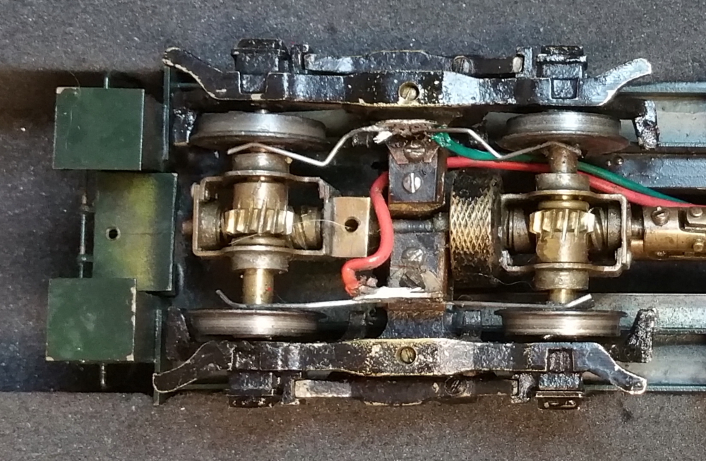

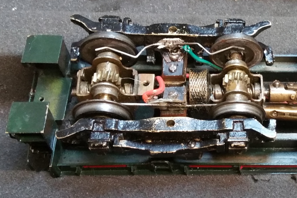

I was asked to look at a locomotive chassis for a friend recently. The chassis appears to be a scratchbuild for an early diesel, as it has cast bronze Blunt truck sideframes on it. The unit is equipped with axle gear boxes as shown:

I have seen these gearboxes before and was surprised to see them here. The gearbox case is made from bent brass and is riveted together. The gears were machined down in thickness from a larger gear. It is not clear why machining was necessary, unless it aids in the assembly perhaps? As it is, I have four pairs of these, all of which came on three-axle Bloomberg trucks for an E-Unit. I have not seen an E-unit with these gearboxes installed. The trucks and gearboxes could have been sold separately but I would guess instead they were original equipment on some model. I have seen most of the old E-unit ever offered, but not all. One guess would be the pre-war B&O EA from Scale Model Railways. I recall that IMP or some other early importer had a PA (not well received and thus rare), so maybe there was an E-unit too. These have the cheap-assembly aspects of a very early import. Having said that, I have to say that this switcher chassis actually runs pretty well.
Any clues? I will dig out the truck assemblies I have with these drives in them when I get a chance and post photos.

I think the E-unit boxes were International. Do not expect longevity out of brass gears.
