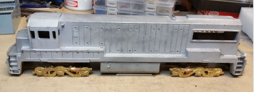

I am working with my brother on a project to build up several Penn-Erie U-boats. Part of this effort led to trying to understand all the different C-trucks that came on these locomotives. Without really trying, I managed to accumulate a good number of different O-scale C-trucks. So here is a survey that could be titled "what have I got and what prototype did they go on".
First, the GE Tri-Mount truck, sitting under a U25C:
The U25C and Phase 1 U28C are the only U-boats to get these trucks. They also were used on the E44 and EL-C/EF-4/E33 electrics. The particular pair of trucks shown are from a House of Duddy model of the New Haven EF-4 (and are borrowed here just for the photo). When I first got started on this I got fooled into thinking that just because these look like the Alco Tri-Mount trucks that they were more-or-less equivalent. Wrong-o:
As can be seen, everything about the GE is larger by a significant amount. Some of you may have noticed my "want to buy" ad on O-Scale Yard Sale for a set of the GE version. This U25C is the target model. I have been advised that Lou Houlemarde may have these available and I will contact him. A set of the one-piece cast aluminum sideframes that Penn-Erie provided with these would also work.

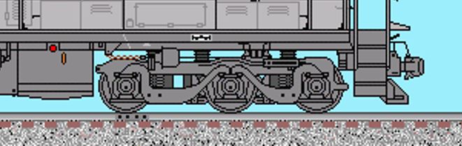

I've always wanted to get a pair of A1A-A1A trucks to make a Seaboard RSC-2 or RSC-3. Here's a good shot of SAL RSC-2 #1541:
I believe they used these engines on areas that had a light rail loading, to help spread out the weight of the engine.
Not sure if these are the same as yours, I do see a bit of variation.

The Commonwealth trimount on Alco was 12' 6" in wheelbase, I believe all the way through the C628 if memory serves.
The GE version for U25c was 13' even, and had a different shape equaliser than the ones done for Alco; a bit more curvaceous.
Commonwealth also made a double-equaliser version, but that isn't germane here. I think BLW used it for one.
The E44 truck was huskier still, thicker cross sections and depths, if I remember, but the wheelbases were still 13' . There might be argument whether they were beefed up from the U25c truck, so a check of primary source would be worthwhile. If my memory is still good, they were and aren't interchangeable on the real thing. Staring at photos, it isn't obvious to me they are different, so either memory is poor or it isn't obvious enough to matter much. I wish Tom Harley was still with us, so I could ring him up; he'd remember.
All that said, be careful using model trucks for comparisons, for there should only be a wheelbase difference of 0.125 between a good model of the commonwealth truck for Alco and for GE. I'm guessing one of those you show is either grossly undersized or grossly oversize, to fill the available space rather than actually replicate the prototype. An example would be the RSD-5's offered over the years that began as RS-3 models can often have a undersized C truck.
Depends on how much you are sweating the small stuff, of course.
What a lot of folks don't realise is these were Commonwealth designs that, in the case of this truck and the even-spaced two motor version Bobd mentions, have a common design root. The grandaddy is the six-wheel heavyweight passenger truck. Each time it was redesigned for a new purpose, it changed a bit, beef it up, shift an axle to clear the motors, but you can still recognise the family heritage. Same with the Alco and GE B-truck, a beefed up version of the old heavyweight Commonwealth baggage car and coach truck.
BTW, you do know your lead truck is backwards in the photo, don't you? Its a test to see if we're paying attention.

I am a true truck freak. I have never seen the Duddy trucks sold separately, but judging from the GG1 truck and the above photos, I'd say they were the definitive truck. Who has the masters?

Bob, so when you say they are A1A, that means no middle motor, which means the axle spacing could be equal, which means if they used the tri-mount truck it would be as a matter of convenience, not necessity (as the tri-mount has the unequal spacing to account for three traction motors). No doubt cheaper though then designing a new truck, and using a common design also reduces procurement and spares costs (or so I would think).
Yes, the difference in the axle spacing is only 6". And yes the Kemtron RSD truck is undersized, but this could not fully account for why these look right:
And these look so wrong:

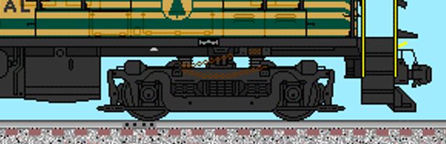

So I dug into it a bit. First, here is a closeup of an RS with AAR Type B trucks. The images are from The Diesel Shop website. They are not guaranteed to be perfectly scale but likely representative:
The trucks have a 9' wheel base. When I look at this, I can't imagine there is room for a truck with a 12'-6" wheelbase. But I would be wrong:
How did they do it? In part by moving the brake equipment from the outside of the wheels to the inside. If you look at the GE Tri-Mount truck in the first photo, you can see that they moved the brakes back to the outside of the wheels.
By the way, the Kemtron Alco Tri-Mount trucks for the RSD-4/5 may be a bit undersized, but you would be forgiven for not thinking so when you look at the model:
They appear to my eye to be well proportioned. As it is, Kemtron made the trucks a bit undersized to allow more clearance to the chassis at each end then the prototype has -- an oft-necessary concession to the realities of modeling, especially give that this model was sold as a kit.
I have been told that Duddy went to CLW for the truck castings, which was why I was encouraged to contact Lou Houlemarde. As to the EMD trucks, I will post a photo of those for comparison to the later GEs.

Jim, I think your eyeball is calibrated to the Kemtron truck, which is undersized and mis-shaped. You might be used to it. The RSD has a three foot longer wheelbase in total than the RS3, and the look is just not captured by the Kemtron RSD at all, to my eye. Even ignoring the rather horrible shape of the longer equaliser, it really doesn't capture the look any more to me under the RSD than under your U25c. It's very undersized.
I don't know that all the RSD5 did not have clasp brakes on the end wheels, but certainly many of the RSD7 through C628 did have full clasps on the same basic castings, though the ears may have moved to accomidate.
I'm not saying the GE truck and the Alco are the same, but they are much closer to each other in reality than you might think looking at the Kemtron vs. Duddy models.
Yes, the axle spacing is purposely to clear the centre traction motor, which would otherwise foul the end axle's motor. The RSC truck has even spacings since the centre axle is unpowered. The RSC3 was trucked that way for very light axle loading lines and I believe was unique to SAL, though a couple roads had the earlier RSC2, also A-1-A but a much different design truck. Given the RSC2 was earlier, I'd bet the return to some permutation of Commonwealth design was for commonality, though maybe more for bolster design, between the later RS3/RSC3/RSD4 range, then it just stuck.
