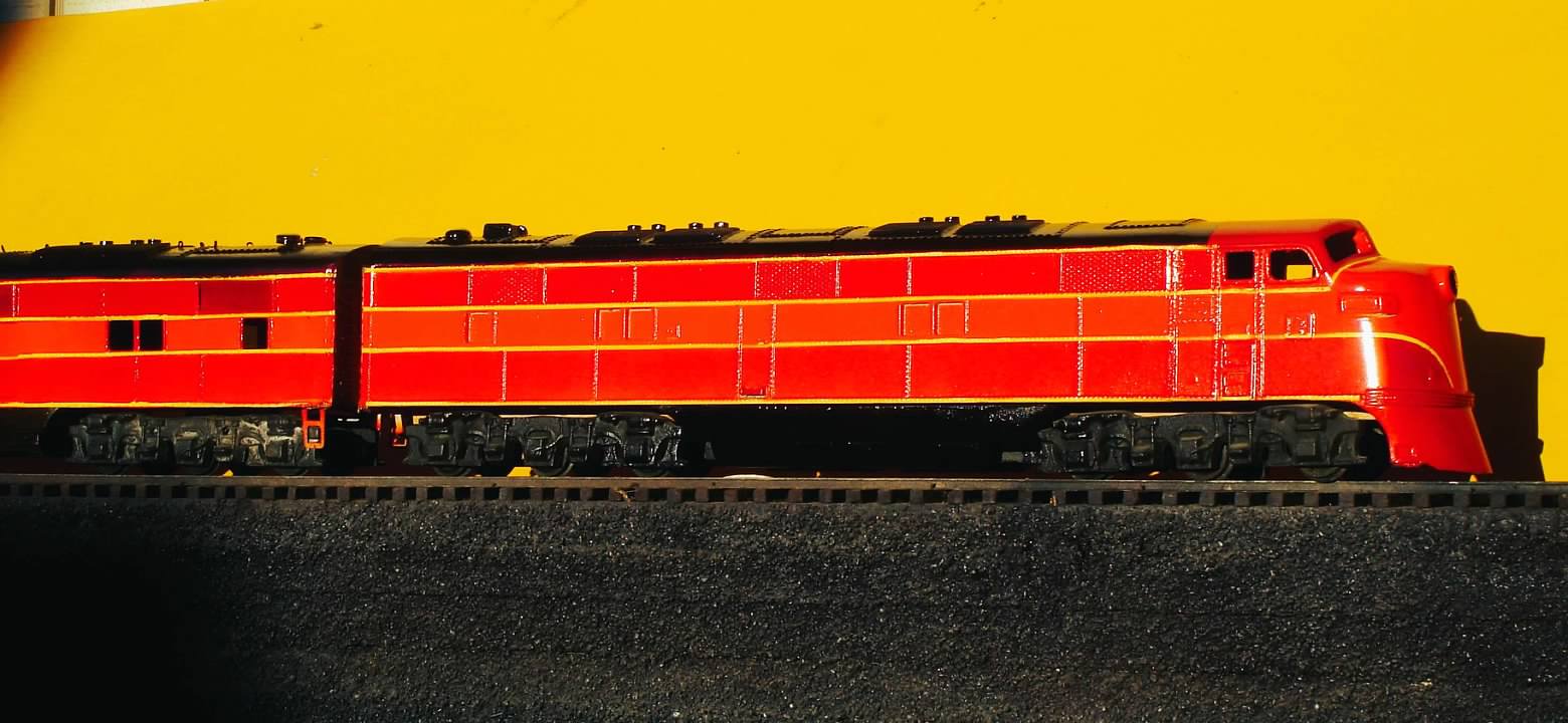

Postby bob turner » Tue Nov 28, 2023 9:43 pm
Well, this is from forever ago - I was looking for an E7 thread. Just made the first attempt at GM & O - not really happy with the stripes, but delerious with the color scheme. I am prepping an all-cast unit for another attempt. I will use better thin masking tape, and align it with a straightedge.

Postby bob turner » Fri Dec 01, 2023 1:49 pm
The all-cast unit is almost ready for striping tape. This time I will use a straightedge. I have done pretty good stripes in the past. Photos next week, maybe.
The tiny spray cans are now $18. That is up from about $2.95 three or four years ago. Almost cheaper to buy it in cans, and thin for the airbrush.

Postby E7 » Fri Dec 01, 2023 4:41 pm
Looks pretty good Bob. All we need is a passenger car with Tibbs getting off, and a little Ray Charles "In the Heat of the Night" background music.

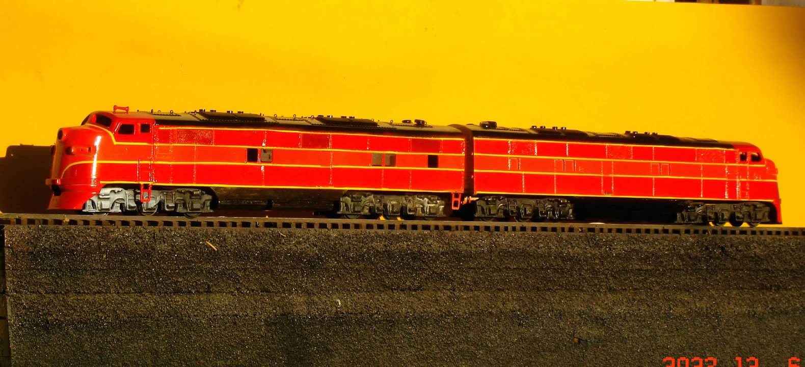

Postby bob turner » Wed Dec 06, 2023 7:29 pm
Reallly tough to capture these colors. I just completed a second unit, with much better stripes. I will be re=doing the front part of the first unit with way better, straighter stripes. I will try again for the colors, but the shot two posts up really did get them -
It is the unit with the black side windows (obviously) that will be getting rework.

Postby De Bruin » Tue Dec 12, 2023 1:26 am
Cool E-units Bob. May want to re-photo these in a different light, looks like you used low sun-light to shoot these which invariably makes reds, oranges and yellow appear "hotter" than they actually are, otherwise they look good to me, and yeah not the easiest scheme to begin with either.
Per your previous post(s) I finally employed a yellow paint-pen to fill in some of the grabs, ladders etc. on that Weaver RF-16 project and was pleased with the results, though I'm reluctant to use one for car body stripes. Do you set up a straight edge to apply the stripes with them? Also, how are you fixed for the decals for these guys?

Postby bob turner » Tue Dec 12, 2023 11:32 am
Jim just sent me a set of decals. He takes good care of me, and hints that maybe we can put all this neat stuff in a GM&O thread.
Yes, using low sunlight. I used to have big spotlights, but got better luck in sunlight. The red is a bright red; the maroon is a Chrysler metallic wine color. It really is striking, although the red could have had a touch of orange. Paint is becoming problematic, with good rattle cans now sixteen bucks for the small size. I may have to go back to Rustoleum, and waste half a can.
Are Pilot pens still available? Yes, I use a straightedge, with a couple layers of masking tape to prevent capillary between the edge and the paint. For yellow, always run a white stripe first.
I have not tried it on the Dupli-Color, but for Scalecoat, you need to bake and wait a week before using the pen. Curved lines are done with old credit cards, cut to the curve, and again use tape for the standoff.

Postby E7 » Wed Dec 13, 2023 1:03 pm
De Bruin wrote:Cool E-units Bob. May want to re-photo these in a different light, looks like you used low sun-light to shoot these which invariably makes reds, oranges and yellow appear "hotter" than they actually are, otherwise they look good to me, and yeah not the easiest scheme to begin with either.
Guessing they do not "pop" like that to the eye. Even the black roofs are intense.
A nice color scheme not often seen.
Really nice job Bob!

Postby bob turner » Fri Dec 15, 2023 1:23 pm
Sorry - it used to be Pilot Pens - for a decade, I guess, it has been these:
https://www.amazon.com/Uchida-America-1 ... j9EALw_wcB
The critical things:
Always let the paint on the basic model dry for a week. A week! Bake it if you can.
Use a straightedge with masking tape underneath, so the paint cannot capillary under the edge. Multiple layers of tape if you are doing rivet strips raised above the car body.
Do the stripe in white first, then overlay with color of your choice - particularly important with yellows. Silver and gold go on pretty good without white underlay.
Mistake? Wipe it off quickly and start over.
The GM&O diesels were done with thin line masking tape over yellow paint. I needed the yellow anyway, under the red. You want red to look good, then it is white, yellow, and red.
And yeah, they "pop" - even the gloss black aids in the popping. The red and maroon are a good contrast, but you would not know it from the photos.
Really pleased with this pair of doorstops. Jim sent decals; they will go on next week, and I will try another photo.
