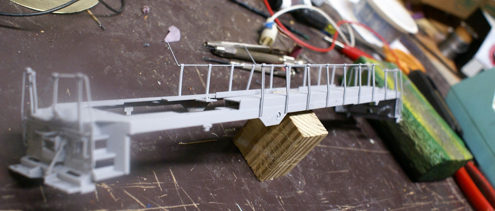

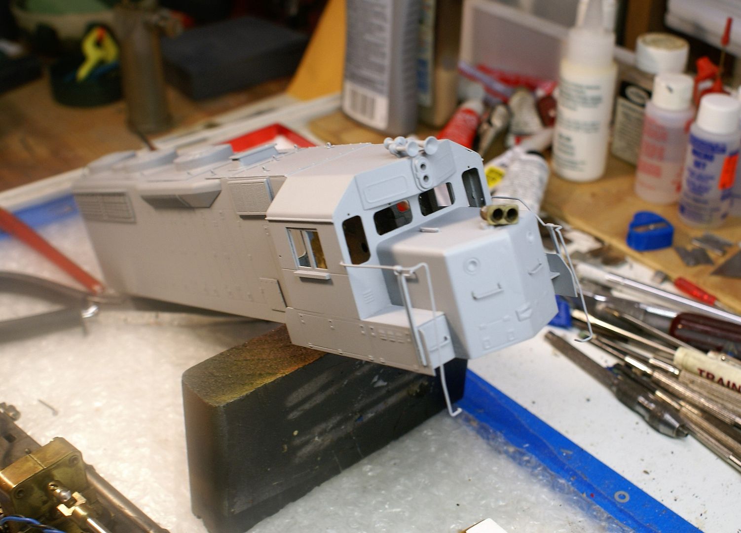

Speaking of anthracite roads.....
Currently cleaning up an in-process paint job for a KTM GP-35 destined for the yellow and green Reading scheme.
Like most if not all KTM’s it’s very sturdy, however after handling/use over the years a lot of the horizontal hand rail stanchions were separated from the frame, most but not all of them though stuck back on with the resistance unit's probe . The end platform stanchions in particular resisted most every effort to re-solder.
The as-built KTM carbody had this nose headlight (very L&N-ish) so that had to go. Wouldn't budge with the resistance probe so I wrapped the nose with a wet towel, applied a brief application of heat from a propane torch and the sconce popped out cleanly. (thinking of sticking it under my pillow)
Some “Bondo”-like two-part stick epoxy and some lengthy successive wet-sanding, then primered (“auto-grade” “Rustoleum Professional” big rattle can) and what you see here is the result.
