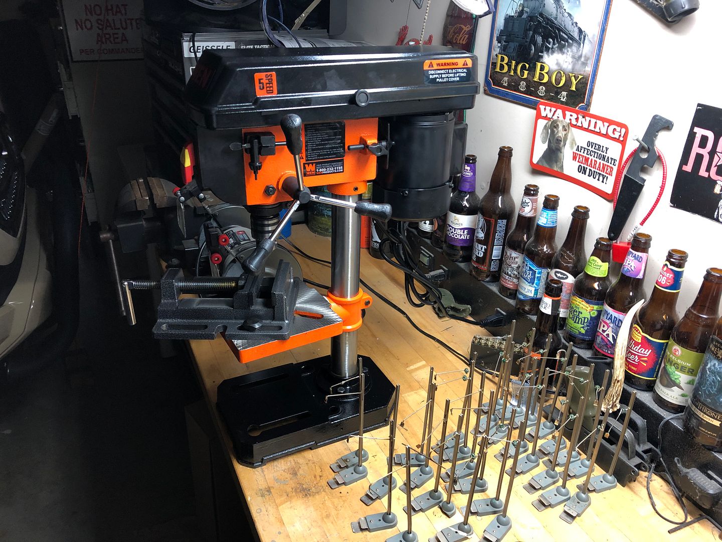

Heavy catenary equipment is in place! :mrgreen:

Hi robert! I’ll pick up a couple bolts along with the wood dowels I’m going to use for the cat bases to secure the press to my bench. Although the press didn’t walk when I tested it, you can bet it will eventually tip over and land on my foot! :mrgreen:

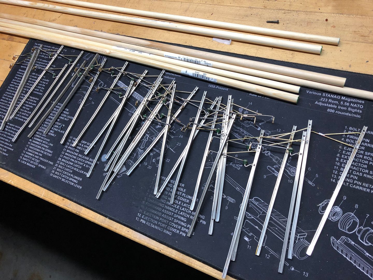

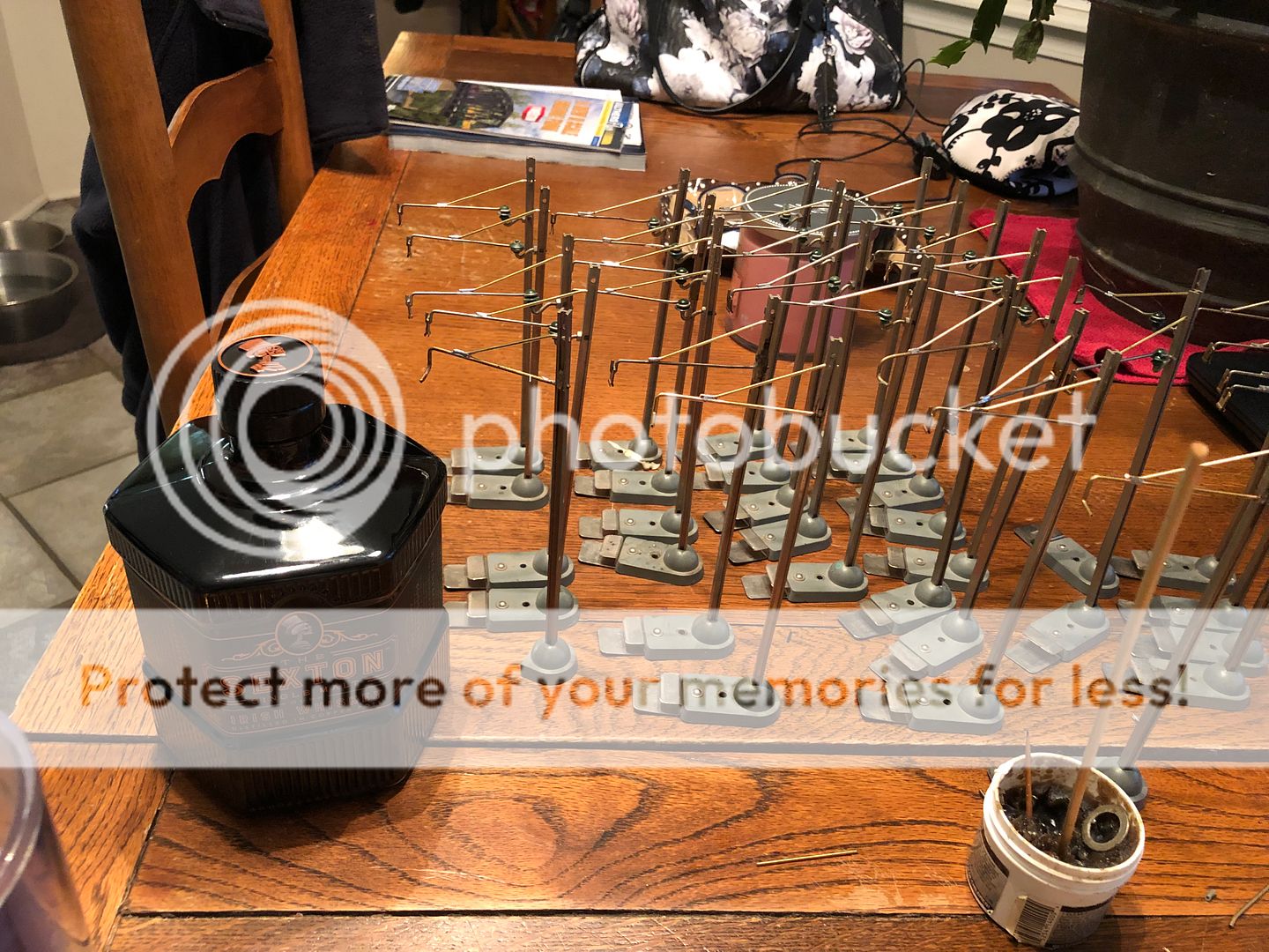

31 support poles have been cut, bent, drilled, and soldered. :D
The bases are next!

The old plastic bases have been knocked off and now I have to wait on the carrier wire to arrive to get the correct height for the new bases.

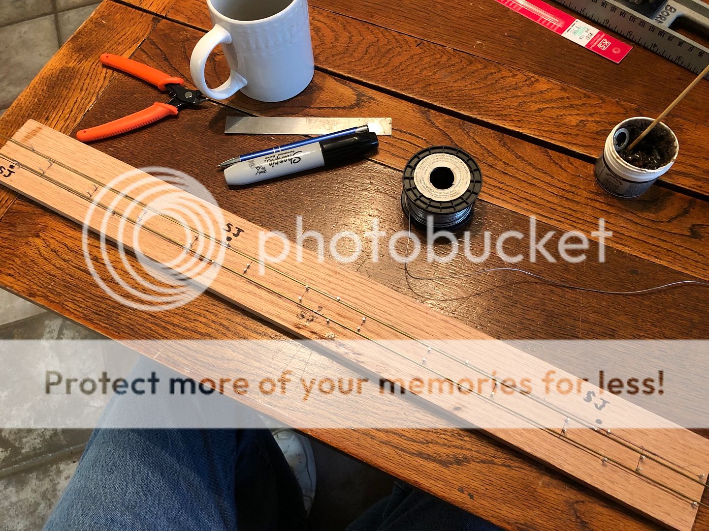

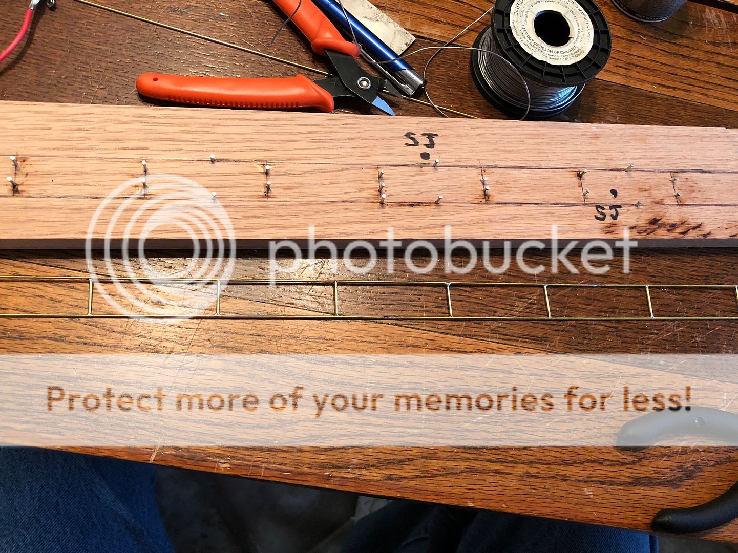

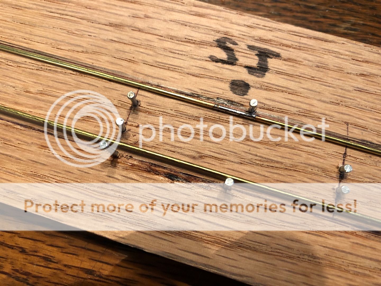

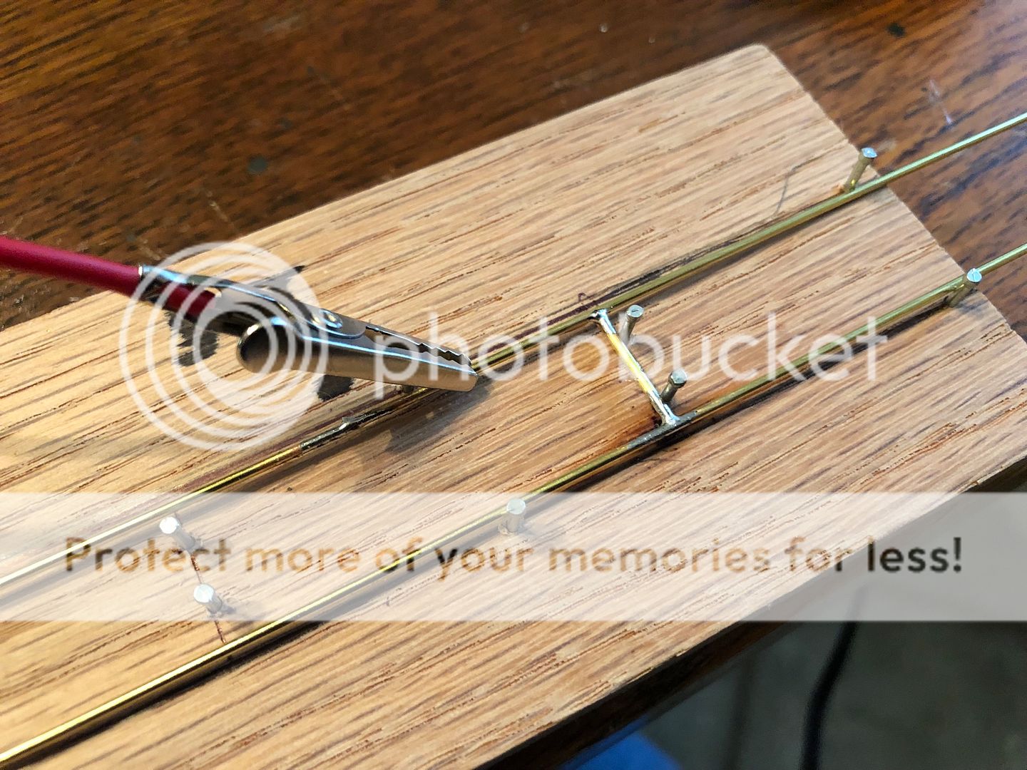

Well, in for a penny in for a pound! I thought I’d experiment soldering up my own support and power line as opposed to buying sections already made up. So here is my soldering jig I made up.
Here’s what I learned, the ends of the wires if fluxed and tinned can be soldered directly together and be curvable without coming apart. But the top and bottom solder splices need to be staggered!!
Also when soldering in the cable spacers(?) be mindful of the location of the cable splices. If to close use a heat sink.
The trial section turned out sturdy and quite flexible.
But even with a jig it’s extremly time consuming!
I’ll post up cost difference next.

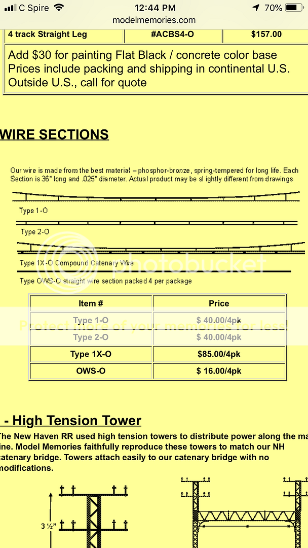

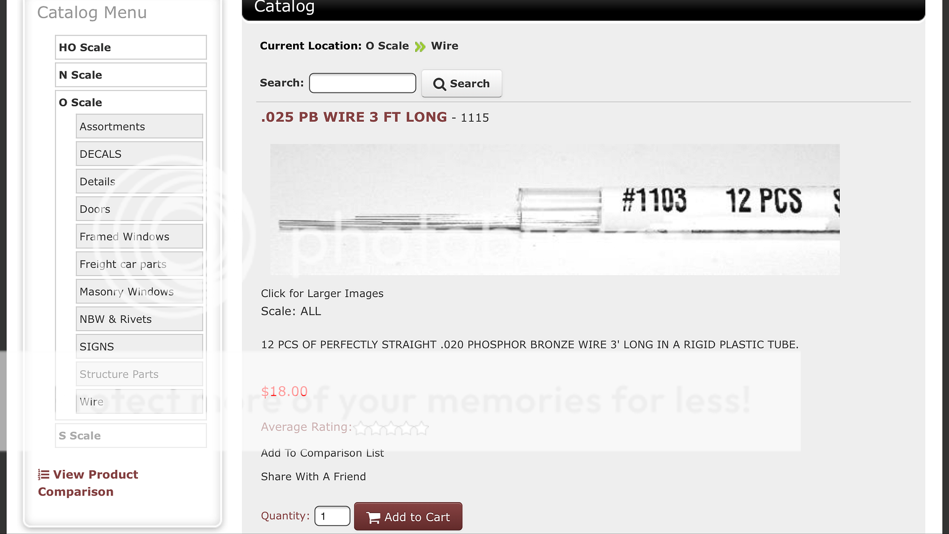

OK, cost estimates! My loop is 40 feet.
Model Memories Type 2-0 pre-made would require 4 packs for a total of $160.
Tichy Train Group PB Wire (requires top and bottom cables and complete soldering on my part: $54.
Decisions, decisions. :mrgreen:
