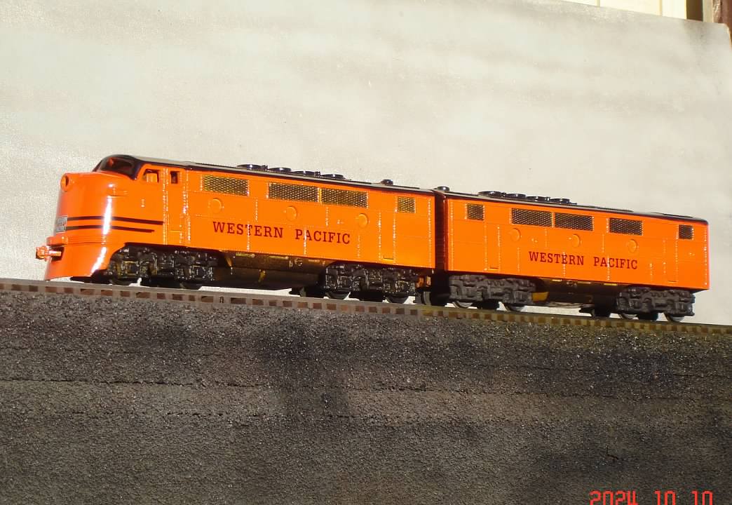

Doorstops from Maroon:

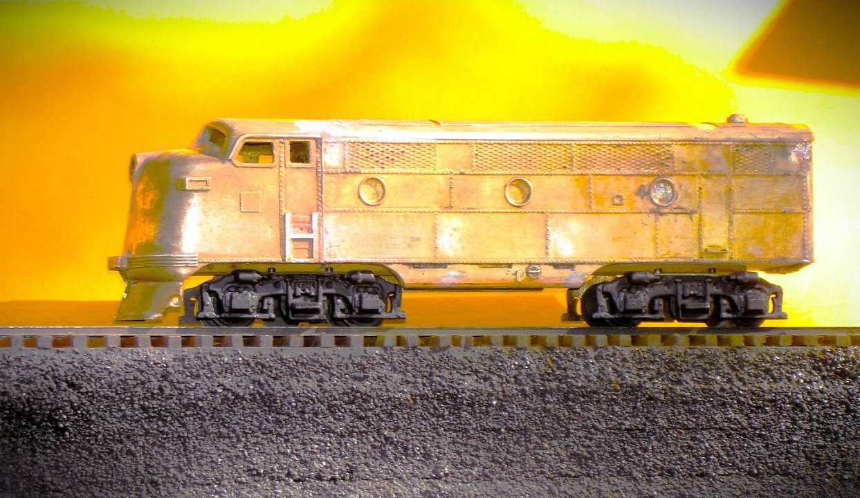

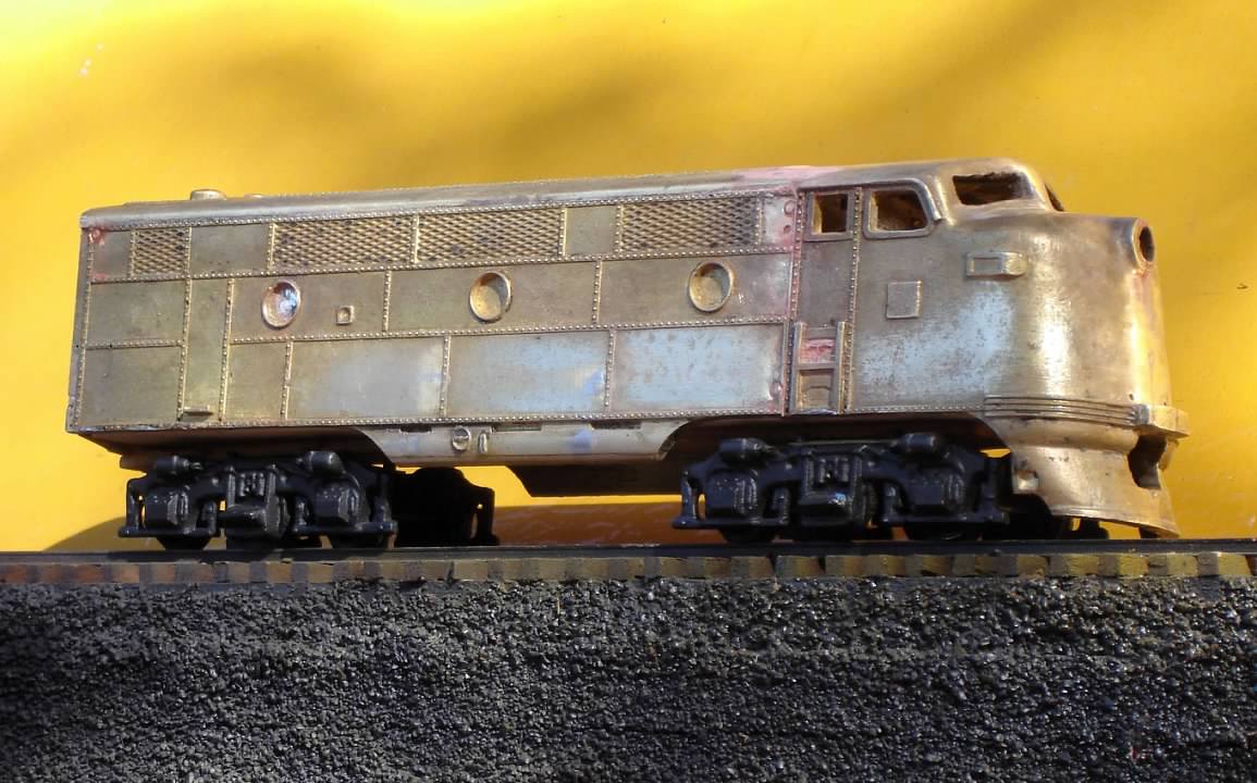

Well, I thought they were at least "different."
Turns out that a lot of this stuff is 17/64 scale. I was thinking these Exacta side frames were a bit small, but they are accurate for 2/4" scale. The ones under the new doorstop FTs are better quality castings, and are 17/64.

Erik saved us from eight day moribundity. I shall bump this in hopes that someone - maybe Erik - will say something unkind about pumpkin F3s.

I like those WP cab units, though I have to ask if the red road name is artistic license, I know the F7's wore a similiar scheme with the larger railroad roman in place of the smaller "Zephyr" font.

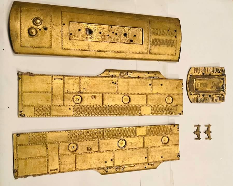

Maroon has sent another doorstop. I fixed one F3A by plugging about a billion holes and relocating the cab, but did not take any before/after photos. I shall rectify that with this unit. The same "modeler" probably did both - nose soldered together quite nicely, but everything else screwed together with random 2-56 and 4-40 screws. Turn some guys loose with a drill press, and you get Swiss Cheese!
Fortunately, these things are salvageable - I will tap each hole, and insert a brass threaded plug, sealing it with a bit of solder, and smoothed with a riffler file (and maybe a Dremel grinder with a Craytex disc).
So here is the before photo - give me until Christmas, and I should have an "after" photo.

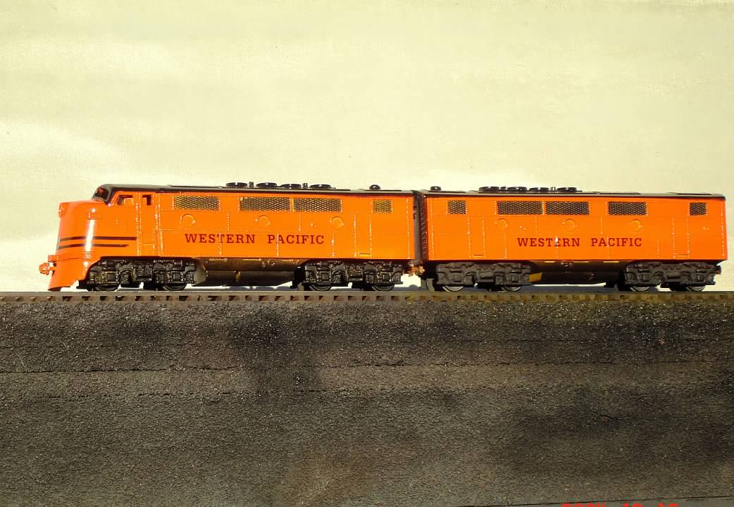

No holes barred:

Yes, I might try to touch that windshield up a bit, but other projects intervene,
I note that either Jim or I have lost the four sand cast rectangular blocks that go in the roof as exhaust fans. This is kinda sad, since our goal is to preserve, not upgrade. Today I am digging in the recycling just to make sure I didn't pitch crumpled paper in there with fan castings hidden.
But - to the five of you who might see this - the castings are strange, but unmistakably F3 fans, so if you happen to see a spare set . . .

That looks great, Bob -- Very nice work getting those holes filled and the shell assembled. These were "state of the art" when introduced in the late 40s, but were not so for long -- the die-cast Atwater-GMC (later All Nation) units were introduced not long after these and that was that. Still, they make respectable models (for doorstop fans, at least), as Bob's WP set several posts back demonstrates. Here is a set in UP colors:
https://dl.dropbox.com/scl/fi/dhc2qp2w1j0nl6lgicc1x/As-Arrived.jpg?rlkey=kp072z0hxvllorozxvw4nbfjw
I post this to show what the fans look like. It's a nice paint job, but unfortunately the fans were not properly placed. The two in the middle should be grouped together, with the exhaust stacks separating them from the front and back fans. Here is the roof an All Nation unit for comparison:
https://dl.dropbox.com/scl/fi/uy2734nckrunklzfxfmcv/20241209_164745.jpg?rlkey=jn8vwk9l2nlq827qfuhxzk76r
One option, if the original fans aren't found, would be to find a damaged All Nation roof and salvage the fan section as a single piece. It seems a long shot, but the roofs do get bent up or broken from time to time.
