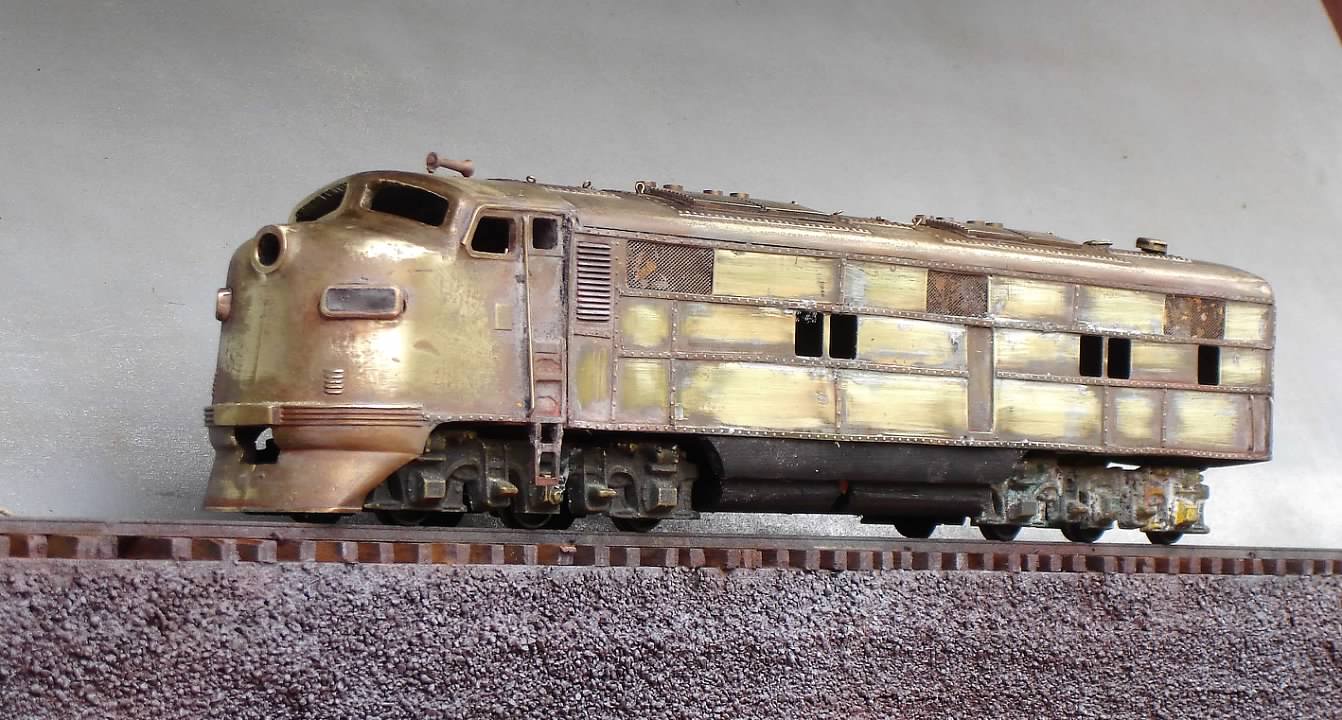

Not quite. My “Semi-doorstop” is half Adams, and the other half credibly done brass sheet with rivet batts. Some of the sand cast details have been replaced with lost wax.
The CLW efforts have never really thrilled me - the rivets are between etched lines. Jan Lorenzen partially cured that by double etching.
But fine - just heavy enough to hold a screen door.
Posts: 13671
Re: Alco PA and FA 2023
Postby bob turner » Thu Nov 16, 2023 8:48 pm
This one. Since the photo, I have added some vertical batts and straightened a few kinks. Not a perfect model, but way better than the typical Adams slab side E6/E7 models out there.

Interesting E unit Bob, is the cab casting from a different manufacturer than the rest of the car body? Arthur Hambrick used to do that; substituting a CLW or A&S F cab for the original casting in order to match a specific road prototype he wanted to model.
Posts: 13671
Postby bob turner » Sat Nov 18, 2023 11:59 am
This one came from Jim. Nose and roof (and probably rear bulkhead and truck sideframes) are Adams. Sides are built up and soldered -rather well, in my opinion. I removed the handrails, added some vertical batts, straightened a few areas on the rivet strips, bead-blasted, and painted it. I am thinking maybe C of G, and repainting the other Adams unit with orange stripes to maybe B & O.
